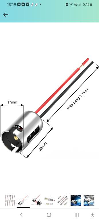

RED-Z06 2,718 #1 Posted December 14, 2021 My C100, i did LED bulbs and i love them but my sockets are..sub par, one the spring is about gone and the bulb makes poor contact with little pressure against it. Can the metal socket and harness be swapped? Share this post Link to post Share on other sites
RED-Z06 2,718 #2 Posted December 14, 2021 Maybe buy something like this..cut the harness and swap the spring and contact? 1 Share this post Link to post Share on other sites

Gregor 4,847 #5 Posted December 14, 2021 (edited) You can nip the wires on your sockets, pull the innards out, and replace with new innards. Springs and all. If your original sockets are decent. While you have the innards out, clean the sockets with a brush. Use dielectric grease after reassembly. Edited December 14, 2021 by Gregor 3 1 1 Share this post Link to post Share on other sites

Achto 31,310 #7 Posted December 14, 2021 6 hours ago, RED-Z06 said: Can the metal socket and harness be swapped? Most any auto parts store should carry the repair part that you need. https://shop.advanceautoparts.com/p/dorman-conduct-tite-electrical-sockets-1-wire-universal-single-contact-85800/5011531-p?c3ch=PLA&c3nid=5011531-P&adtype=pla_with_promotion&product_channel=online&store_code=&gclid=EAIaIQobChMI_LWXn5Pj9AIVArSGCh0UcgojEAQYASABEgI7EPD_BwE&gclsrc=aw.ds 5 Share this post Link to post Share on other sites
squonk 45,809 #8 Posted December 14, 2021 https://www.napaonline.com/en/search?text=LS6226&referer=v2 # LS6226 5 1 Share this post Link to post Share on other sites
