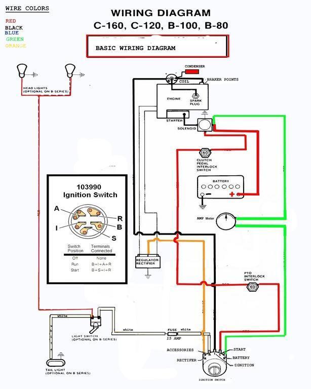

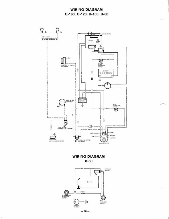

rmaynard 17,409 #35 Posted January 4, 2022 The C-160 has a fuse in the light circuit. The lights should be attached to the accessories tab on the ignition switch. 1 Share this post Link to post Share on other sites
ebinmaine 79,503 #36 Posted January 4, 2022 29 minutes ago, rmaynard said: C-160 has a fuse in the light circuit Thanks for posting that diagram Bob. I've had at least 2 C160s with no fuses anywhere. Most certainly could have been PO "fixed". Now ya got me wondering about the 2 C160 Tecumseh engine tractors here. Neither appears to be modified. I'll check those out sometime... 49 minutes ago, Bob Nakon said: 50 minutes ago, Bob Nakon said: disconnected both wires to the switch Both? Which both? Where did you disconnect? Right at the switch? IMHO it would be in your best interest to seriously consider a full rewire. Share this post Link to post Share on other sites
squonk 47,262 #37 Posted January 4, 2022 No fuse in my C160 either even though the diagram shows one. Light switch has nothing to do with cranking. Ammeter would drop power to the key switch. PTO, clutch pedal switches will cut power to solenoid. 1 Share this post Link to post Share on other sites

rmaynard 17,409 #44 Posted January 5, 2022 The lighting circuit has nothing to do with cranking as Mike said, unless there was a short that drained the battery. For the record, I've had 2 C-120's, and 1 C-160 all parts machines, but all with intact wiring. Each one had a white wire with an in-line Buse fuse holder coming off of the ACC tab on the ignition switch, going to the light switch on the dash. Each one was identically wired so it must have been factory. Just sayin' 1 Share this post Link to post Share on other sites
