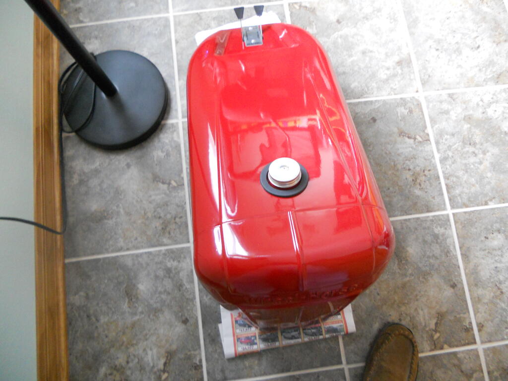

Racinbob 12,765 #3 Posted December 12, 2021 I do pretty much what Steve said. I use JB Weld to hold a small piece of sheet metal under the hood. Then bondo, sand, prime and paint. I like the idea of the support under the hole. This Suburban 400 hood had several holes in it. 4 Share this post Link to post Share on other sites
