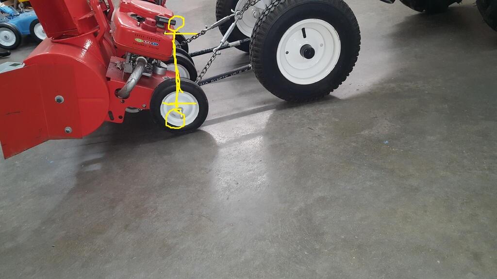

Jeff-C175 7,211 #154 Posted December 18, 2021 8 hours ago, Gregor said: could I turn it? Won't you be scrubbing the wheels on the blowers sideways when you steer? And how much clearance is there between the yellow circled bars and the front tires? Enough to turn the wheel? Share this post Link to post Share on other sites
Snoopy11 5,731 #155 Posted December 18, 2021 4 minutes ago, Jeff-C175 said: Won't you be scrubbing the wheels on the blowers sideways when you steer? And how much clearance is there between the yellow circled bars and the front tires? Enough to turn the wheel? Maybe some caster wheels in order...? Don Share this post Link to post Share on other sites
Gregor 4,848 #156 Posted December 18, 2021 1 minute ago, Jeff-C175 said: Won't you be scrubbing the wheels on the blowers sideways when you steer? That's what I am doing now. I am trying to eliminate that by lifting the entire unit off the ground. 2 minutes ago, Jeff-C175 said: And how much clearance is there between the yellow circled bars and the front tires? Enough to turn the wheel? Yes, there is clearance. It's close, but it clears. The bars can be moved in if I want. 2 Share this post Link to post Share on other sites

Snoopy11 5,731 #158 Posted December 19, 2021 14 minutes ago, Gregor said: That's what I am doing now. I am trying to eliminate that by lifting the entire unit off the ground. I think Jeff's concern is valid, in that, when it is on the ground, and you are blowing snow, the linear relationship of the fixed wheels on the snowblowers not turning with the front wheels of the tractor could create a problem. If the wheels on the blowers could turn with the front wheels of the tractor (i.e. with the overall direction of the tractor), your problem would be solved. Thus, why I mention caster wheels (exemplary mention). Think of it as a zero turn mower. Your front wheels are casters as they need to turn 360 degrees when the hydros command direction. The linear relationship of the front wheels must follow the machine. Anybody want the formula for the above? P.S. that doesn't help you get the system off the ground... BUT, that is another discussion. Don Share this post Link to post Share on other sites

Gregor 4,848 #160 Posted December 19, 2021 (edited) 7 minutes ago, Snoopy11 said: when it is on the ground, and you are blowing snow, the linear relationship of the fixed wheels on the snowblowers not turning with the front wheels of the tractor could create a problem. I understand with the unit on the ground, if I turn, I am scrubbing the wheels. I have some 4" casters, but I have never figured out a good way to mount them. And besides, this sounds like a lot more fun. In my favor though, my driveway is straight. Edited December 19, 2021 by Gregor 1 Share this post Link to post Share on other sites
Jeff-C175 7,211 #161 Posted December 19, 2021 1 minute ago, Gregor said: my driveway is straight. I always have tried to do straight runs with my walk behind simply because it's just too damn hard to turn, scrubbing the front 'feet' sideways... more so probably the fact that there's no differential, just a solid axle. You can pull a pin on one of the wheels to unlock it to one wheel drive, but then it doesn't have enough traction except in VERY light snow. 1 Share this post Link to post Share on other sites
Snoopy11 5,731 #162 Posted December 19, 2021 If you took the OEM wheels off, and put a piece of steel across the 2 blowers... extending past the ends of the blowers... maybe 6 inches... you could do something like this (Pardon my horrible art drawing skills...) Don Share this post Link to post Share on other sites
Gregor 4,848 #163 Posted December 19, 2021 30 minutes ago, Snoopy11 said: If you took the OEM wheels off, and put a piece of steel across the 2 blowers... extending past the ends of the blowers... maybe 6 inches... you could do something like this I am not sure what all that would entail, but, these are 1964 Model #1819 Lawn Boy Snowblowers, and somewhat rare. I am reluctant to weld on them, drill holes, or anything else that would permanently deface them. So far, everything I have done to them can be un-done, relatively easy. Share this post Link to post Share on other sites

Gregor 4,848 #166 Posted December 19, 2021 Sorry if I have sort-a hijacked your thread @Jeff-C175 but it does all pertain to the same thing. Laying in bed last night I got to thinking yet again. I hate that. If I am successful in lifting this entire unit off the ground, it's just possible I may be able to eliminate the wheels completely. If not eliminate them, I may be able to raise them off the ground when the blowers are down on theirs skids. Either way, that would cure any scrubbing problem. 2 Share this post Link to post Share on other sites
ebinmaine 80,765 #167 Posted December 19, 2021 54 minutes ago, Gregor said: it's just possible I may be able to eliminate the wheels completely If you have a hard surface driveway eliminating the wheels would be fine. On a gravel surface I'd leave them on as a guard against digging in too much. Share this post Link to post Share on other sites
Gregor 4,848 #168 Posted December 19, 2021 3 minutes ago, ebinmaine said: f you have a hard surface driveway eliminating the wheels would be fine. Concrete 1 Share this post Link to post Share on other sites
