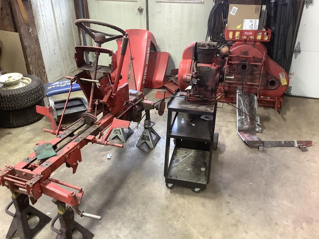

41chevy 74 #1 Posted December 8, 2021 I’ve read everything I could fine about painting on here. When I get my frame washed down, scraped, cleaned and ready, I see where most people use etching primer, from a spray can. I plan on buying oil base I H red along with reducer and hardner. Am I right in assuming you paint red right on top of it since it says you don’t sand etching primer and it would be next to impossible to sand the frame anyway? Next question on the sheet metal would I spray it with etching primer then regular primer after the etching drys? I’d planned on blocking the sheet metal and you can’t block etching. 2 Share this post Link to post Share on other sites
