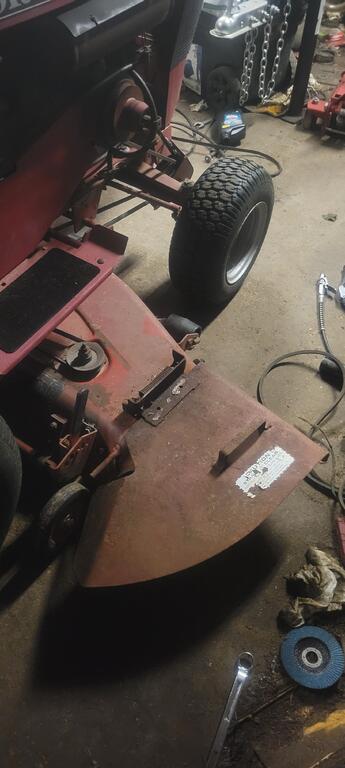

RED-Z06 2,699 #1 Posted December 8, 2021 Discharge chute? Doesn't fit my SD42... Share this post Link to post Share on other sites

RED-Z06 2,699 #3 Posted December 8, 2021 I cant find any pictures of any wh deck with a handle on it or a single spring hinge. D series looks close on shape Share this post Link to post Share on other sites

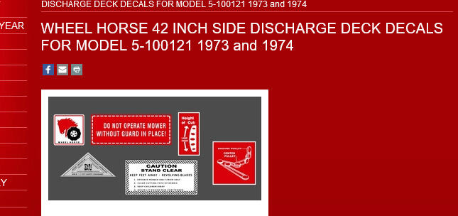

Gregor 4,847 #4 Posted December 8, 2021 Here is a pic from redoyourhorse. Looks like it has the same CAUTION decal as your deck Share this post Link to post Share on other sites
RED-Z06 2,699 #5 Posted December 8, 2021 7 minutes ago, Gregor said: Here is a pic from redoyourhorse. Looks like it has the same CAUTION decal as your deck Definitely...i just dont see how it would fit up to my deck, which has the correct fixed position flap on it. Share this post Link to post Share on other sites
Gregor 4,847 #6 Posted December 8, 2021 3 hours ago, RED-Z06 said: Discharge chute? Doesn't fit my SD42... Just going by my Massey chutes, that chute has the bracket on it that belongs on a deck. Share this post Link to post Share on other sites
RED-Z06 2,699 #7 Posted December 13, 2021 Fits an SD42 if you drilp 2 holes on the right spot Share this post Link to post Share on other sites
