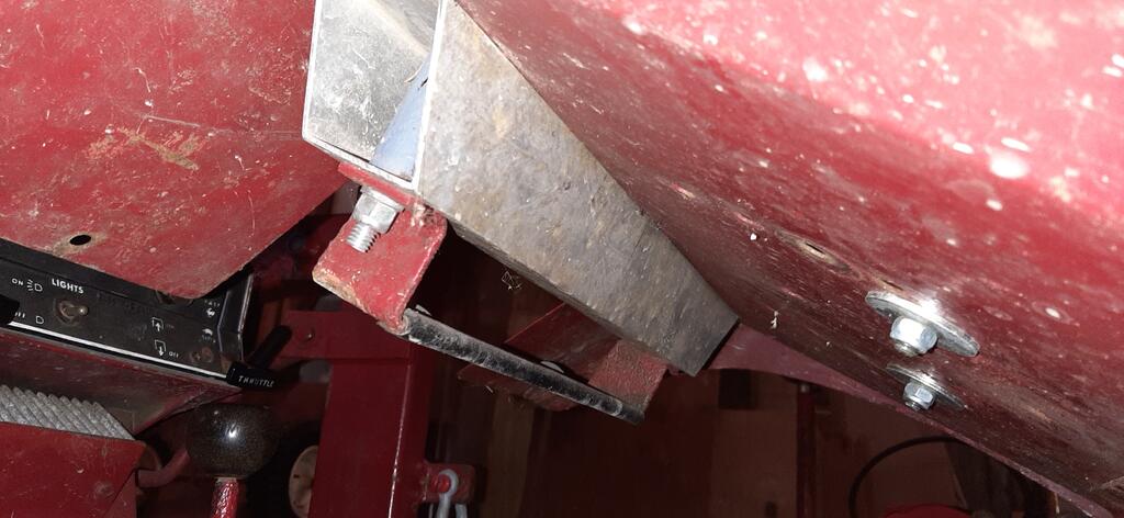

ebinmaine 77,323 #1 Posted December 8, 2021 What have you done to your own tractor or seen on someone else's that makes it more user friendly for a larger sized person? On my Cinnamon Horse 1974 C160-8 and my 1975 C160 Automatic I have the seats moved back about two or three inches past where they will go as set up stock. I don't like using seat springs so I remove them and replace with 1.5 inch square multi hole structural steel. What all have you all done did? 3 Share this post Link to post Share on other sites

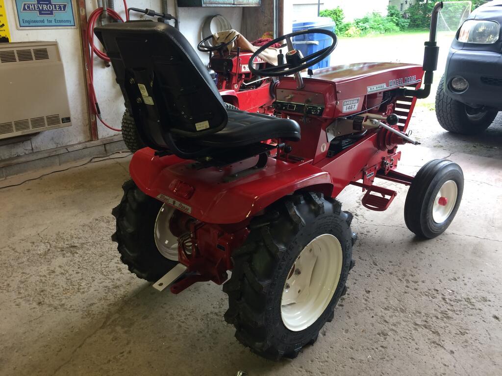

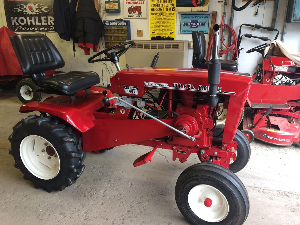

squonk 45,500 #3 Posted December 8, 2021 Don't like springs? I hate sitting on the fender pan and getting the thighs pinched between the seat pan and the fender! I raised the seat on the 1467 which also gave me more leg room and and lengthened the steering shaft to get the wheel higher. 5 2 Share this post Link to post Share on other sites

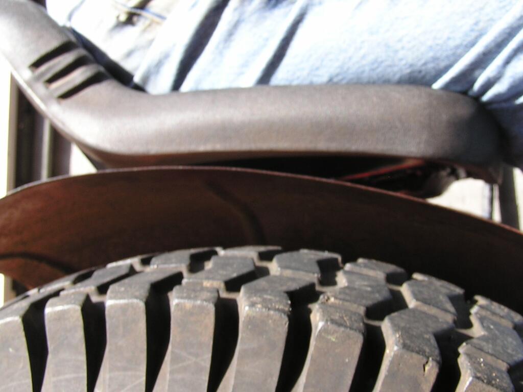

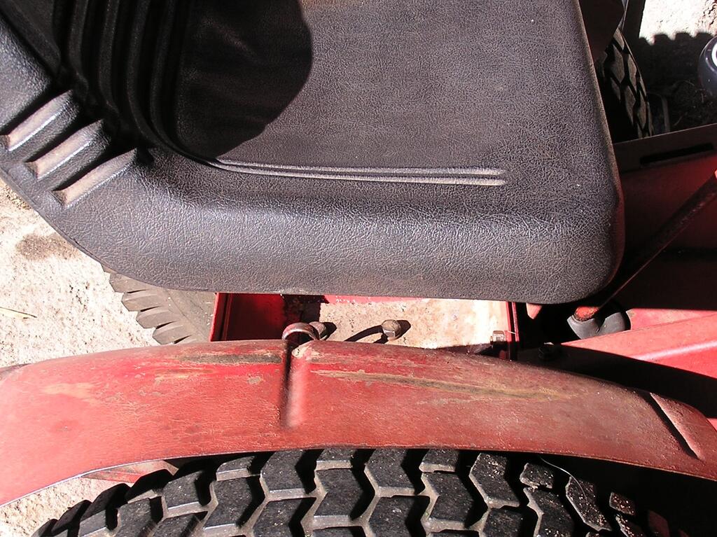

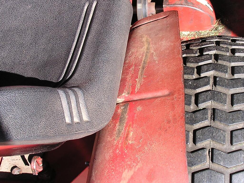

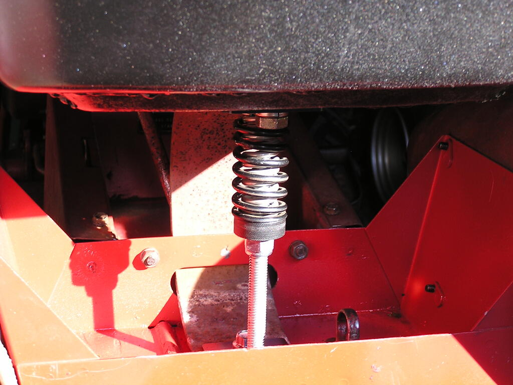

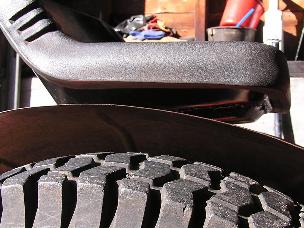

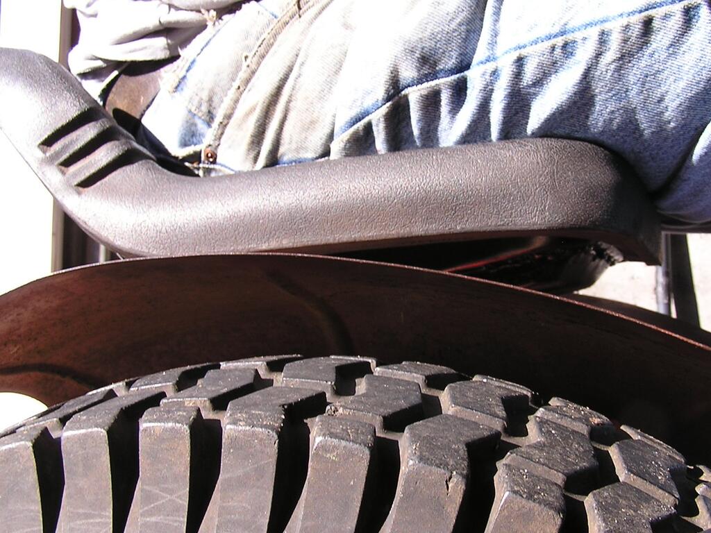

ri702bill 11,254 #4 Posted December 8, 2021 I added this adjustable Helper Spring setup to the 854 8 speed. All of my Round Hoods have the same issue - the seat touches the rear fenders and abrades the paint away using the C shaped seat mount - OK for non-restored Working Girls, but would definetly be an issue with a complete repaint. Just using the inner spring leaves about 3/4" clearance for my 250 ish pound self. With the black outer and the inner, it raises it to about an inch clearance. All bolt in and removable. I could have used a spacer block to raise the seat but chose not to - my knees would be up against the backside of the steering wheel. Added bonus - the lower mount clears the 8 speed dipstick tube just fine. Bill 4 1 Share this post Link to post Share on other sites

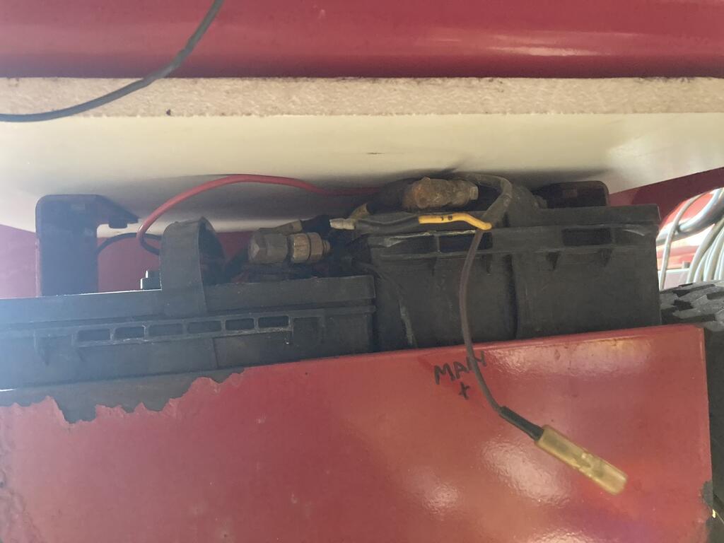

SylvanLakeWH 30,585 #16 Posted December 8, 2021 (edited) Unintended benefit of adding 2 layers of 1/2” pvc board under my E 141 seat to provide a platform in lieu of missing seat brackets: way more comfortable seating… 1” higher made a big difference … sandwich top and bottom of seat pan… Edited December 8, 2021 by SylvanLakeWH 4 Share this post Link to post Share on other sites
