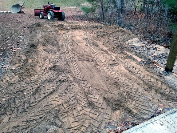

PetesPonies1 117 #1 Posted December 7, 2021 The answer is . .YES! You can't tell, but the ground was unbothered. I cut between 4 and 6 inches off in a short time. I was wondering if I could actually get the ground engaged enough to cut in, not just move dirt around from a pile, etc. The little boy did well; 877. I do wish the blade height was more easily adjusted, rather than up or down. Of course down is adjusted with the knob. . . but if you've done this, you know what I mean. I'm adjusting the knob as much as I am moving forward and backwards :) But over all, no complaints. I'm building a tractor shed to house the toys. 1 6 Share this post Link to post Share on other sites
wallfish 18,060 #2 Posted December 7, 2021 Tilting the blade back will give it more dig, tilting the blade forward will give it more skid/push without digging in. Blade tilt adjustment is the holes on the back of the blade for the trip springs 10 Share this post Link to post Share on other sites

CCW 1,376 #6 Posted December 8, 2021 Did the same work on my yard to level topsoil and remove a bed of pachysandra. Saved my back from much turmoil. Well done. 1 Share this post Link to post Share on other sites
Pullstart 66,609 #7 Posted December 8, 2021 Was there a good root system of grass here, or loose/sandy loam? We have enough clay in the soil, once the grass breaks loose it gets slimy. Share this post Link to post Share on other sites

PetesPonies1 117 #9 Posted December 8, 2021 2 hours ago, Pullstart said: Was there a good root system of grass here, or loose/sandy loam? We have enough clay in the soil, once the grass breaks loose it gets slimy. Once I break through the grass/roots, it's sandy. Roots from nearby trees were messing with me, but the soil is easy to dig once you're down a couple inches. 1 Share this post Link to post Share on other sites
