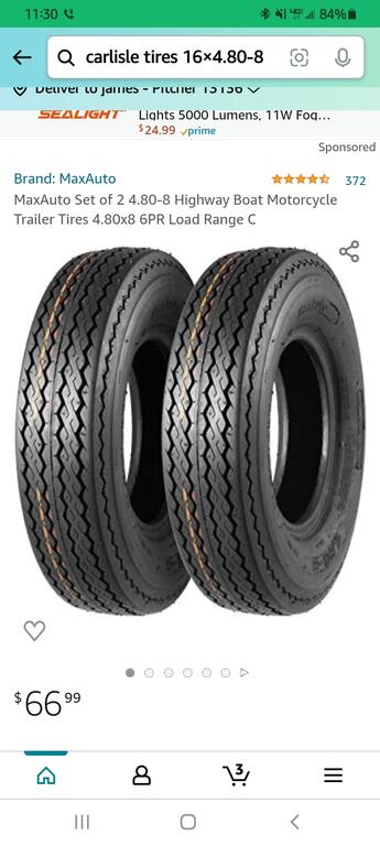

jtrosp1980 89 #1 Posted December 7, 2021 Does anyone know if these tires would fit a raider 10 on the front tires Share this post Link to post Share on other sites
Maxwell-8 4,370 #2 Posted December 7, 2021 (edited) First off a 6pl rating is quite high, and will cause a bumpy ride second off, I think they are to small for the 5" wide rim Correction: they are to narrow for your rim I would at least go 5.5 or 6 wide not 4.80 stock was 5.5 as stated by tractordata, on mine, they were 6.5 Edited December 7, 2021 by Maxwell-8 Share this post Link to post Share on other sites
jtrosp1980 89 #3 Posted December 7, 2021 (edited) What is the size I should be looking for and rating 🤔 Edited December 7, 2021 by jtrosp1980 Share this post Link to post Share on other sites
Maxwell-8 4,370 #4 Posted December 7, 2021 1 minute ago, jtrosp1980 said: What is the size I should be looking for -16x5.5-8 -16x6-8 -16x6.5-8 are all solid options Share this post Link to post Share on other sites

Maxwell-8 4,370 #10 Posted December 7, 2021 I have 16x6.5-8 on mine. the rims are 5" wide, so you can't go below that. Probably other members have an different input, so let's wait for them to join. Share this post Link to post Share on other sites

Lee1977 7,461 #17 Posted December 8, 2021 (edited) 8 hours ago, jtrosp1980 said: What is the size I should be looking for and rating 🤔 Those 6 plys will steer a lot easer and you won't notice much difference in the ride.if any. I have 6 ply 16x 6.50x 8 on my C-120/180 I would never put less then 4 plys on any of my Wheel Horses. Did I say I hate 2 ply tires. The 6 plys will roll right over things that will cause the 2 plys to fold up. Edited December 8, 2021 by Lee1977 1 Share this post Link to post Share on other sites

Maxwell-8 4,370 #23 Posted December 8, 2021 We are getting a bit finnicky maybe. I would just go for a 16x6.50-8 that you feel comfortable with. Higher ply's tend to be a bit more expensive. 1 hour ago, jtrosp1980 said: What I would like to do is stay with the original but trying to find them not dry rotten and cracked has been a nightmare I'm at the point of giving up and get something 1 Share this post Link to post Share on other sites
