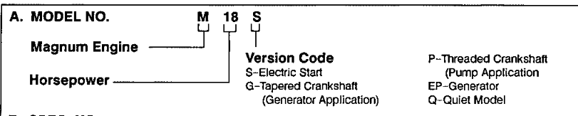

8ntruck 8,344 #2 Posted December 7, 2021 Not sure on the current price. If you can get the spec number for that engine, it will lead you to what the build options are. Should reveal things like output shaft diameter and length, the presence of a thrust bearing on the crank, type of ignition, alternator output, etc. 2 Share this post Link to post Share on other sites

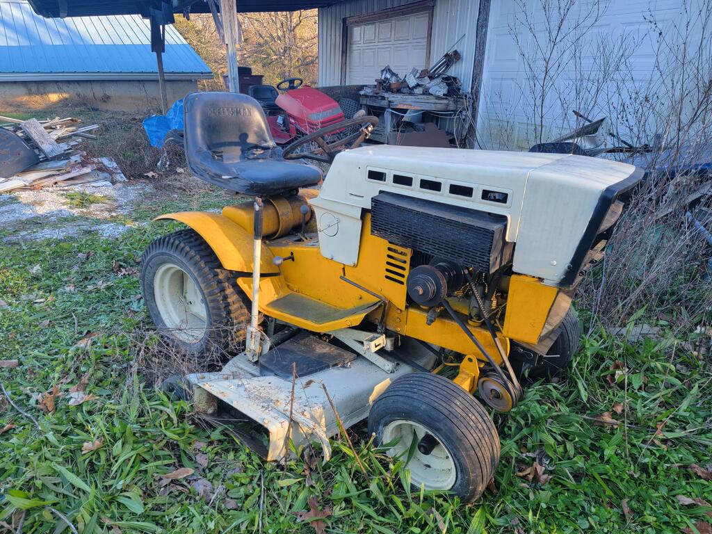

Fredo 56 #10 Posted December 7, 2021 50 minutes ago, WHX?? said: What are your plans for it... in a working horse or something else. The stub crank could be a deal breaker or possibly a Building a mud mower out of a commando 6. Just trying figure if i should get the magnum 16 or if a 1974 sears ss16 with the onan 16hp(same price same guy, except the onan is non running, gas problems) would be a better option for a mud mower. Have heard it can get expensive to fix these onan motors. Share this post Link to post Share on other sites

kpinnc 16,199 #12 Posted December 7, 2021 For a mud mower, the stub shaft won't be an issue. But 16hp on one is overkill when linked to these WH transmissions, and probably the only difference between it and a K241 would be that you'll have half the range for given fuel capacity. 2 Share this post Link to post Share on other sites

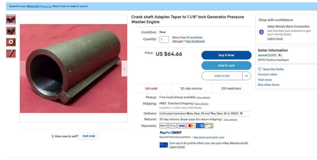

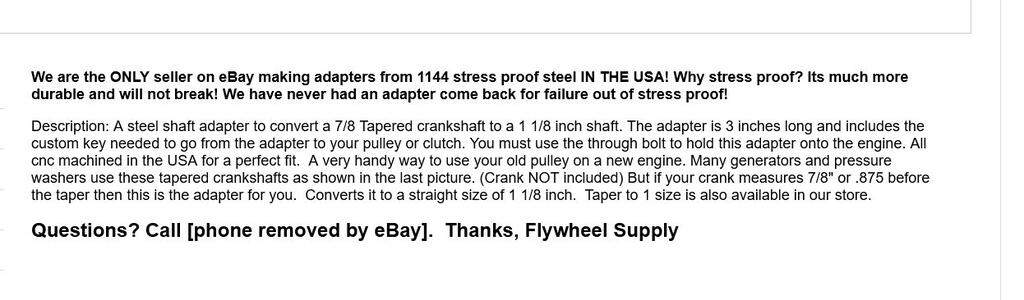

pfrederi 19,271 #15 Posted December 7, 2021 (edited) Stubby crank likely sign it was for a generator. Probably tapered also. I have seen adapters on EBAY to make it a straight shaft. If it is a twin M16 generator engine it will not have a thrust bearing... but if you are not using a PTO that is not an issue. The Magnum Twins have a full pressure lubrication system which would be better for your off roading than a splash system Edited December 7, 2021 by pfrederi 1 Share this post Link to post Share on other sites
clueless 3,331 #16 Posted December 7, 2021 1 hour ago, pfrederi said: Stubby crank likely sign it was for a generator. Probably tapered also. I have seen adapters on EBAY to make it a straight shaft. If it is a generator engine it will not have a thrust bearing... but if you are not using a PTO that is not an issue. The Magnum Twins have a full pressure lubrication system which would be better for your off roading than a splash system Stub crank and possible tapered ain't gonna work unless you change the crank shaft. Share this post Link to post Share on other sites
pfrederi 19,271 #17 Posted December 7, 2021 9 minutes ago, clueless said: Stub crank and possible tapered ain't gonna work unless you change the crank shaft. I have not personally tried one of these but they have sold a bunch.... 1 Share this post Link to post Share on other sites

pfrederi 19,271 #23 Posted December 8, 2021 Without a spec number this is a lot of speculation Share this post Link to post Share on other sites
