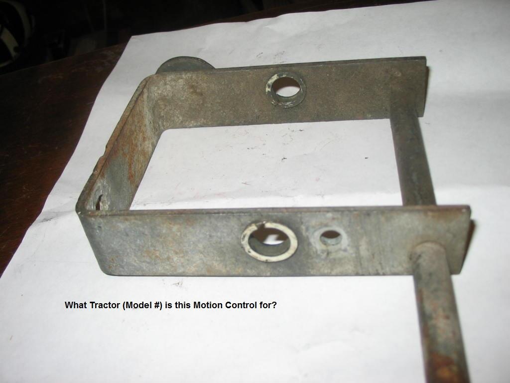

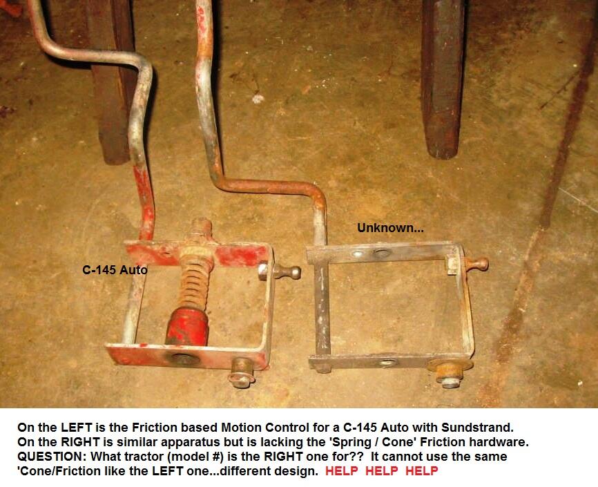

daveoman1966 3,880 #1 Posted December 6, 2021 Here are two Motion Control levers. One is from a C-145 Auto (Sundstrand) but I can't identify the other one. I need to know what Tractor...by model number it is for. If anyone has pics of a COMPLETE Motion Control Assy for it, that'd help loads. HELP... Share this post Link to post Share on other sites

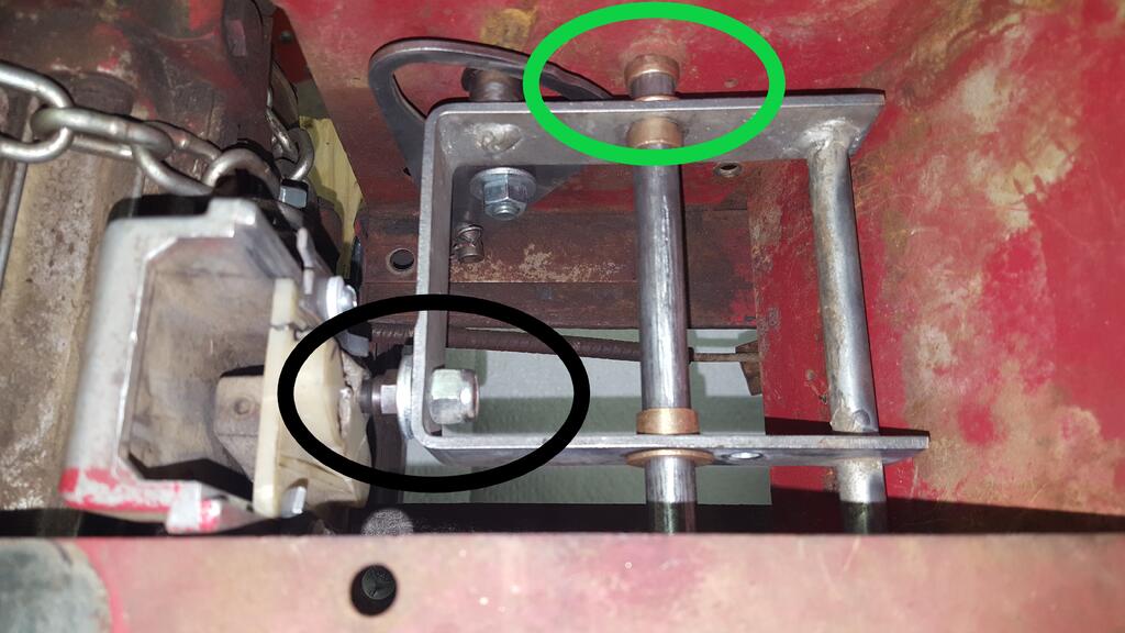

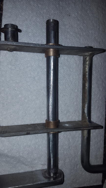

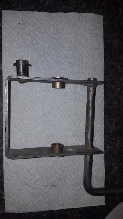

Gregor 4,847 #2 Posted December 6, 2021 (edited) This is from my 876. Might help, might not. I drilled out the holes and replaced the plastic bushings with flanged oil lite bearings. My 876 does not have any spring, cone or friction apparatus. Edited December 6, 2021 by Gregor 1 Share this post Link to post Share on other sites

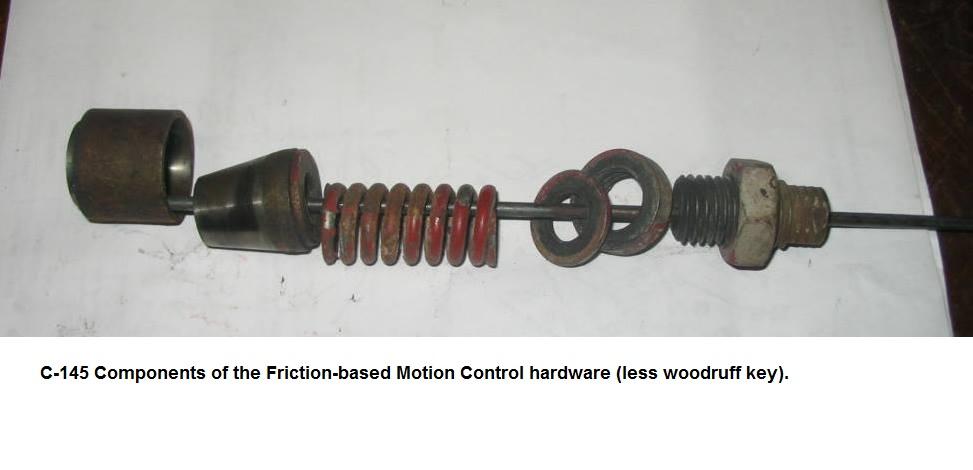

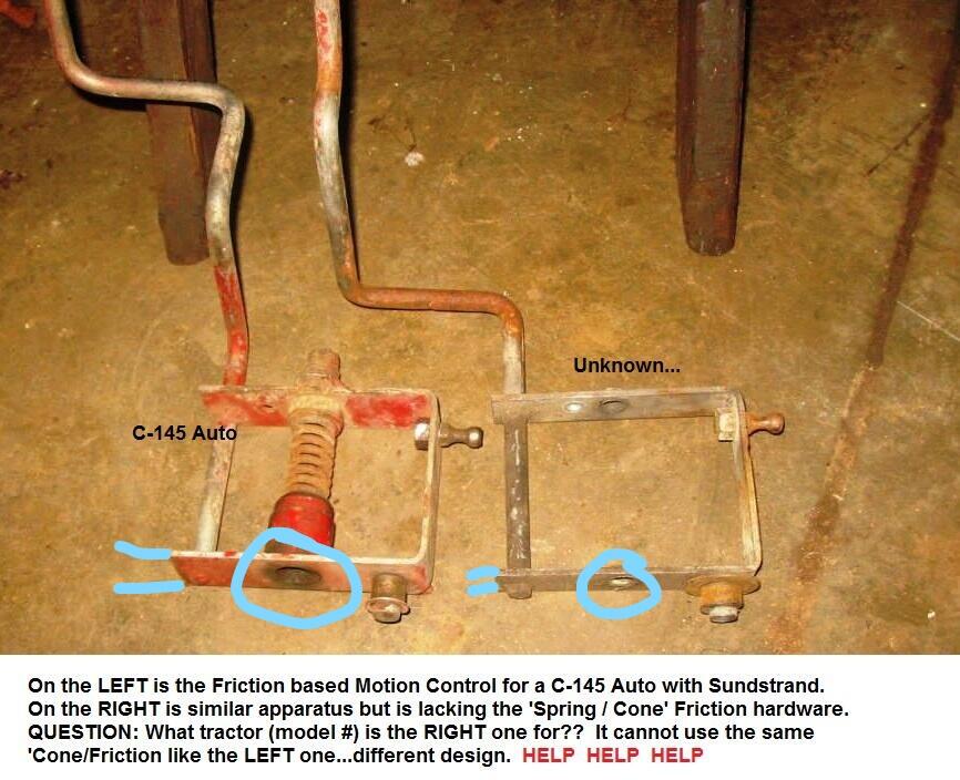

Achto 30,050 #3 Posted December 7, 2021 (edited) 12 hours ago, daveoman1966 said: Early model Sundstrands used the one on the right. Say '65 - "67 for sure, these models relied on tension straps on the plastic slide for friction to hold the control handle. Later models, '70 and up used that spring shaft to provide friction on the control handle. So the one on the right - 875, 1075, 876, 1076, 1276, 877, 1077,1277 The one on the left, Chargers, Electros, Broncos, Cxx1 series (C101 etc,) Cxx5 series (C105 etc) Edited December 7, 2021 by Achto 3 Share this post Link to post Share on other sites
daveoman1966 3,880 #4 Posted December 7, 2021 Thanx...now I know what to look for. 3 hours ago, Achto said: Early model Sundstrands used the one on the right. Say '65 - "67 for sure, these models relied on tension straps on the plastic slide for friction to hold the control handle. Later models, '70 and up used that spring shaft to provide friction on the control handle. So the one on the right - 875, 1075, 876, 1076, 1276, 877, 1077,1277 The one on the right, Chargers, Electros, Broncos, Cxx1 series (C101 etc,) Cxx5 series (C105 etc) I'll go with the 875 thru 1277. I know the Bronco 14 is different cause I have a Bronco 14....it uses the friction collar parts. 1 Share this post Link to post Share on other sites
pfrederi 19,089 #5 Posted December 7, 2021 The u-shaped bracket on the older Wheelamatics is not as tall as the later ones. I had looked at trying to put the later friction spring set up in my friends 1075. Problem was you have make bigger hole for the D shaped hole needed for the friction type...not enough metal to do it. The handle shape from the newer ones won't fit into a1075 so you can't just swap the whole thing. Guess you could cut the handle off an old one and weld it to a new one but I haven't tried that... 2 Share this post Link to post Share on other sites
