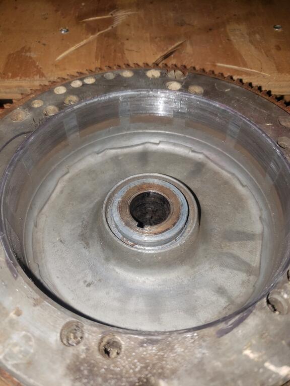

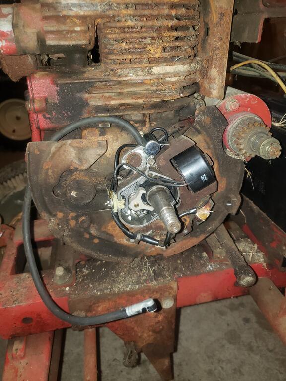

mason_811 24 #1 Posted December 6, 2021 Working on an HH60 from a commando 6. Put new ignition components in the magneto housing. When I put the flywheel on, it binds. My research has been showing that the placement of the magneto doesn't matter. I've tried adjusting it for hours, can't get it to fit. Binding against the armatures. What should I do (other than buy a new engine, I would like to see this one run again) 2 Share this post Link to post Share on other sites
pfrederi 19,881 #2 Posted December 6, 2021 Is the inside of the flywheel clean, any loose magnets?? 3 Share this post Link to post Share on other sites
ebinmaine 77,341 #3 Posted December 6, 2021 @Gregor You've messed with these too. Any thoughts? 1 Share this post Link to post Share on other sites
mason_811 24 #4 Posted December 6, 2021 Inside of flywheel. Just lots of wear marks from me coloring things with sharpie to see exactly what rubs 1 Share this post Link to post Share on other sites
16 Automatic 53 #5 Posted December 6, 2021 Is that keyway key too tall and pushing the flywheel off center? All the scratches look like the opposite the keyway slot. Just a thought. 1 Share this post Link to post Share on other sites
Gregor 4,847 #6 Posted December 6, 2021 (edited) I remember it well. The Techuseh Tale. I had the same problem with an H70. Rust, corrosion, etc. expands metal. In the end, I took my small side grinder with a flap disc, and "carefully" sanded down the protruding parts of the magneto assembly. We are only talking thousandths of an inch here. There is no forward or backward adjustment of the magneto assembly. All you can do is rotate it to adjust timing. I didn't do mine any harm, I don't believe you will hurt yours either. Mine runs very well. Although it is no longer red. 20201223_071152.mp4 Where are my manners? to Edited December 6, 2021 by Gregor 3 Share this post Link to post Share on other sites
RED-Z06 2,716 #7 Posted December 6, 2021 Although intended for timing, loosening the ignition bolts can give a very slight amount of in and out movement. The trick is timing. I take the head off, flywheel off, put a dime on the piston, run it down the hole, remove head gasket and put the head back on..run the piston back up (in the operating direction) until it stops. Then put a continuity tester on both sides of the points and rotate the base until the points (prior already gapped at .020") just open..then tap the base back just until they close...and snug the bolts. Remove dime...assemble. 3 Share this post Link to post Share on other sites
mason_811 24 #8 Posted December 6, 2021 7 minutes ago, RED-Z06 said: Although intended for timing, loosening the ignition bolts can give a very slight amount of in and out movement. The trick is timing. I take the head off, flywheel off, put a dime on the piston, run it down the hole, remove head gasket and put the head back on..run the piston back up (in the operating direction) until it stops. Then put a continuity tester on both sides of the points and rotate the base until the points (prior already gapped at .020") just open..then tap the base back just until they close...and snug the bolts. Remove dime...assemble. Thanks for the tip. That's easier than finding out which one of my buddies garage my dial gauge is in. I'll be tackling the timing once I get some fire to happen. 1 Share this post Link to post Share on other sites
RED-Z06 2,716 #9 Posted December 7, 2021 2 hours ago, mason_811 said: Thanks for the tip. That's easier than finding out which one of my buddies garage my dial gauge is in. I'll be tackling the timing once I get some fire to happen. Where i used to work i had an HH70 on an ariens tillers that came in in a box, i put on the new coil, points, condenser, but it just wouldn't go...and when it did, it ran badly. Old boss came out..showed me that trick and in 20 minutes he had the thing purring like new. 1 Share this post Link to post Share on other sites

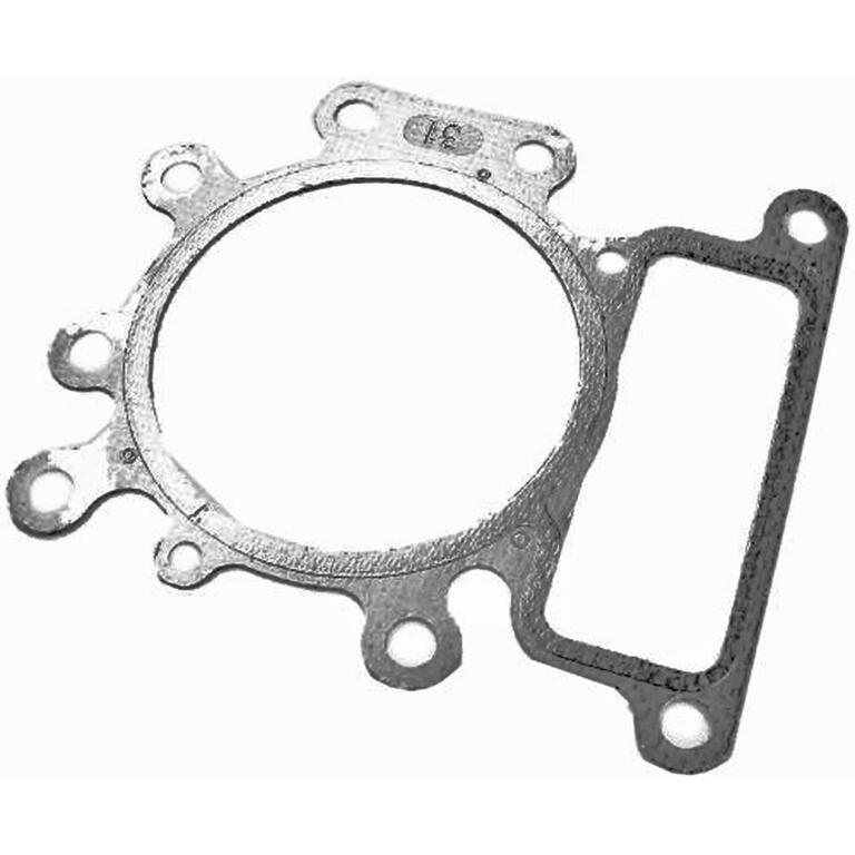

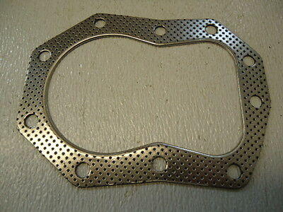

RED-Z06 2,716 #17 Posted December 7, 2021 3 hours ago, mason_811 said: Hmm, that's news to me. I'm used to mostly modern and solid state engines. I worked at a toro/wright/cub/stihl dealer for 4 years. Saw a good share of old equipment, but have never seen a reusable head gasket. Knowing my luck it'll get damaged coming apart. Alot of older engines i see had more of a hard metal gadket with perforations or dimples in it, while newer ones are graphoil..graphite layers sandwiching a steel core...these fall apart. Often the good reusable ones have a steel "fire ring" on the inside to further reduce blowouts. 1 Share this post Link to post Share on other sites
