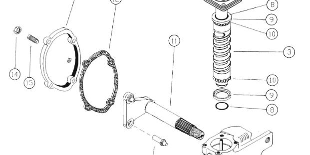

Gregor 4,848 #27 Posted December 8, 2021 (edited) 7 hours ago, RetroMower said: That means I got dibs on the ross steering boxes like I said mine is useable but its pretty crunchy Those boxes are adjustable. I have also made new adjuster screws ( # 15 in diagram )from grade 8, 1/2" bolts. These screws ride in the spiral of the shaft. Over time, the screws get wore flat. Sometimes you can turn them just enough to get back to a round surface, sometimes not. Edited December 8, 2021 by Gregor 2 Share this post Link to post Share on other sites

RetroMower 350 #29 Posted December 8, 2021 3 hours ago, Gregor said: Those boxes are adjustable. I have also made new adjuster screws ( # 15 in diagram )from grade 8, 1/2" bolts. These screws ride in the spiral of the shaft. Over time, the screws get wore flat. Sometimes you can turn them just enough to get back to a round surface, sometimes not. I'll have to check my adjuster screw. I cant remember if its worn flat or not. My problem is the aluminum housing that holds the big threaded plug has a fair size chunk missing and those weird cup bearings are less than stellar. I didn't realize Hapco had them. Share this post Link to post Share on other sites
oliver2-44 11,721 #30 Posted December 8, 2021 On the Ross Steering boxes, if you need to replace the upper tubing, it is an odd size. But the tubing they use for Trampolines legs will fit. I used it on my Case 180 ross Steering box rebuild and had to sand the outside just a little with my belt sander to get it to fit. I used JB Weld to glue it to the aluminum housing. Share this post Link to post Share on other sites
