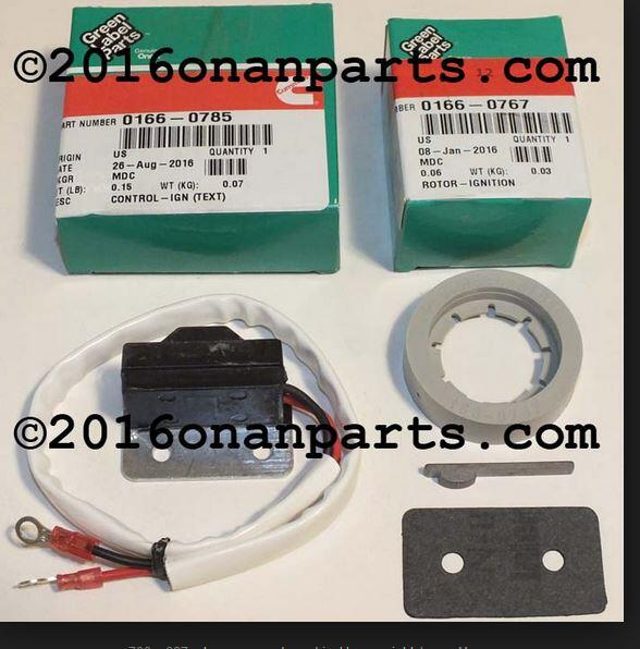

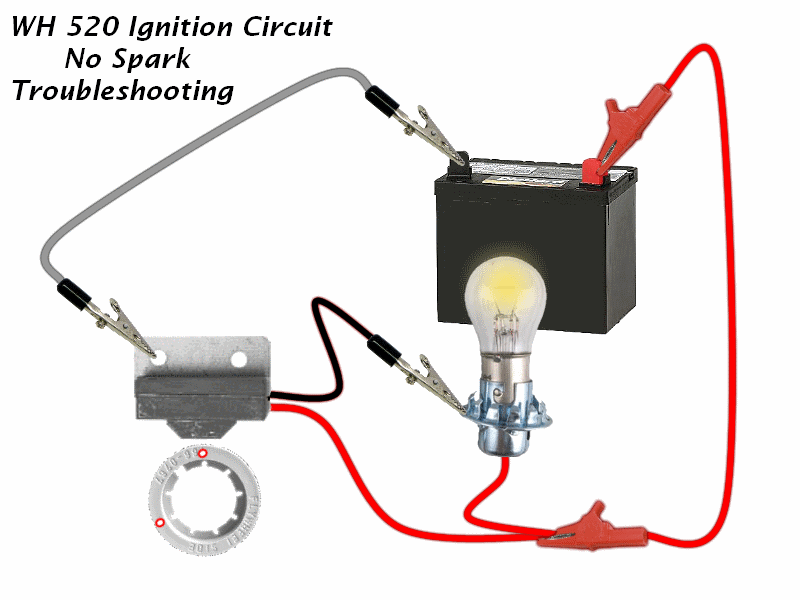

JaysHorse 287 #37 Posted December 31, 2021 So after hooking the red wire of ICM to 12v and grounding my black lead of VOM and the red lead of VOM to black lead of ICM and turning the engine over by hand it does not switch from 1vdc to 12vdc as per manual for testing. I guess off comes the flywheel again. And possibly replace the ICM and trigger ring. 1 Share this post Link to post Share on other sites
JaysHorse 287 #38 Posted January 8, 2022 Update…… Found another way of testing the ICM and that seems to be working good. All voltages to the coil are what they should be per the manual. I guess really the only other thing to check at this point is swap out the coil and wires. Share this post Link to post Share on other sites

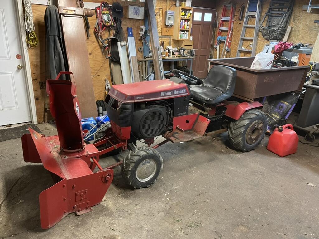

JaysHorse 287 #40 Posted January 10, 2022 After some patience she’s ready to haul firewood and blow snow!! Share this post Link to post Share on other sites
Snoopy11 5,731 #41 Posted January 10, 2022 21 hours ago, JaysHorse said: Turns out it is the coil that is bad I have been quietly sneaking around... So... @JaysHorse... I think it is worthy to ask... earlier in the thread when you said that you had spark... how exactly did you know that you had spark... I am thinking... maybe you were seeing (weak) spark if you did a visual check... (Just want to clarify this for further readers... just in case). Don Share this post Link to post Share on other sites
JaysHorse 287 #42 Posted January 11, 2022 19 hours ago, Snoopy11 said: I have been quietly sneaking around... So... @JaysHorse... I think it is worthy to ask... earlier in the thread when you said that you had spark... how exactly did you know that you had spark... I am thinking... maybe you were seeing (weak) spark if you did a visual check... (Just want to clarify this for further readers... just in case). Don Don, I did the visual check and saw a spark. I also checked the coil per manual and all checks checked out correct. I could also get it to fire when I would fiddle around with the ignition key switch. That’s why at first I thought it was that but that wasn’t the case. Then I moved on the check the ICM (ignition control module) and that failed the check. So I removed that and cleaned it up and checked it using the above picture method and that worked properly. Put everything back together for what felt like the hundredth time and still nothing. Luckily I have another Onan machine and robbed the coil and wires and she fired right up. I put my old wires on and she still fired up. Leads me to believe it was the coil all along. The real butt scratcher is the oils coil checked out fine with the resistance checks. 1 1 Share this post Link to post Share on other sites
Snoopy11 5,731 #43 Posted January 11, 2022 59 minutes ago, JaysHorse said: Don, I did the visual check and saw a spark. I also checked the coil per manual and all checks checked out correct. I could also get it to fire when I would fiddle around with the ignition key switch. That’s why at first I thought it was that but that wasn’t the case. Then I moved on the check the ICM (ignition control module) and that failed the check. So I removed that and cleaned it up and checked it using the above picture method and that worked properly. Put everything back together for what felt like the hundredth time and still nothing. Luckily I have another Onan machine and robbed the coil and wires and she fired right up. I put my old wires on and she still fired up. Leads me to believe it was the coil all along. The real butt scratcher is the oils coil checked out fine with the resistance checks. I 'tink that your thread is going to help someone else in the future, for sure! Don 1 Share this post Link to post Share on other sites
