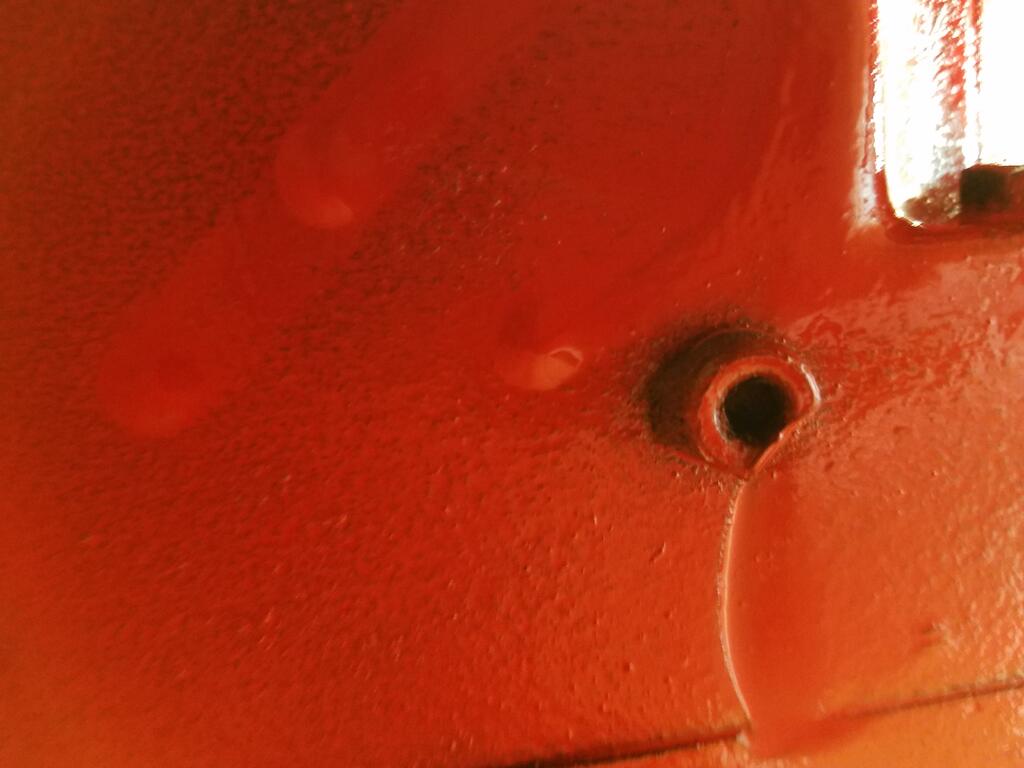

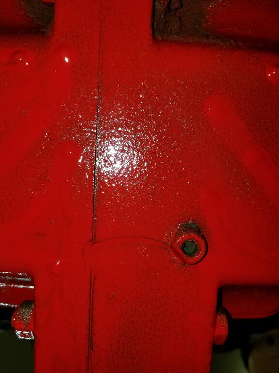

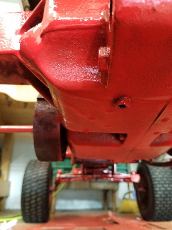

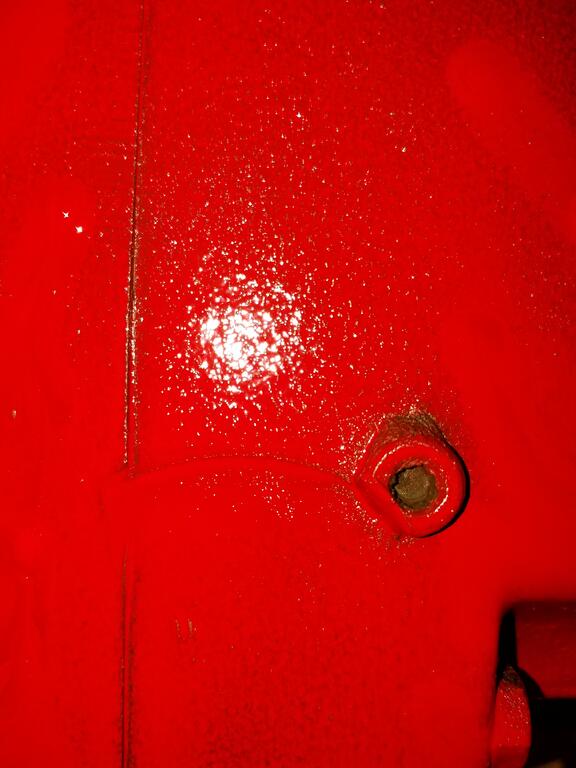

Mustang67ford 234 #1 Posted December 5, 2021 Is this the tranny drain plug? What is it supposed to be, an allen hex head? Looks awfully messed up. After doing some research, it looks like it is but the draw bar tends to hit it? Any hints to getting it out in this condition? Share this post Link to post Share on other sites
SylvanLakeWH 29,550 #2 Posted December 5, 2021 Yes that’s the drain plug. Yes it’s a hex. Go very easy on the removal… make sure it’s clean if all gunk so you get full bite on the wrench… Man…something really jiggered that up… if it won’t budge, maybe dremmel tool to grind cut that little ridge? 2 Share this post Link to post Share on other sites
peter lena 9,518 #3 Posted December 5, 2021 @Mustang67ford agree with @SylvanLakeWH on that solid removal detail , looks like a allen/ torx type ,tap it in place I like the socket type on a small breaker bar, the more solid the fit , the easier it will come out , go easy and slow , if the plug is bad , replace it with a new one , jake up the front end to enhance the drainage , you might have to do it a couple of times depending on how bad it looks , new shift boot , pete 1 Share this post Link to post Share on other sites
Mustang67ford 234 #4 Posted December 5, 2021 Thanks. I'll be messing with this soon. Is that a standard drain plug? Anybody think of replacing with a normal plug like on the fill or should I replace with the same thing? Any fix to keep the draw bar from hitting? Share this post Link to post Share on other sites
stevasaurus 23,493 #5 Posted December 5, 2021 Yes, it is a standard pipe fitting plug, available at any hardware store. You could put in a hex head. It depends on how you use that horse. If you are running over logs, stones, large debris, the Allen head plug gives you a flush mount. 2 Share this post Link to post Share on other sites
Mustang67ford 234 #6 Posted December 5, 2021 7 minutes ago, stevasaurus said: Yes, it is a standard pipe fitting plug, available at any hardware store. You could put in a hex head. It depends on how you use that horse. If you are running over logs, stones large debris, the Allen plug gives you a flush mount. That makes sense. Wonder why mine is sticking down? Guess that is why it was getting hit by the hitch. 1 Share this post Link to post Share on other sites
lynnmor 8,152 #7 Posted December 5, 2021 3 hours ago, Mustang67ford said: Wonder why mine is sticking down? Guess that is why it was getting hit by the hitch. I think they all stuck out a bit and some implements may hit them. I tapped the transmission a bit deeper and ground off a small amount of the plug to get it flush. 2 Share this post Link to post Share on other sites
Mustang67ford 234 #8 Posted December 6, 2021 23 hours ago, lynnmor said: I think they all stuck out a bit and some implements may hit them. I tapped the transmission a bit deeper and ground off a small amount of the plug to get it flush. If you were able to grind it some and still get a bite to take it out, that makes me a little less worries when I go to take this one out. Share this post Link to post Share on other sites
Mustang67ford 234 #9 Posted December 6, 2021 On 12/5/2021 at 11:34 AM, peter lena said: @Mustang67ford agree with @SylvanLakeWH on that solid removal detail , looks like a allen/ torx type ,tap it in place I like the socket type on a small breaker bar, the more solid the fit , the easier it will come out , go easy and slow , if the plug is bad , replace it with a new one , jake up the front end to enhance the drainage , you might have to do it a couple of times depending on how bad it looks , new shift boot , pete Ever try an impact gun on the removal? Sometimes the jolting will help knock loose. Or, will that strip it? Share this post Link to post Share on other sites
lynnmor 8,152 #10 Posted December 6, 2021 Just now, Mustang67ford said: If you were able to grind it some and still get a bite to take it out, that makes me a little less worries when I go to take this one out. You will need to make your own judgement on removing material from the drain plug, they can vary in depth of the hex. Share this post Link to post Share on other sites
lynnmor 8,152 #11 Posted December 6, 2021 1 minute ago, Mustang67ford said: Ever try an impact gun on the removal? Sometimes the jolting will help knock loose. Or, will that strip it? I made up a tool from a larger hex wrench so that it could be hammered in the bad socket and get a grip. Share this post Link to post Share on other sites
peter lena 9,518 #12 Posted December 6, 2021 @Mustang67ford personally would not use an impact gun on that , a socket Allen or torx type just to get a solid fit , , if its that bad you might even drill thru the existing hole and use a short easy out , on a breaker bar . you might even try a curved jaw vise grip plyer on that , the tighter the grip , the better the chances , go easy on your start , don't waste a solid bite . never had one that did not move on a breaker bar . pete 1 Share this post Link to post Share on other sites
Mustang67ford 234 #13 Posted December 7, 2021 Got it loose. There was a lot of slop between the plug and the hex, but was enough to get a bite. Was sweating that one a little. 1 1 Share this post Link to post Share on other sites
