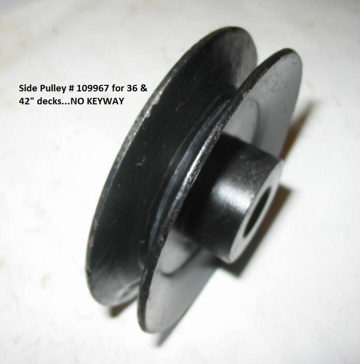

daveoman1966 3,881 #2 Posted December 5, 2021 (edited) 2 types of pulleys... (1)has a 'rib' on it ..(#106072) for a special tool to remove it...(2)the other type does not (#109967). If #1, use a power steering pump pulley remover available to rent free at AutoZone. If #2 w/o the rib...(1) remove top grease zerk and back of nut flush to top of shaft. (2) set spindle housing the the hollow of a cement block underneath...a cofffee can MAY work. (3)Set the flat of a non-steel ball-peen hammer onto top of shaft (4) with a bigger (non-steel) hammer, WHACK the ball peen (like you have a pair) (5) This should break the pulley free, then remove top nut. ps...don't be bashful about WHACKING that ball peen. Edited December 5, 2021 by daveoman1966 2 Share this post Link to post Share on other sites

peter lena 9,602 #4 Posted December 5, 2021 @Johnny G , when attempting to remove any pulley , you must use equal leverage , at the underside of the pulley , up tight against the pulley center hub. get 2 of these flat pry bars ,https://www.harborfreight.com/15-1-2-half-inch-flat-pry-bar-2529.html? put the , 90 degree end , under the pulley on top of the spindle bolts for equal leverage , penetrating oil . push pry bars equally off to the side , pulley pops off no bent pulley or damage . done this a number of times , always works , pete Share this post Link to post Share on other sites
