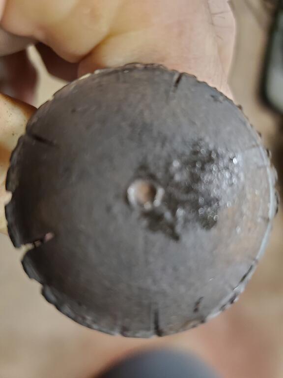

Thor27 848 #1 Posted November 29, 2021 (edited) Recently picked up a m18, had hopes of a quick de carbon, reseal, and put to work, unfortunately this appears to be a very high hour unit. It's std, no cross hatch, bit of a ridge. It also has a badly burned exhaust valve on #1, and the seat and guides aren't pretty. Looking for advice. If I go for a full rebuild with machine work, pistons and rods, could i buy a used m20 crank and build this as a 20? Is there a downside other than the big one (cost)? Other option is looking for a good running mv18 and robbing pistons, rods, and jugs. Imho the vertical shaft tractors don't seem to last as long as their kohlers do. What would you do? Edited November 30, 2021 by Thor27 Share this post Link to post Share on other sites

Thor27 848 #4 Posted December 1, 2021 (edited) I was all ready to go for the used MV route, Until I re read your build Paul, now I'm back on the fence because yours looks so good inside. I was spoiled when my last magnum went together because I didn't have to replace hard parts. So, No Lash on this valve so it was slightly open for lord only knows how long. You could shave with this thing... Edited December 1, 2021 by Thor27 Add pics from phone 1 Share this post Link to post Share on other sites
pfrederi 19,881 #5 Posted December 1, 2021 10 hours ago, Thor27 said: I was all ready to go for the used MV route, Until I re read your build Paul, now I'm back on the fence because yours looks so good inside. I was spoiled when my last magnum went together because I didn't have to replace hard parts. So, No Lash on this valve so it was slightly open for lord only knows how long. You could shave with this thing... When you start looking for valves be advised at some point in production they changed from 45 to 30 degree 1 1 Share this post Link to post Share on other sites
