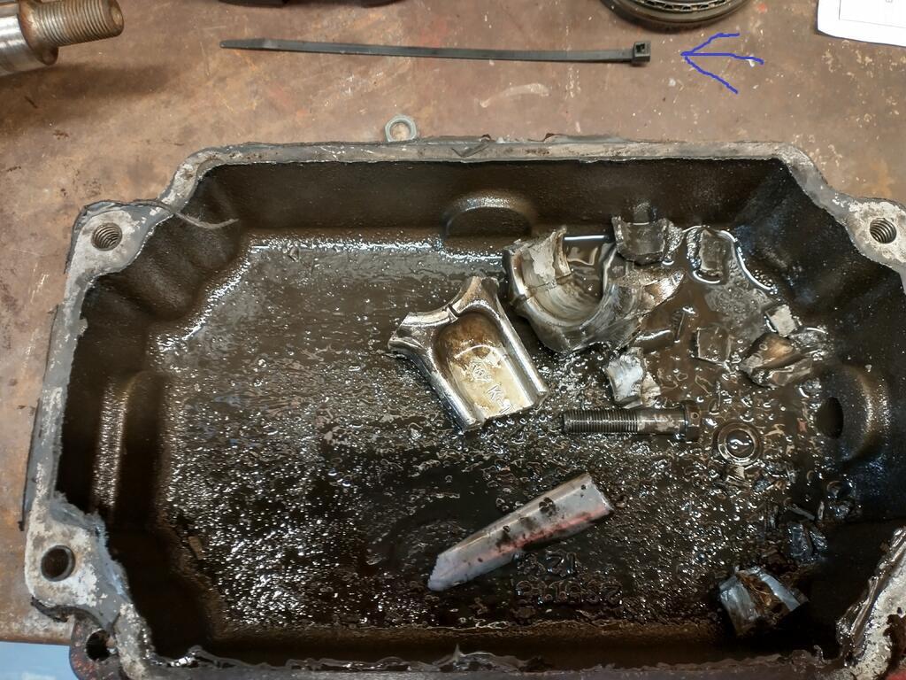

Snoopy11 5,731 #33 Posted November 29, 2021 6 hours ago, squonk said: Was the ziptie holding the rod cap on? Don Share this post Link to post Share on other sites

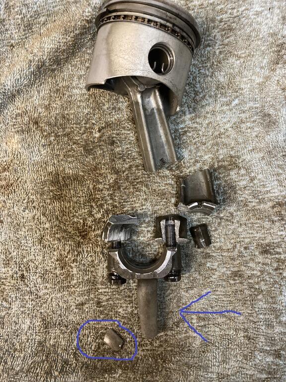

slim67 2,825 #34 Posted November 29, 2021 2 hours ago, Snoopy11 said: The good thing is, your oil dipper is still intact. That is another culprit of engine failure... as without that little stupid-looking dipper, our engines would be toast. Not enough oil in the crankcase is, in my opinion, what caused this failure. Don Do you mean the dipper on the end of the end cap or the dipstick? The oil dipper on the end of the end cap is broke off. It isn’t much but I did fish the piece out. Share this post Link to post Share on other sites
Snoopy11 5,731 #35 Posted November 29, 2021 2 hours ago, slim67 said: Do you mean the dipper on the end of the end cap or the dipstick? The oil dipper on the end of the end cap is broke off. It isn’t much but I did fish the piece out. Now, the little piece that I have circled... is that part of the oil dipper??? Don Share this post Link to post Share on other sites
slim67 2,825 #36 Posted November 29, 2021 49 minutes ago, Snoopy11 said: Now, the little piece that I have circled... is that part of the oil dipper??? You are correct ! I think Stens has a steel replacement but haven’t verified that for sure. I’m sure another aluminum rod will probably outlast me though. I’m good about checking the oil on anything I own or use plus oil changes. 1 Share this post Link to post Share on other sites

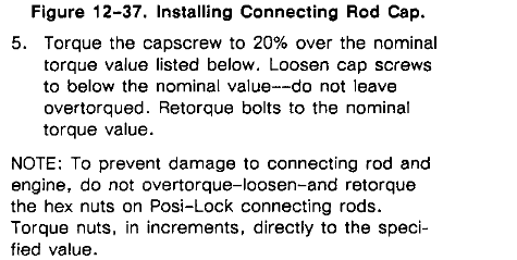

Horseoholic 258 #37 Posted December 1, 2021 On 11/29/2021 at 12:41 PM, Snoopy11 said: Oh, and to further answer one of your questions @Gregor... rod bolts can break, but normally only when they are not torqued correctly. Rod bolts are not like normal bolts. When you go to torque a rod bolt, the bolt is actually stretching, which locks it into place. It will stay tight forever (proverbially speaking) if it is torqued correctly. If it is torqued incorrectly, 2 things could happen. The rod bolts will back out, and loosen further, leading the rod cap to... do obvious things. However, believe it or not, if it is overtightened, the rod bolts themselves will break. If installed correctly, it is VERY unlikely that rod bolts are the culprit. AND, if an engine has been running for years and years without issue, it is even less likely that rod bolts are the culprit. On a brand new engine, if a rod was to fail, the first thing you would think is rod bolts, and justifiably so. Don Got a question on rod bolt torque , I've read from people on other websites about when torquing brand new rod cap bolts that you should "over torque" the bolts if I remember correctly about 20% more than factory specs then back them off and torque them to the factory specs to mainly do what you mentioned about stretching the bolts , I'm guessing this is to "pre-stretch" the bolts to try to eliminate the rod bolts from backing out ? Have you or anyone else heard of doing this? Last month I bought a Wheel Horse 1057 that was advertised as having no compression , well....... The K241 in this tractor has the exact same issue.... You can look down the oil fill hole and see the rod laying down there in the oil pan , I don't have the engine off and apart yet to see what other issues are there , I just seen this topic and will be following it, just wanted some opinions about the torque procedure I mentioned for when I cross that bridge with my K241. Thanks. 1 Share this post Link to post Share on other sites
Gregor 4,848 #38 Posted December 1, 2021 Kohler manuals Poke Here Page 12.12 Kohler manual 1 Share this post Link to post Share on other sites
Snoopy11 5,731 #39 Posted December 1, 2021 3 hours ago, Horseoholic said: Got a question on rod bolt torque , I've read from people on other websites about when torquing brand new rod cap bolts that you should "over torque" the bolts if I remember correctly about 20% more than factory specs then back them off and torque them to the factory specs to mainly do what you mentioned about stretching the bolts , I'm guessing this is to "pre-stretch" the bolts to try to eliminate the rod bolts from backing out ? Have you or anyone else heard of doing this? Last month I bought a Wheel Horse 1057 that was advertised as having no compression , well....... The K241 in this tractor has the exact same issue.... You can look down the oil fill hole and see the rod laying down there in the oil pan , I don't have the engine off and apart yet to see what other issues are there , I just seen this topic and will be following it, just wanted some opinions about the torque procedure I mentioned for when I cross that bridge with my K241. Thanks. Very good question. The answer to this question is that, it has nothing to do with rod bolt stretch. What you are doing when you overtorque the rod bolts at first is seating the rod cap. It is especially important to do this and loosen the rod bolts, then retighten. If you look VERY closely as you are tightening it for the first time, you will see the rod cap gap between the cap and the actual rod portion get smaller. Again, It is an important procedure to make sure the rod cap is seated. You also want to make sure that your rod bolts are lubricated with oil, and that you apply butt loads of molly lube in the rod bearing and on the crank journal. YES, it is a big mess, but you want the molly lube oozing out when you put the rod cap on. What we notice in engine building, particularly with rods and babbitt bearings is that... taking extra precautions (which is really what this is) never hurts, especially when you invest time an effort into a build. If you have any other thoughts or questions, buddy, be sure to ask them. Good question @Horseoholic Don 1 Share this post Link to post Share on other sites
