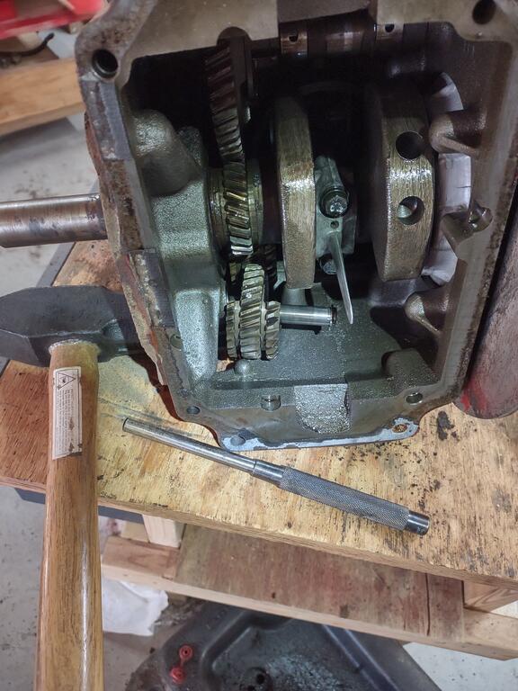

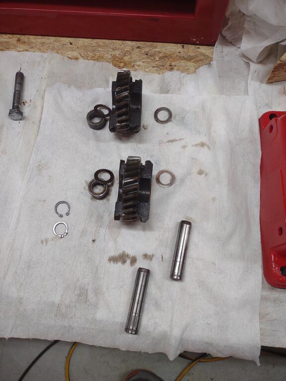

ebinmaine 79,116 #79 Posted January 1, 2023 On 11/27/2021 at 8:12 PM, kpinnc said: Ok, so he drove out the pin and then back when finished Well folks I tried this today on my C160 Automatic K341. Bit of a chore driving the pins but it worked great. I did end up causing a mushroom end on the second one so I had to slice off the end with help from a Dremel. Don't care. It works fine the way it is. The shafts only need to be driven back in to prevent oil escaping. 1 2 Share this post Link to post Share on other sites
oliver2-44 11,515 #80 Posted January 2, 2023 Driving the pins seems like a lot of extra work. The gears split so easy with a cold chisel. 1 Share this post Link to post Share on other sites
ebinmaine 79,116 #81 Posted January 2, 2023 8 hours ago, oliver2-44 said: Driving the pins seems like a lot of extra work. The gears split so easy with a cold chisel. I agree with that in principle. I tried the split with the chisel I had available. Fail. I do however have a VERY nice set of long straight round Starrett punches. More work? Yes. Got it done though... 1 Share this post Link to post Share on other sites
kpinnc 18,386 #82 Posted January 3, 2023 (edited) 19 hours ago, oliver2-44 said: Driving the pins seems like a lot of extra work. The gears split so easy with a cold chisel. I went with the pins because I wasn't sure if I could find all the fragments and needle bearings if I used a chisel. My vision up close is not what it used to be. Whatever method works for you, works for me! Edited January 3, 2023 by kpinnc 1 1 Share this post Link to post Share on other sites
953 nut 66,542 #83 Posted January 3, 2023 11 hours ago, kpinnc said: went with the pins because I wasn't sure if I could find all the fragments and needle bearings if I used a chisel I have always had that thought about the broken gear fragments causing a problem later on. 1 Share this post Link to post Share on other sites
kpinnc 18,386 #84 Posted January 4, 2023 15 hours ago, 953 nut said: I have always had that thought about the broken gear fragments causing a problem later on. And for clarification- you only pop out the top pin. The lower clip is easy to reach. 1 Share this post Link to post Share on other sites
