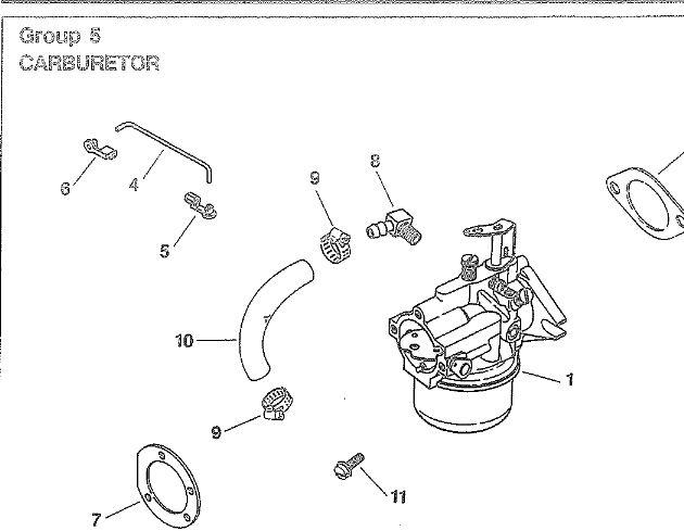

pfrederi 21,303 #58 Posted November 30, 2021 Later Kohlers had plastic inserts that went in the governor arm and the carb arm. They are replaceable.. Wonder if you could enlarge the holes in the older ones and use the plastic things. (#5 and #6) 1 Share this post Link to post Share on other sites
ebinmaine 81,139 #59 Posted November 30, 2021 7 minutes ago, pfrederi said: Later Kohlers had plastic inserts that went in the governor arm and the carb arm. They are replaceable.. Wonder if you could enlarge the holes in the older ones and use the plastic things. (#5 and #6) I'd had a similar thought but using a brass insert. I'll have to look in my box of parts or whatever and see if I can find one of those plastic ones.. 1 Share this post Link to post Share on other sites

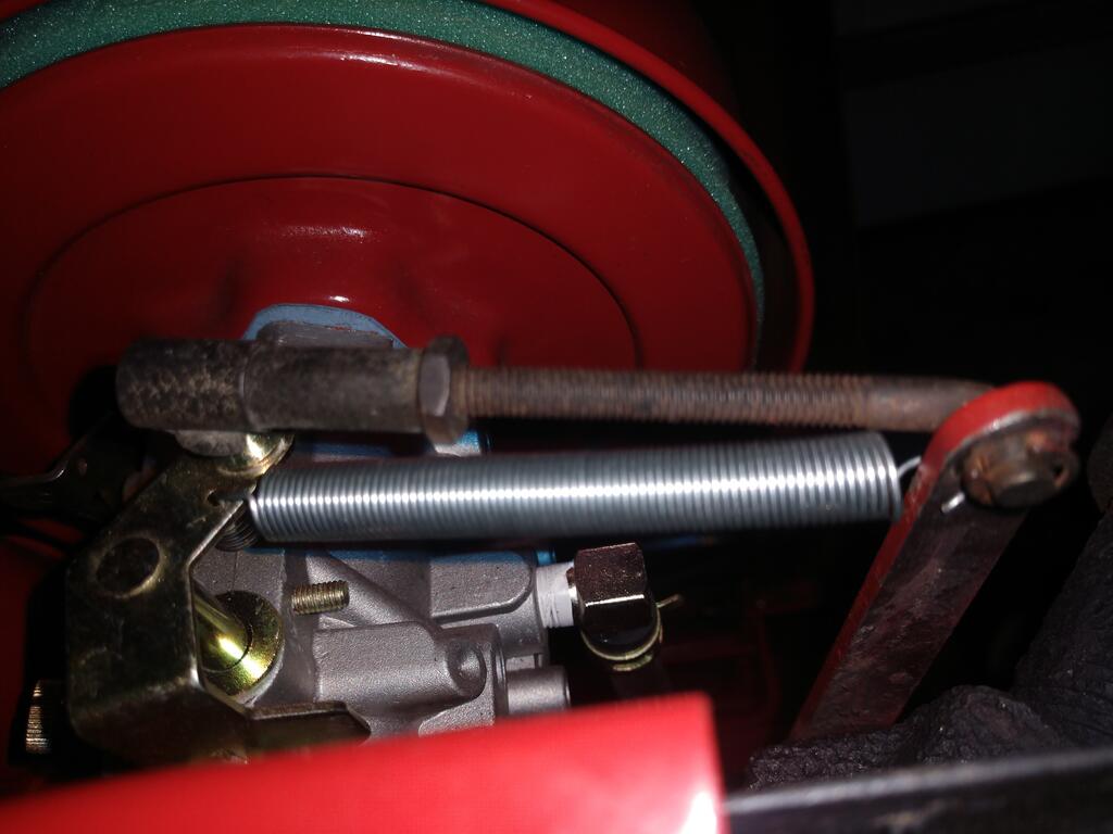

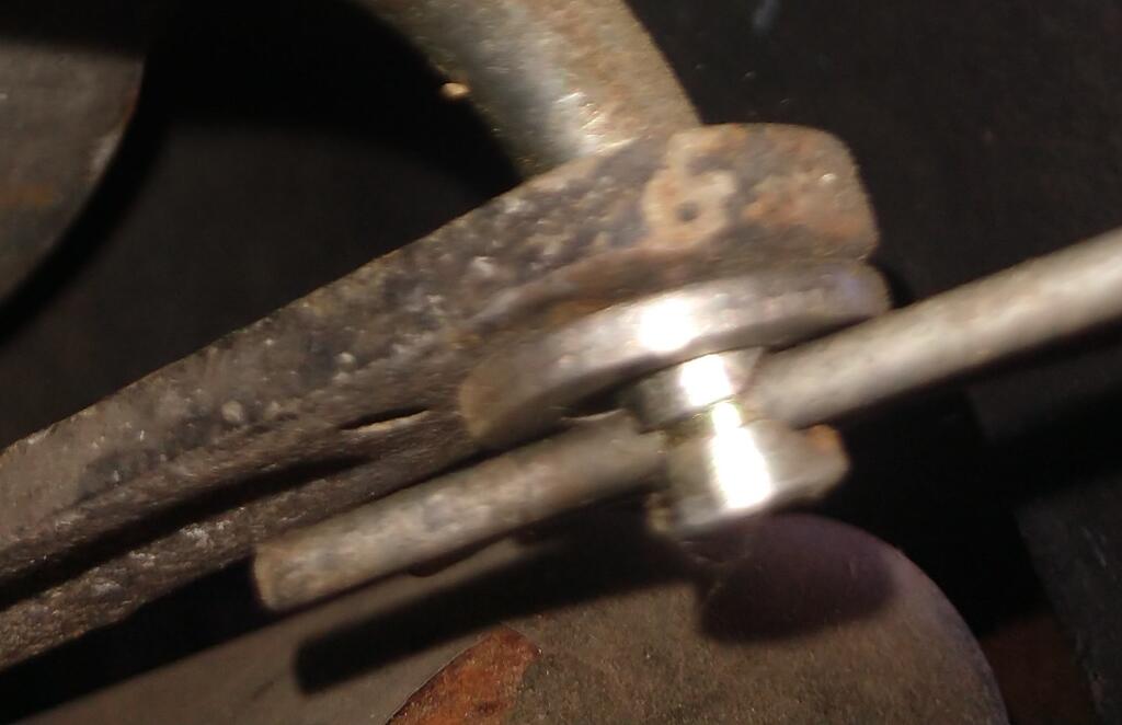

kpinnc 19,060 #61 Posted November 30, 2021 I like the inserts, but they wear too. Magnums have holes to add a spring in the governor arm and carb (look close at the pic), so maybe drill the same? Pic of mine: 1 1 Share this post Link to post Share on other sites

kpinnc 19,060 #64 Posted December 1, 2021 2 hours ago, ebinmaine said: Thanks for that pic. Methinks that would solve a lot of the issue. Another pic because the governor hole is hard to see. 1 1 Share this post Link to post Share on other sites
kpinnc 19,060 #65 Posted December 1, 2021 (edited) I made a little 1/16 hole in the governor arm and added this spring. It's not strong at all, but should be enough to take up the slop. I've done this before on a hunting governor and it took care of it. Hopefully it will add some sensitivity beyond the adjustment from the manual. Prior to adding the spring, there was about 1/8 play between the arm and throttle tab. Probably isn't actually that much, but all the combined slop certainly looked like it. At least now if the governor arm just adds pressure, the throttle will immediately respond. That's my theory anyway... Edited December 1, 2021 by kpinnc 5 Share this post Link to post Share on other sites

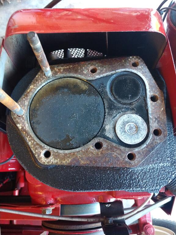

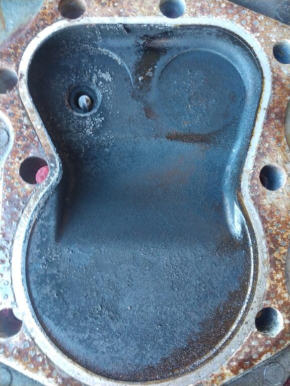

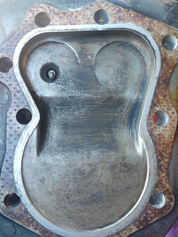

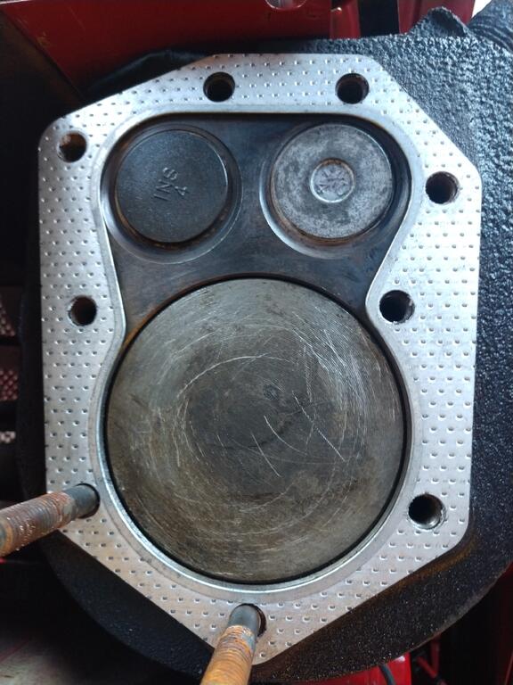

kpinnc 19,060 #70 Posted December 3, 2021 (edited) Last pics for this one. I hoped to find a clump of carbon or something binding a valve, but nothing. Seats are good, valves have full travel. So I cleaned the carbon, put on a new gasket, and shut her back up. If it blows up due to the tick, we'll rebuild it next year. Balance gears can no longer contribute to the equation, so that is that. Before and after on the noggin below. Didn't mean to scratch the piston face up so much... The oily residue on top of the piston was leftover winterizing from my FIL. Edited December 3, 2021 by kpinnc 2 Share this post Link to post Share on other sites

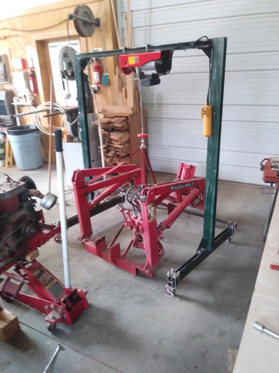

sparkys toy 77 #72 Posted December 5, 2021 built this out of scrap unistrut it got for free and 100 dollar dear winch from cabelas works great 1 Share this post Link to post Share on other sites

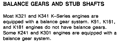

killroy 37 #73 Posted December 8, 2021 So back to counter gears does a 73 16hp k series have them ? Share this post Link to post Share on other sites

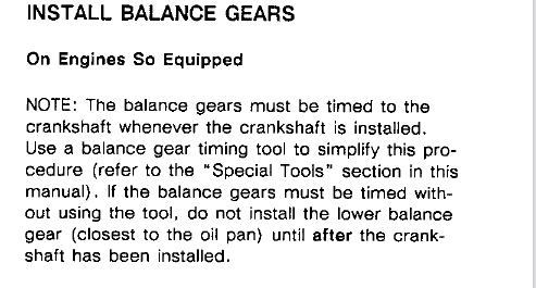

Gregor 4,848 #74 Posted December 8, 2021 (edited) 33 minutes ago, killroy said: So back to counter gears does a 73 16hp k series have them ? Do you have a complete Model number, and spec # ? Someone else may know. From the Kohler manual Page 11.11 Page 12 .3 From another forum. Is this motor by chance from a generator? I have a K341 that came out of a genset that never had the bal. gears. They aren't absolutely necessary. Edited December 8, 2021 by Gregor 1 Share this post Link to post Share on other sites
killroy 37 #75 Posted December 8, 2021 No numbers. Cover is long gone . I don't remember if it had them when I replaced rod 20 years ago. Lol 1 Share this post Link to post Share on other sites
