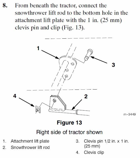

woodworker4421 1 #1 Posted November 27, 2021 i have a 520 xi with a snowblower. i was missing the flag. but had one made. the tractor does not lift the blower?what am i missing the trans fluid is correct. Share this post Link to post Share on other sites
Maxwell-8 4,370 #2 Posted November 27, 2021 2 hours ago, woodworker4421 said: i have a 520 xi with a snowblower. i was missing the flag. but had one made. the tractor does not lift the blower?what am i missing the trans fluid is correct. Is the hydraulic cylinder moving? Share this post Link to post Share on other sites
gwest_ca-(File Mod) 12,015 #3 Posted November 27, 2021 Single stage or 2-stage snowthrower? Share this post Link to post Share on other sites
stevebo-(Moderator) 8,604 #4 Posted November 27, 2021 I had one on my 522lxi and it did not go up far at all either. Just enough to get it off the ground Share this post Link to post Share on other sites
woodworker4421 1 #5 Posted November 27, 2021 yes thearm is moving . it lifts my 60" deck ok .two stage blower maxwell do you have a drawing? i made one for mine so i thought that i did not make correct Share this post Link to post Share on other sites
woodworker4421 1 #6 Posted November 28, 2021 got it . there was two holes where thelag attachs fi had it in the lower one needs to be in the top one Share this post Link to post Share on other sites
