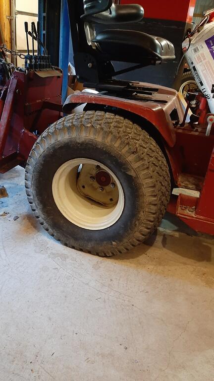

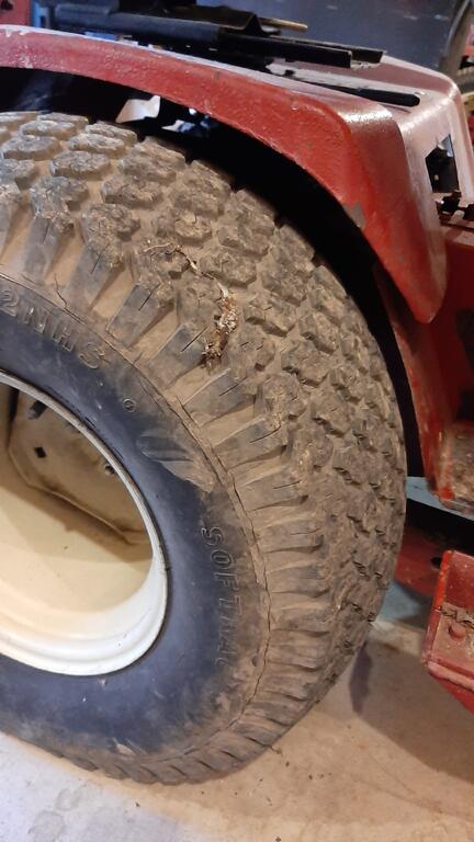

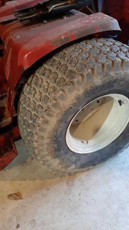

roadapples 6,987 #34 Posted November 26, 2021 (edited) 1 hour ago, Maxwell-8 said: Don't laugh at me, but I am currently wanting to put anything from a 25x10-12 up to a 26x12-12. I will be widening my rims, and moving the tranny slightly to the back. Bigger tires give me some more speed, and tend to have bigger lugs. the wider tire does better in our kind of mud. I have 26x12-12's on a C160. Had to raise the fender pan but didn't have to move the rear. Doing so would also change belt length... Mine clear the foot boards but they are turfs. Not sure about ags. Edited November 26, 2021 by roadapples 1 1 Share this post Link to post Share on other sites
Maxwell-8 4,371 #35 Posted November 26, 2021 1 minute ago, roadapples said: I have 26x12-12's on a C160. Had to raise the fender pan but didn't have to move the rear. Doing so would also change belt length... Do you have a picture? You widened the rims? Share this post Link to post Share on other sites
ebinmaine 80,642 #36 Posted November 26, 2021 3 minutes ago, roadapples said: I have 26x12-12's on a C160. Them monster meats cleared the upper part of the footrest?? Share this post Link to post Share on other sites
roadapples 6,987 #37 Posted November 26, 2021 15 minutes ago, Maxwell-8 said: Do you have a picture? You widened the rims? 13 minutes ago, ebinmaine said: Them monster meats cleared the upper part of the footrest?? 8 1/2" rims. 2 1 Share this post Link to post Share on other sites
Maxwell-8 4,371 #38 Posted November 26, 2021 11 minutes ago, roadapples said: 8 1/2" rims. On Stock rims, they fit like a glove. probably due to the extra height. A 23x12-12 has not enough height to compensate for the extra width Share this post Link to post Share on other sites

roadapples 6,987 #41 Posted November 26, 2021 4 minutes ago, Maxwell-8 said: On Stock rims, they fit like a glove. probably due to the extra height. A 23x12-12 has not enough height to compensate for the extra width These balloon some in the middle. Wheels should be wider. They are off of a Cub zero turn. Same back space as wheel horse. 24x12-12's on wider wheels will fit with no modification. 1 Share this post Link to post Share on other sites
