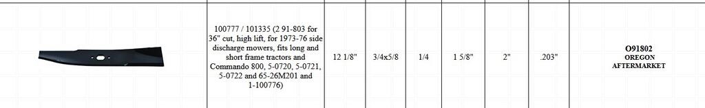

bigbore1934 3 #1 Posted November 23, 2021 Hello I have a 1975 B-80 and it's time for a new set of blades.I can't locate the part 3s I used last time but I know it is a 36 " deck (SIDE AND REAR DISCHARGE) and one of the blades was a high lift.They were made by OREGON also.Included is what I have found but cant make heads or tails on what #s to order. Any help is appreciated! Share this post Link to post Share on other sites
Maxwell-8 4,370 #2 Posted November 23, 2021 Is their such a things as a deck with side and reardischarge? the Oregon blades were not original. Share this post Link to post Share on other sites
gwest_ca-(File Mod) 11,878 #3 Posted November 23, 2021 14 hours ago, bigbore1934 said: Hello I have a 1975 B-80 and it's time for a new set of blades.I can't locate the part 3s I used last time but I know it is a 36 " deck (SIDE AND REAR DISCHARGE) and one of the blades was a high lift.They were made by OREGON also.Included is what I have found but cant make heads or tails on what #s to order. Any help is appreciated! You noticed the center holes are different on these? Original blades Rear discharge 9187 center blade and 9188 left and right blades replaced by 8969 3-blade kit (Hole 5/8in.x3/4in. Double-D) Side discharge 100776 14-1/8" center blade and 100777 12-1/8" left and right blades replaced by 101335 3-blade kit (Hole 5/8in.x3/4in. Double-D) Changing - Both sets available again from Toro Share this post Link to post Share on other sites
