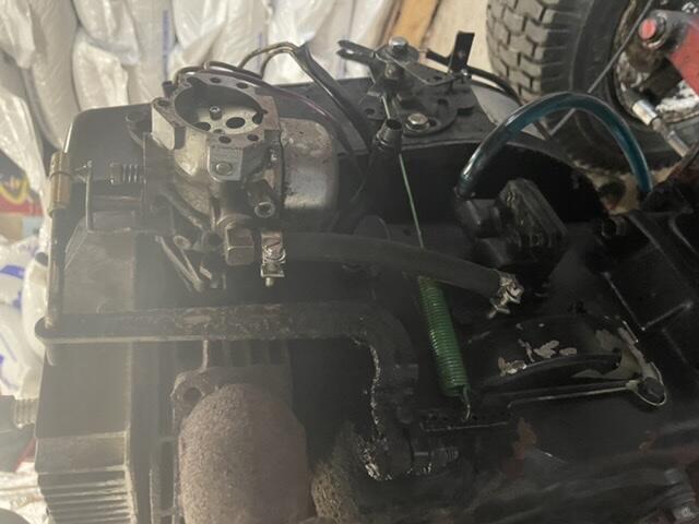

Maxwell-8 4,370 #5 Posted November 23, 2021 8 hours ago, AHS said: That sounds like a definite possibility! An M14, I like these. The only vent hose on an M is the one that connects the crankcase breather to the air box, right? yup, here a picture of my M12 1 Share this post Link to post Share on other sites
wallfish 19,317 #6 Posted November 23, 2021 10 hours ago, AHS said: That sounds like a definite possibility! An M14, I like these. The only vent hose on an M is the one that connects the crankcase breather to the air box, right? Correct. Open that cover and inspect everything. My internet diagnostic guess is something is going on in there. Reed valve stuck, backwards, filter thingy clogged up or that hose clogged. Something like that. Has it always leaked there? Just a recent thing? Any recent work done? How many hours on that engine? Is it just a new to you engine? How does it run? Any smoke when it's running? There's no real "seal" there, it's just the bushing piece that guides the shaft. Oil has to kind of be pushed out through gap in the hole with the shaft in it for it to leak out. Maybe over filled with oil could do it too. There should be plenty of lube in that bushing but I guess it's possible for the hole to be worn too. Please let us know what you find, if anything. Helps the next guy! 2 Share this post Link to post Share on other sites
AHS 1,594 #7 Posted November 24, 2021 17 hours ago, wallfish said: Correct. Open that cover and inspect everything. My internet diagnostic guess is something is going on in there. Reed valve stuck, backwards, filter thingy clogged up or that hose clogged. Something like that. Has it always leaked there? Just a recent thing? Any recent work done? How many hours on that engine? Is it just a new to you engine? How does it run? Any smoke when it's running? There's no real "seal" there, it's just the bushing piece that guides the shaft. Oil has to kind of be pushed out through gap in the hole with the shaft in it for it to leak out. Maybe over filled with oil could do it too. There should be plenty of lube in that bushing but I guess it's possible for the hole to be worn too. Please let us know what you find, if anything. Helps the next guy! It’s new to me. Just changed oil. The “owner before me” had it all buggered up… welded tie rods, wrong air filter, new carb. Had a lean carb; all fixed. I’ve ordered the bushing. Ya, you are right; open up and inspect everything! That’s my next step. Share this post Link to post Share on other sites
