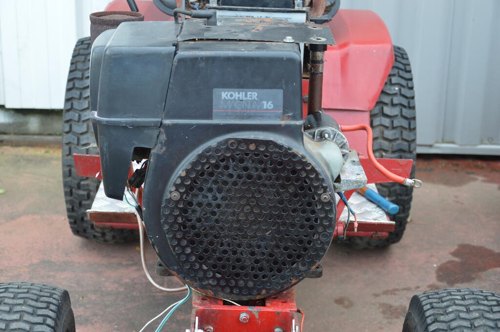

Maxwell-8 4,371 #53 Posted November 23, 2021 On 11/22/2021 at 2:43 AM, TJ salyers said: should i know anything about the kohler k341s the biggest single K-serie that has a flat-head. You may want to look in removing the balancer gear. I personally didn't on my M16 They have more then enough power! way more dependable then a tecky 1 Share this post Link to post Share on other sites
Maxwell-8 4,371 #54 Posted November 23, 2021 16 hours ago, Snoopy11 said: And, if, by chance, the pulley on the 8 speed transmission was larger, it would just make the tractor slower. Bigger pulley on the engine, faster tractor. Smaller pulley on the engine, slower tractor. Bigger pulley on transmission, slower tractor. Smaller pulley on the transmission, faster tractor. That simplifies things a bit... Don 1:1 would be ideal I think. on a 6 or 8speed. some calculations gave me a top speed of around 16mph. not bad. I am planning to get my c-141D to go around 15-20mph 1 Share this post Link to post Share on other sites
Snoopy11 5,731 #55 Posted November 23, 2021 Some people think that you need to remove the bearings in the block when you remove the balance gears. Not so. Those bearings are pressed in, they aren't going ANYWHERE. You can remove them for ...💩 and giggles... but it isn't really necessary. Just take out the balance gear, leave the bearings in the block, and bolt the engine cover back on. Done. Racing guys do this all the time. Don 1 Share this post Link to post Share on other sites
Snoopy11 5,731 #56 Posted November 23, 2021 2 minutes ago, Maxwell-8 said: some calculations gave me a top speed of around 16mph PURTY fast... 'bout double the tractor's stock speed. Don 2 Share this post Link to post Share on other sites
Maxwell-8 4,371 #57 Posted November 23, 2021 1 minute ago, Snoopy11 said: PURTY fast... 'bout double the tractor's stock speed. Don Makes low gear a lot more useable too 2 Share this post Link to post Share on other sites

Gregor 4,848 #74 Posted December 2, 2021 2 minutes ago, TJ salyers said: Not many people in my area has these if there is there to far An they want $300 - $400 for a non running engine. You really have no idea what you are buying. Rebuild what you have. 2 Share this post Link to post Share on other sites
Maxwell-8 4,371 #75 Posted December 2, 2021 I would give you this M16 if you lived a bit closer. 1 Share this post Link to post Share on other sites
