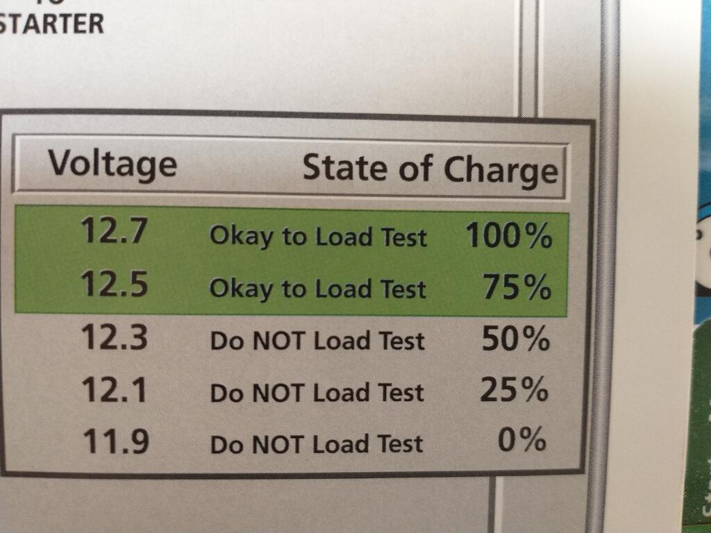

WHX?? 53,348 #3 Posted November 17, 2021 (edited) Any chance you got a DOA battery? It happens more often than not the way things are made nowadays. Any chance you have a parasitic draw? Easy to check this. Charge the battery and measure the voltage while still connected to the tractor and monitor the voltage. If VDC drops disconnect it and charge it again and monitor again if it drops when disconnected might mean a bad battery. Record all measurements. If it holds it voltage might mean a parasitic draw. Also charge the battery and check the voltage and record it. Run the tractor and see what the voltage is when say half and full throttle. Again record all measures and report back. Of course you will need a DMM for all of this. A $20 load tester from HF can eliminate bad batteries from trouble shooting efforts. Your on the right track by checking all connections and grounds. Edited November 17, 2021 by WHX?? 5 Share this post Link to post Share on other sites

Jeff-C175 7,207 #15 Posted November 17, 2021 (edited) I would put the battery on a known good charger and then check specific gravity to see if it actually did take a charge. Use a HYDROMETER for this. Decent ones can be had for under $20. And get the battery load tested AFTER it is fully charged. Only then would i start looking at the charging system on the tractor. Always look at the WEAKEST LINK (the battery itself) first. Edited November 17, 2021 by Jeff-C175 1 Share this post Link to post Share on other sites

Jacob S 67 #18 Posted November 18, 2021 I charged that battery and then read the volt meter and it said 12.70 and then I let us run for a bit and it was going down 2 every minute. Then I took the ground off the tractor and sanded it off and then ran it and it went up a little then down again. Share this post Link to post Share on other sites
