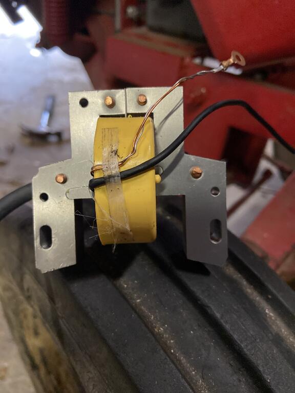

LLegg 6 #26 Posted November 18, 2021 Well that stinks. When I went to the part store I gave him the numbers and told him I wanted a solid-state coil so I didn’t need points and they sold me this one saying oh this is definitely the right one. I now know it’s the wrong one!! thanks again. 1 Share this post Link to post Share on other sites
Achto 30,961 #27 Posted November 18, 2021 (edited) See if they will take that one back & get a 398811, or after market equivalent that will work without points. Edited November 18, 2021 by Achto 1 Share this post Link to post Share on other sites
Snoopy11 5,731 #28 Posted November 18, 2021 On 11/16/2021 at 10:54 AM, bds1984 said: Fold a piece of paper three layers thick and place it between the coil and magnet. Or a business card. Don 2 Share this post Link to post Share on other sites
