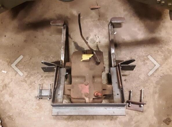

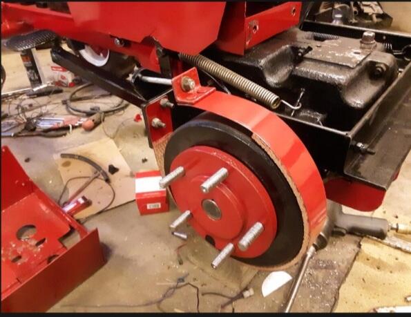

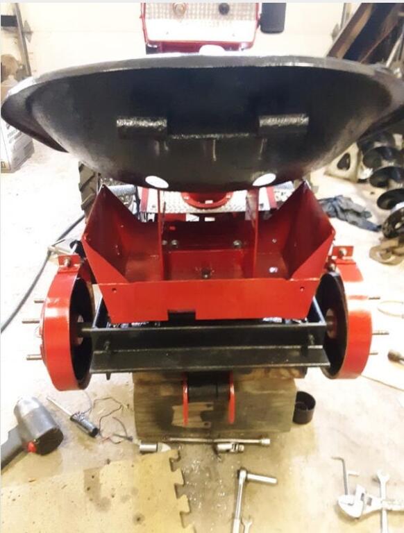

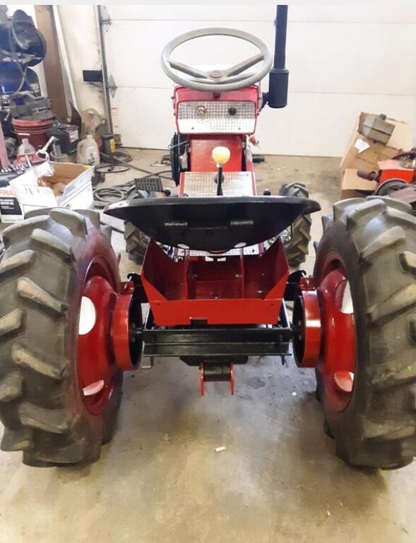

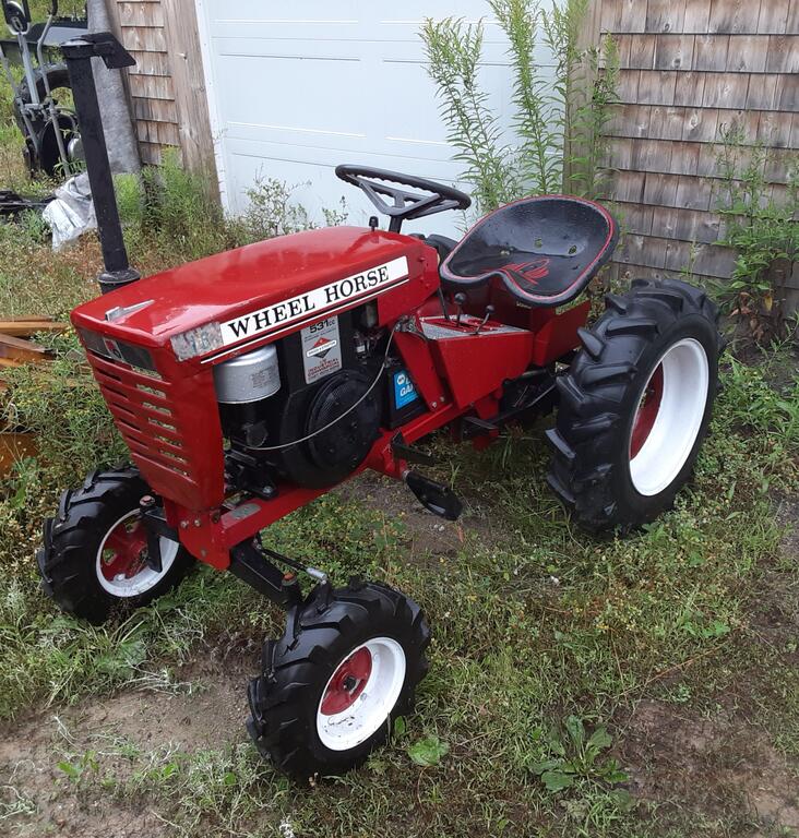

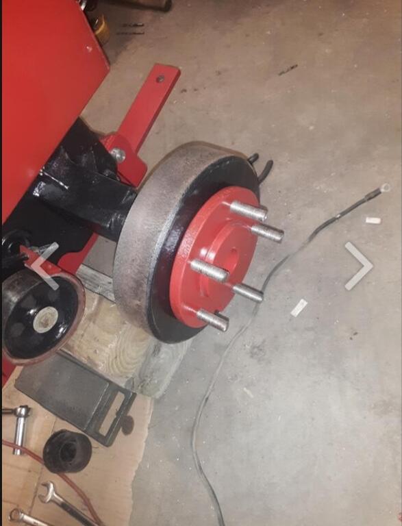

Oldskool 6,666 #7 Posted November 14, 2021 Welcome to RedSquare!!! Hub brakes on a C-121? This isn't a 121 and not stock but, this one has hub brakes. 2 2 3 Share this post Link to post Share on other sites

Oldskool 6,666 #10 Posted November 15, 2021 10 hours ago, elcamino/wheelhorse said: @Oldskool How about a picture of the brakes? 4 1 Share this post Link to post Share on other sites

Oldskool 6,666 #15 Posted November 15, 2021 1 hour ago, Maxwell-8 said: your interest? Would have already done it if Cub Cadet were ever sold here.... Doesn't look to hard to convert. How easy is it to steer with those brakes? It perks my interest a bit. I had a Cub given to me but not sure what year. I know it has a metal hood. My brakes work fairly decent. There are probably some changes that could be made 1 Share this post Link to post Share on other sites
ebinmaine 75,057 #16 Posted November 15, 2021 1 hour ago, Oldskool said: My brakes work fairly decent. There are probably some changes that could be made I've been meaning to ask you about that. What changes? Share this post Link to post Share on other sites
Oldskool 6,666 #17 Posted November 15, 2021 50 minutes ago, ebinmaine said: I've been meaning to ask you about that. What changes? Maybe use a bit thicker steel for the band. Also maybe change the direction of the actuation rod. Possibly down instead of forward? I was just using the WH design when I built it. There is definitely enough area of friction but maybe could use more torque on the rod. Reference pic #3 in my previous response. 1 Share this post Link to post Share on other sites
