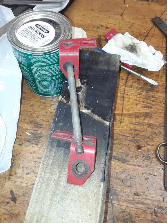

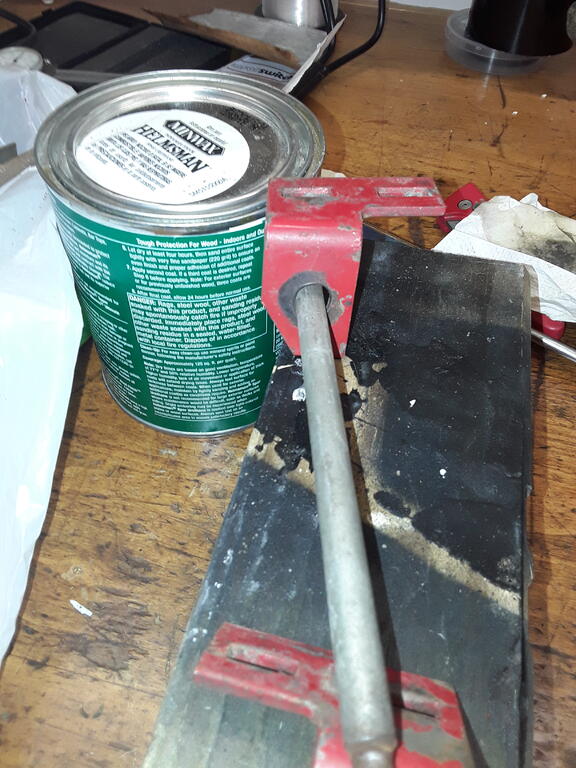

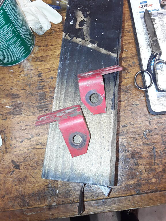

squonk 44,794 #14 Posted November 14, 2021 What did I do to my WH Today? WANTED to repair the hood hinge on my C-160. Managed to accomplish it but not without a RANT! I knew I wanted to use bushings as the hinges on the hood were knackered. Drilled those out.. Had a couple bushings in the drawer but I would have to cut them down. I decided to hit up some local stores to see If I could find any shorter. All the stores with the nice little drawer thingy's. All of them out of the size I wanted. All of them have been out of them for a long time. all of them the drawers are all mixed up so they have no idea what they are out of. All of them will be in the same condition in 6 month's Went to Napa and bought a 675-1246 Dodge door pin and bushing kit for 8 bucks. It has 2 bushings the right size. 2 bushings too small so they go in the drawer. 2 e clips for the drawer and 2 pins for the scrap bucket. 5 stores until I got what I needed. Went to install the new stainless hood pin I got from a member here. He cut the grooves for the clips wrong so I had to use the old pin that wasn't too far knackered Share this post Link to post Share on other sites

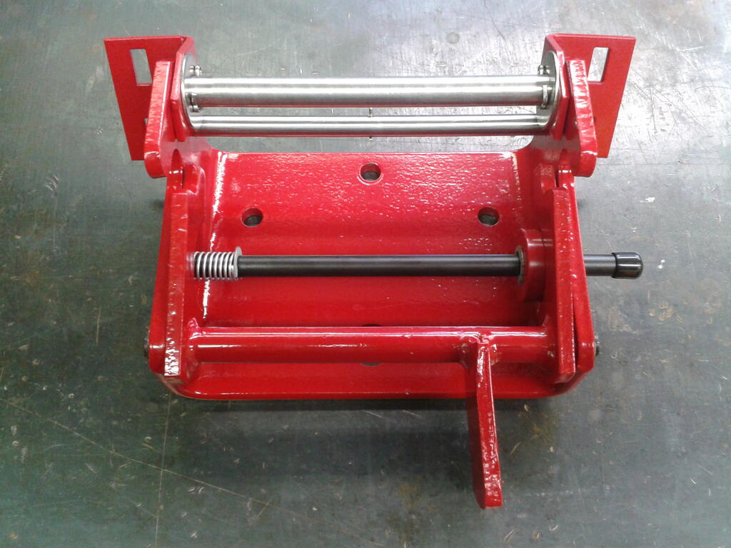

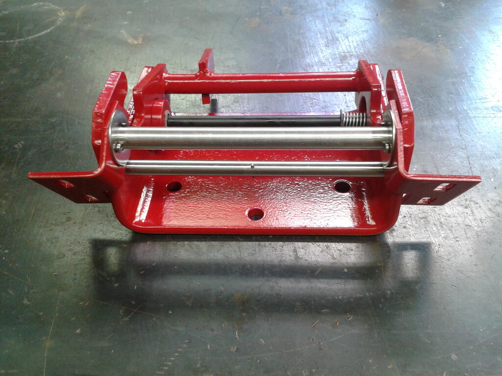

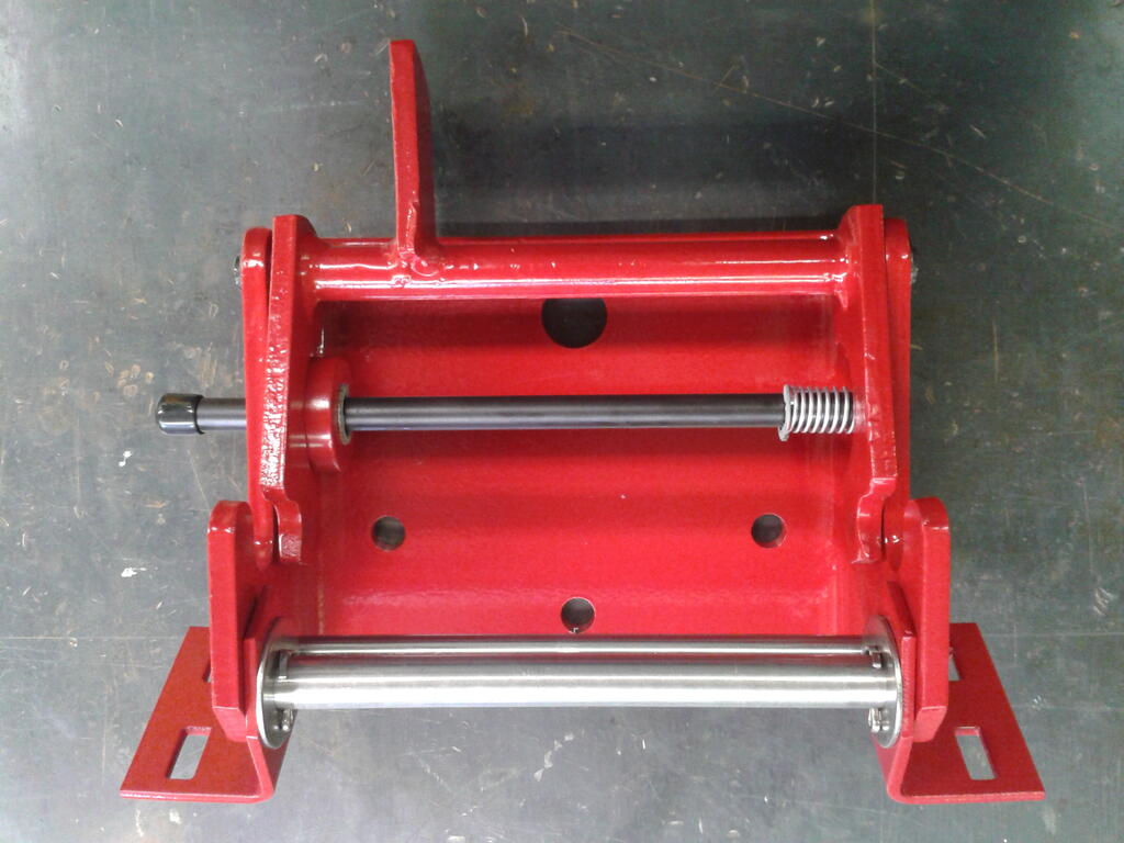

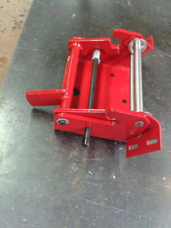

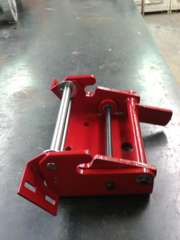

cleat 7,786 #16 Posted November 14, 2021 This is how I have some of mine rebuilt. I drilled the hood brackets and the front hitch to 1/2" then made up a new pin. I also made up a new hood stop pin with a 2 piece design to move the cotter pin in to the center where the hood does not contact it. Here are the plans for the pins. Oversize hood pivot pin.pdf Wheel Horse hood stop pin.pdf 1 Share this post Link to post Share on other sites
Handy Don 14,901 #17 Posted November 14, 2021 (edited) 1 hour ago, cleat said: This is how I have some of mine rebuilt. I drilled the hood brackets and the front hitch to 1/2" then made up a new pin. I also made up a new hood stop pin with a 2 piece design to move the cotter pin in to the center where the hood does not contact it. So you gave up having an easy way to remove the hood, right? Either dig deep to get to one of the cotters or undo all the hood-to-hinge bolts? Edited November 14, 2021 by Handy Don Share this post Link to post Share on other sites
Mustang67ford 234 #18 Posted November 14, 2021 3 hours ago, cleat said: This is how I have some of mine rebuilt. I drilled the hood brackets and the front hitch to 1/2" then made up a new pin. I also made up a new hood stop pin with a 2 piece design to move the cotter pin in to the center where the hood does not contact it. Here are the plans for the pins. Oversize hood pivot pin.pdf 28.56 kB · 1 download Wheel Horse hood stop pin.pdf 23.19 kB · 1 download Nice job. I'm thinking of doing something similar. Picked up a 3/8" rod. Need to get the hood bracket bushings. I was thinking of using hitch pin clip instead of cotter pins but really how often does the hood need removed. What paint did you use, that looks nice and shiny? Share this post Link to post Share on other sites
cleat 7,786 #19 Posted November 14, 2021 (edited) I used IH red implement paint from TSC. The black bits are Rustoleum high temp black. The shiny bits are all Stainless steel. The E clips and spring are done in bright galvanizing. I have never needed to remove a hood once the machine is completely restored (yet). I would rather everything be nice and tight to discourage the hood from moving and wearing things. Edited November 14, 2021 by cleat 1 Share this post Link to post Share on other sites
