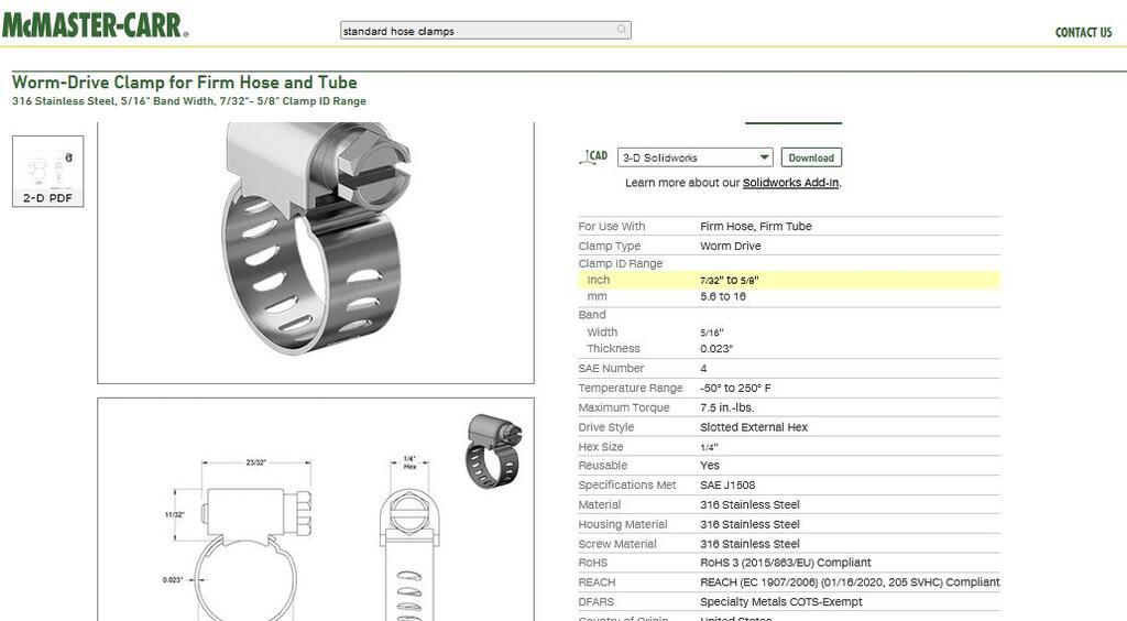

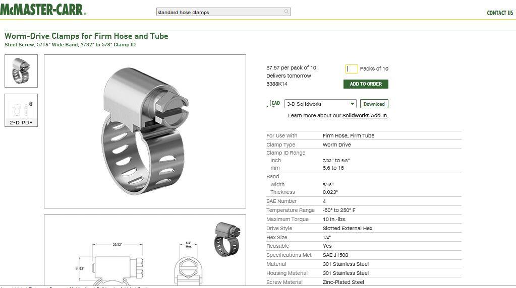

1940willys 138 #52 Posted November 23, 2021 McMaster Carr's discriptions really help in aiding a purchase. Notice that you can buy a Stainless Hose Clamp but the only thing Stainless is the Band. Where the 'Saddle and Screw Are Not! Many times in Automotive Situations I've had the Saddle pull away from the band and the worm screw just slip over the top of the Band.Probably just me over tightening and not what it was made of. Just something to think about the next time ya buy Hose clamps. Totally stainless are much more expensive. Will you be using them in a corrosive environment? Share this post Link to post Share on other sites

pfrederi 20,625 #57 Posted November 23, 2021 2 hours ago, ebinmaine said: I try to remember not to tighten those with a screwdriver because I have a lot better luck with a nut driver. I also very rarely remember to get the nut driver out.... So they almost always get tightened with a screwdriver anyway. Before you over muscle these things consider this info.. Interesting the plated screw can be tightened more than the stainless..... 1 Share this post Link to post Share on other sites
