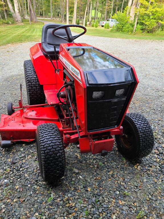

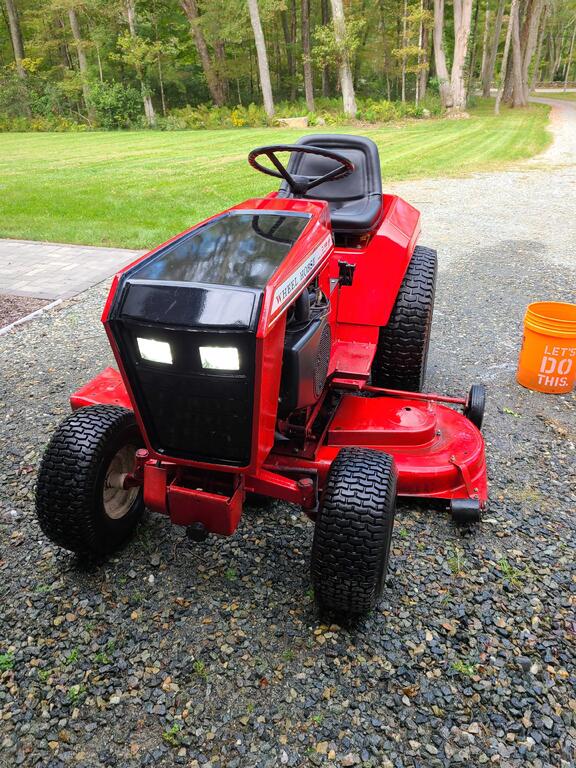

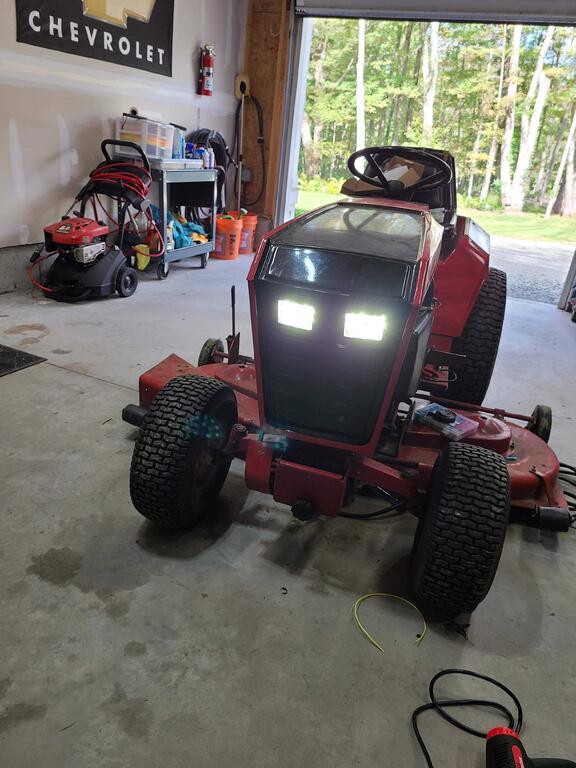

WH-Dave 7 #7 Posted November 11, 2021 I bought some PAR36 LED units off Amazon for my C195. Not stock looking for sure, but they work great. 3 2 Share this post Link to post Share on other sites
