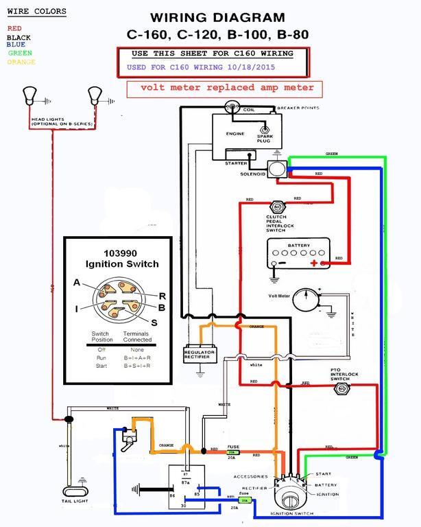

953 nut 63,029 #3 Posted November 10, 2021 @BOB ELLISON has a colored wiring diagram for the C-160 that should be like yours. The one change he made was the elimination of the "AMP" meter and replaced it with a colt meter. Bad amp meters have been a source of problems on lots of . Most of the connectors in your wiring use the Delphi Packard GM-56 terminals which snap into the plastic connector caps. They are very common in the USA and I suspect they were used in Europe too. 2 Share this post Link to post Share on other sites
gwest_ca-(File Mod) 11,846 #4 Posted November 10, 2021 There is a note at the bottom of the wiring diagrams about the black wires. Click on the fuzzy picture in the link to see the single-cylinder and twin-cylinder wiring. Click on them. Share this post Link to post Share on other sites
Jeff-C175 7,207 #5 Posted November 10, 2021 (edited) 2 hours ago, 953 nut said: diagram for the C-160 that should be like yours. That diagram shows a relay for the lighting circuit. The C-175 has no such relay... at least mine doesn't! And a voltmeter is wired very differently from an ammeter. The PTO interlock switch is also quite different. I don't see the seat interlock switch on that diagram either. Edited November 10, 2021 by Jeff-C175 Share this post Link to post Share on other sites
ebinmaine 75,769 #6 Posted November 10, 2021 6 minutes ago, Jeff-C175 said: That diagram shows a relay for the lighting circuit. The C-175 has no such relay... at least mine doesn't B and C doesn't either. Likely added in for electrical safety. Share this post Link to post Share on other sites
