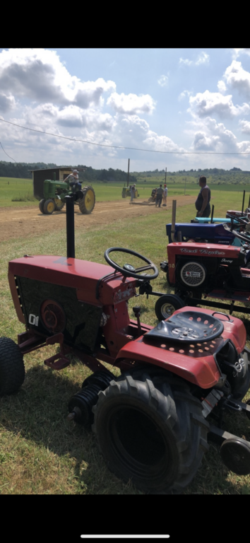

TJ5208 1,841 #1 Posted November 9, 2021 Can you take metal, and close in a engine, on one of these Wheel Horses like a big tractor? Share this post Link to post Share on other sites
8ntruck 8,154 #2 Posted November 9, 2021 They are air cooled. If you add sides to the hood, you will need openings to get cool air into the engine and the hot air out. You making a Wheel Horse for orchard duty? 1 Share this post Link to post Share on other sites
Handy Don 14,658 #3 Posted November 9, 2021 30 minutes ago, TJ salyers said: Can you take metal, and close in a engine, on one of these Wheel Horses like a big tractor? Got me curious. Sound attenuation? Looks? (or @8ntruck's orchard)? Share this post Link to post Share on other sites
ebinmaine 74,572 #4 Posted November 9, 2021 Seems I've seen a pic or two of similar in the past. It is an interesting look. Eye catching simply because it's different. As stated it can be done... The fan side and PTO side MUST be left open to have the ability to breathe. 1 Share this post Link to post Share on other sites
Stepney 2,354 #5 Posted November 9, 2021 Talking like a scatter shield, or aesthetics? Share this post Link to post Share on other sites
Sarthurs01 1,017 #6 Posted November 9, 2021 My puller use to until I went to a V twin.. it never ran for long periods of time so never had any problems with over heating. 1 Share this post Link to post Share on other sites
Snoopy11 5,720 #7 Posted November 9, 2021 If you are going to do this... I would cut a hole in the sheetmetal on the flywheel side and run a small electric fan... A 6 inch fan will do just fine... https://www.amazon.com/American-Volt-Electric-Radiator-Tractor/dp/B01E52MCS6 Don Share this post Link to post Share on other sites
TJ5208 1,841 #8 Posted November 13, 2021 just looks Share this post Link to post Share on other sites
