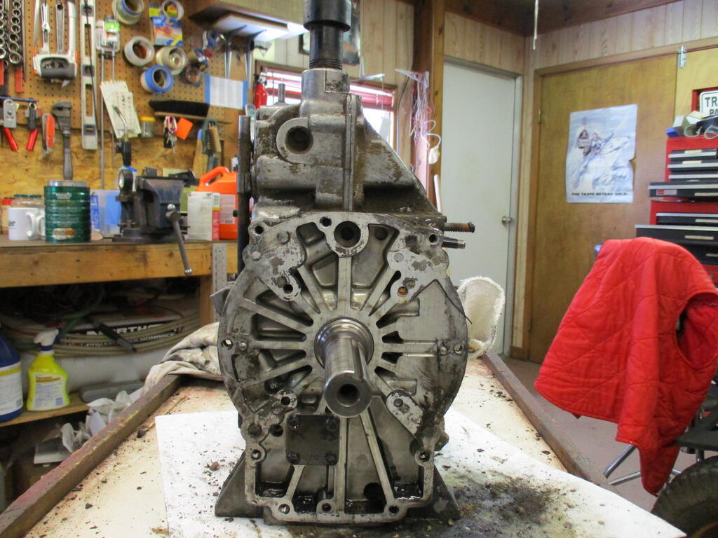

Howie 900 #1 Posted November 6, 2021 Guy brought me two engines this week. One is a Kohler Magnum 20, may have a bad rod. Second one is a 24hp Briggs vertical shaft. Has a hole worn it he block from rubbing on the mower frame. Going to JB weld that hole as long as the rods looks ok. Plugs in that one looked+ pretty good. The Kohler is a horizontal shaft engine, will pull side plate at some point to see what it looks like inside. Think it is a Series 2 has oil filter on it. 3 Share this post Link to post Share on other sites

pfrederi 19,886 #3 Posted November 6, 2021 All magnum twins have full pressure lube. bad news is you have to do a significant tear down to even see the rods. Pulling end plate doesn't reveal anything (see pic). To look at the rods you have to pull the jugs. Depending on age they may have a gasket or the may have just RTV sealant. To replace a rod you have to split the crankcase You will want to look at the Service manual. 2 Share this post Link to post Share on other sites
Howie 900 #4 Posted November 7, 2021 Have used JB weld to repair a number of cracks in blocks over the years. Not real concerned about that, not had one leak yet. On the Kohler don't know exactly when I will even look at it. Have worked on a lot of engines over the years just not one of these yet. Was looking at the closure plate on the PTO side of the engine, just want to see if anything is laying in the bottom of engine. May not work though. Share this post Link to post Share on other sites
