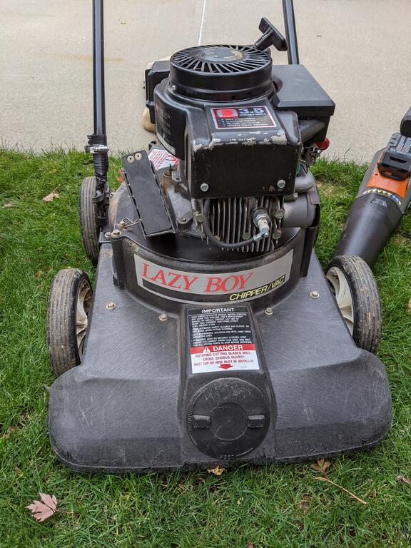

bigjooe 1 #1 Posted November 3, 2021 I have a lazy boy chipper vac 3.5 horsepower and my lower handlebar broke it's say it is no longer available any ideas or substitution 1 Share this post Link to post Share on other sites
953 nut 63,261 #2 Posted November 4, 2021 If you have a friend who is an electrician he could probably be able to make you a new handlebar out of EMT conduit. 4 Share this post Link to post Share on other sites
ZXT 2,401 #3 Posted November 4, 2021 Welcome to the forum! Any possibility of repairing it? Maybe slide a piece of pipe that's the correct diameter over it and weld it? Looks similar to most any push mower, but it might be a bit narrower than that. Can't speak for a new, exact replacement, but there are definitely ways to make something work. 3 Share this post Link to post Share on other sites
Achto 30,251 #4 Posted November 4, 2021 (edited) Slip a tube over it and weld it up. Edited November 4, 2021 by Achto 4 Share this post Link to post Share on other sites
ri702bill 10,732 #6 Posted November 4, 2021 Or drill a 3/8" hole in both pieces about a half inch from the break, slip a tube into it that is a decent tap in fit, and plug weld the holes to to tube. Did that on my Honda walk behind. Bill 1 Share this post Link to post Share on other sites
oldlineman 1,613 #7 Posted November 4, 2021 All sound like great ideas, EMT would be a god start. Bob Share this post Link to post Share on other sites
