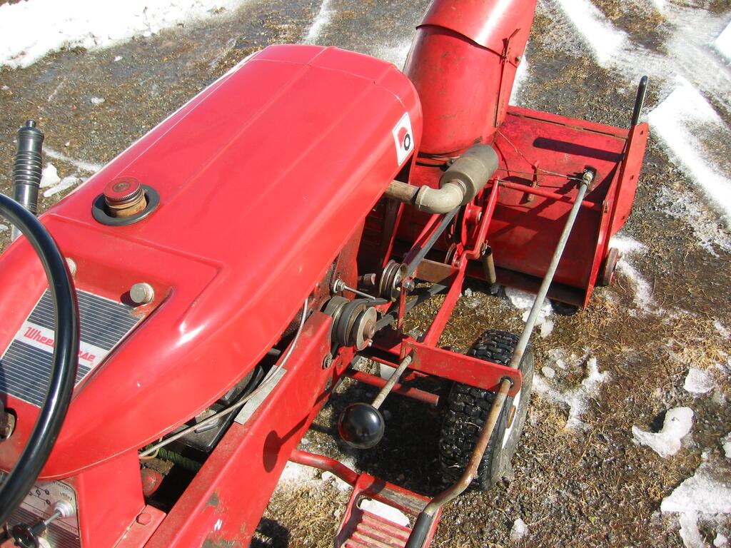

pfrederi 19,969 #3 Posted November 3, 2021 I ran a Snow blower on my L-107. Didn't work out well for me. I have a lot of driveway to clear. Up to 6 inch accumulation i plow. Faster and easier than blowing. Tried the ranger with a 7-8 snow fall the first pass is the problem. Even in first gear had to slip the clutch a lot to keep throwing and not choking/stalling.... Of course in subsequent passes you can take a smaller bite and not have to slip the clutch but it took too much time.... Love my Ranger and she did well plowing but not blowing...After all most walk behind blowers are 8+ hp and they do not have to drag me along... 2 1 1 Share this post Link to post Share on other sites

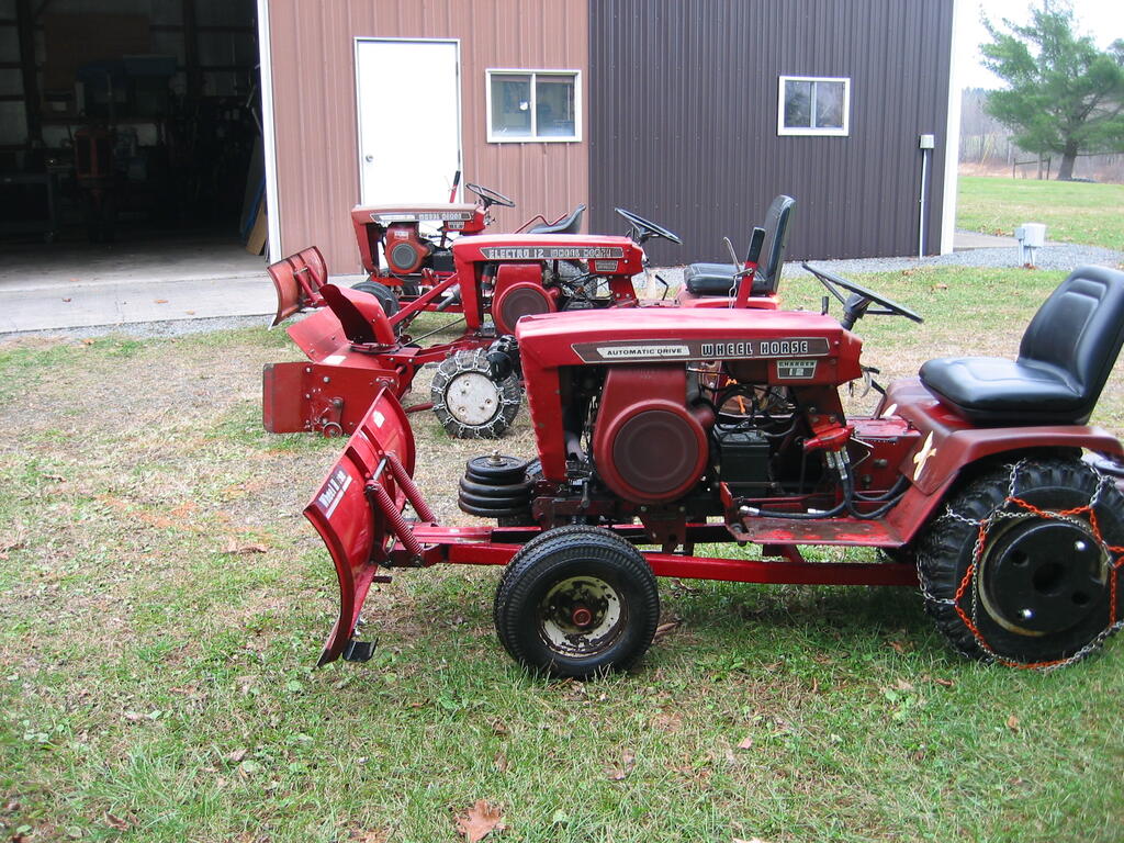

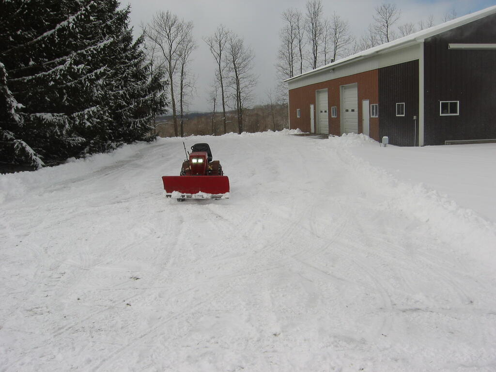

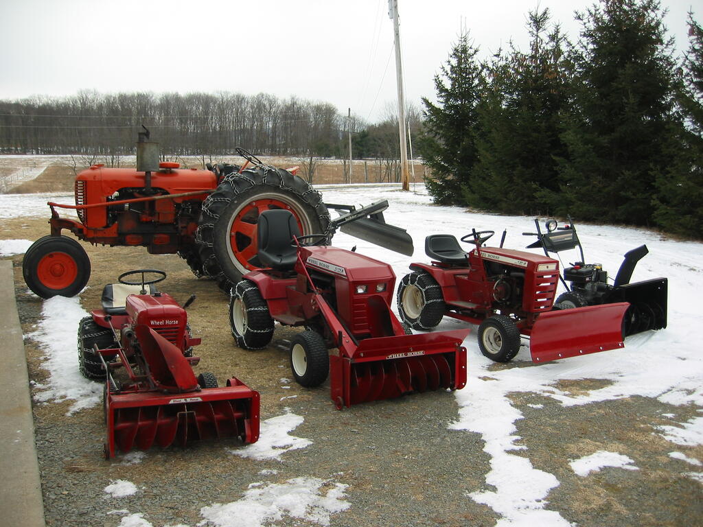

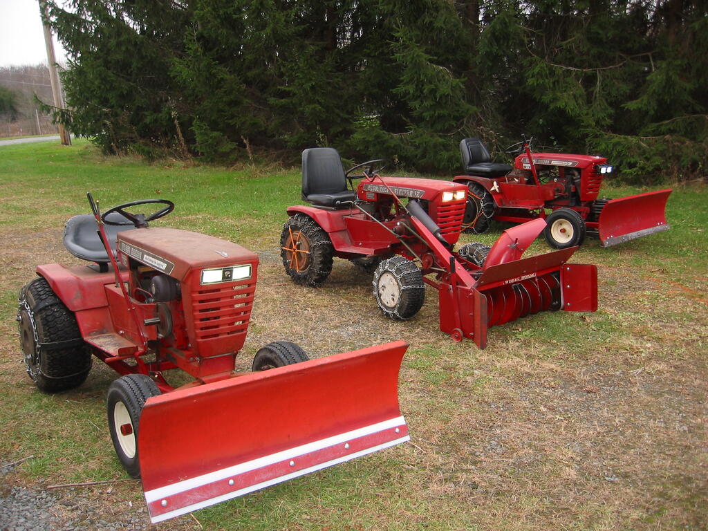

pfrederi 19,969 #6 Posted November 3, 2021 1 hour ago, Jim Turner said: That makes since, I am wanting to put mine on an 867. feel the lower ranges may help. I have read others comment that the plow works best in certain circumstances too. I could use my 877 with the plow and 867 with the snow blower. I have other tractors like a 1276 that would work better with a snow thrower. I just want to experiment and see what works best with each machine. You have a very nice collection of tractors. Thanks. It is an old picrture. Over the last 20 years I have been refining my snow removal fleet and for my work a hydro is the answer for plowing or blowing. Fast reverse for plowing and ability to get the right feed rate for blowing make hydros the clear choice,. (The big tractor and back blade haven't been used for several years now nor has the walk behind). I have two charger/electro 12s set up for plowing. One is getting 54 inch blade this year (the other has rubber chains and plastic plow edge for a short stretch of pavers). For several years I had an Electro 12 for blowing but a couple years ago gave her a 16hp engine. The 12 worked OK with the 16 I can go a bit faster in heavy snow... (Winter seat time is not something I look forward to ) 1 2 Share this post Link to post Share on other sites
