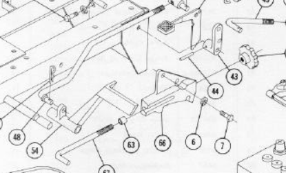

Gregor 4,847 #3 Posted October 31, 2021 to Clutch/brake pedal # 54 in diagram. Rod # 48 This manual may help. Share this post Link to post Share on other sites
