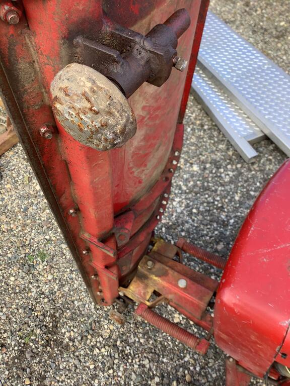

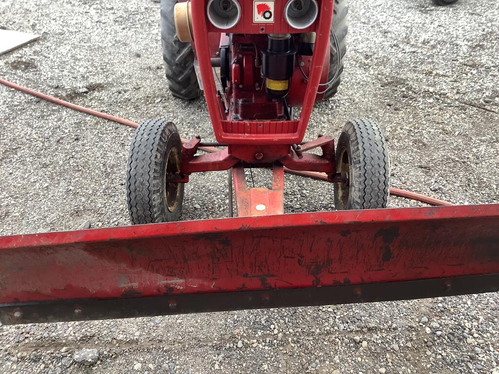

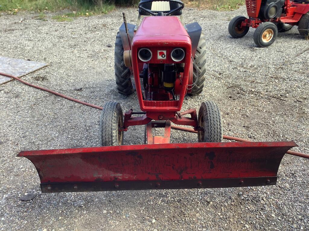

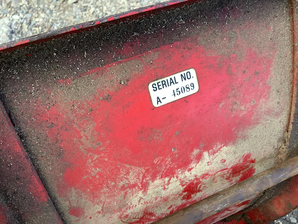

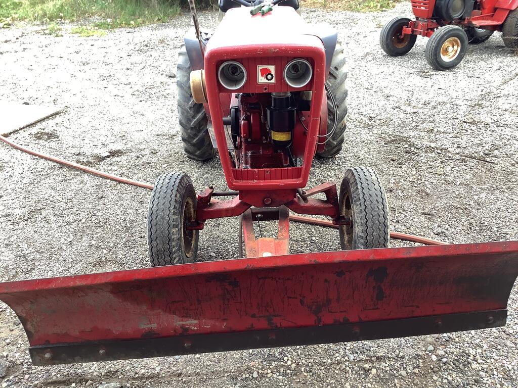

Pullstart 68,266 #1 Posted October 28, 2021 This plow (Serial A-45089) came along with Chloe the 953 a couple weeks back. What a sweet runner! Hooking it up today, I noticed it’s crooked. I tried to loosen top/tighten bottom of the plow bracket on one side, opposite the other, with no real change. I figure I’m off about an inch over 4 feet. My plan now is to use shim stock on the axle bracket short side to push the mounting point forward. 4 4 Share this post Link to post Share on other sites

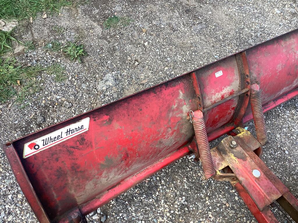

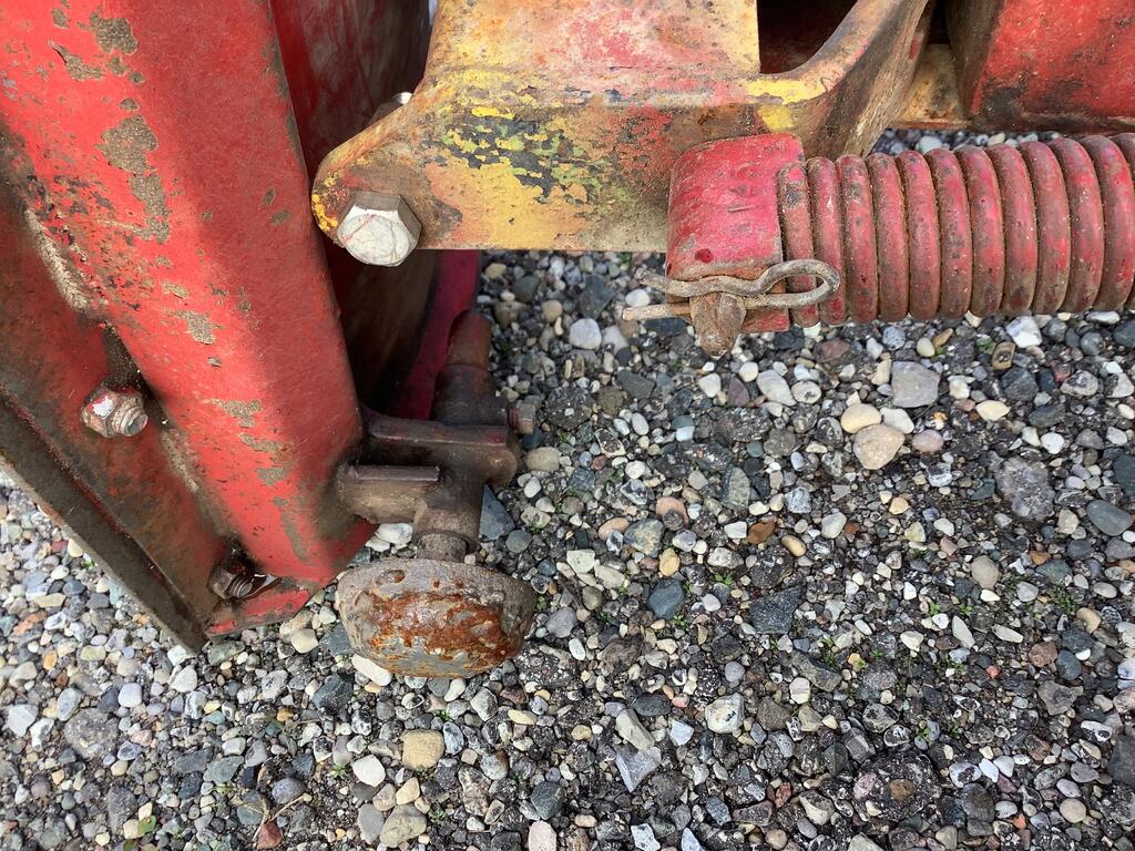

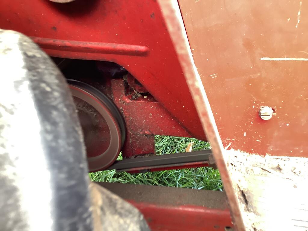

Pullstart 68,266 #2 Posted October 28, 2021 Check out the welded up feet on this blade! 3 1 Share this post Link to post Share on other sites

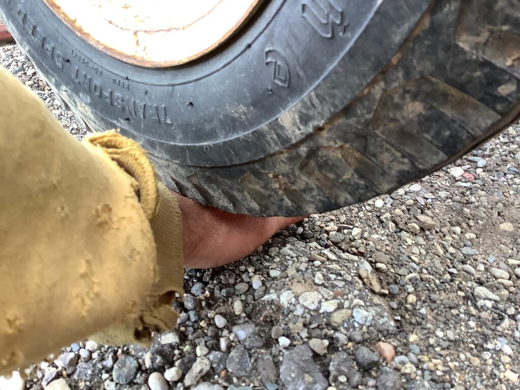

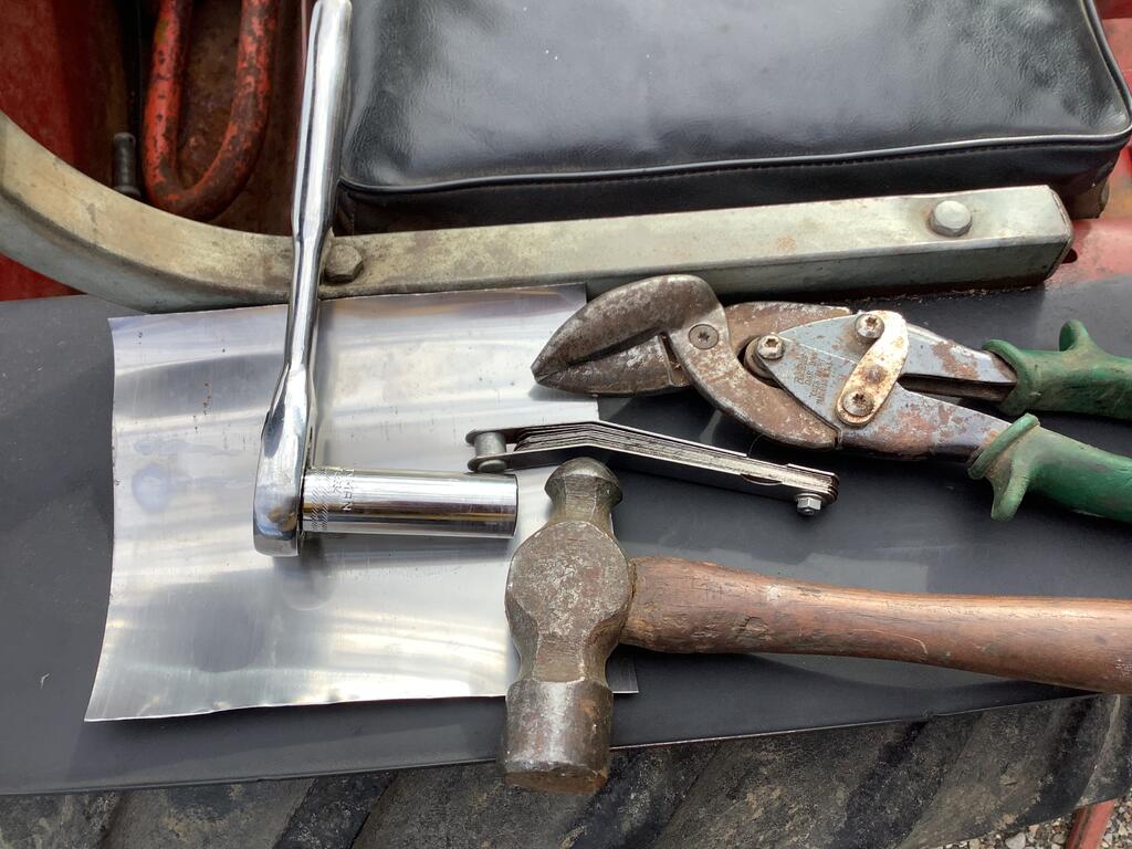

Pullstart 68,266 #3 Posted October 28, 2021 (edited) Armed with some .005” shim stock, snips, feeler gauge and some hand tools, I’ll loosen the right side, center it up and measure the gap… then cut and fold the shim stock accordingly. Edited October 28, 2021 by Pullstart Picture 2 Share this post Link to post Share on other sites
Pullstart 68,266 #4 Posted October 28, 2021 I’m up to .070” of folded shims with little change. I’m sure if I drew the problem out on paper, I’d be able to tell how far the bracket needs to move. I must say though, the hydraulic lift and down pressure is awesome! 2 2 Share this post Link to post Share on other sites
Pullstart 68,266 #5 Posted October 28, 2021 Finally folding the stack one more time got me squared away. .140”! 2 1 Share this post Link to post Share on other sites

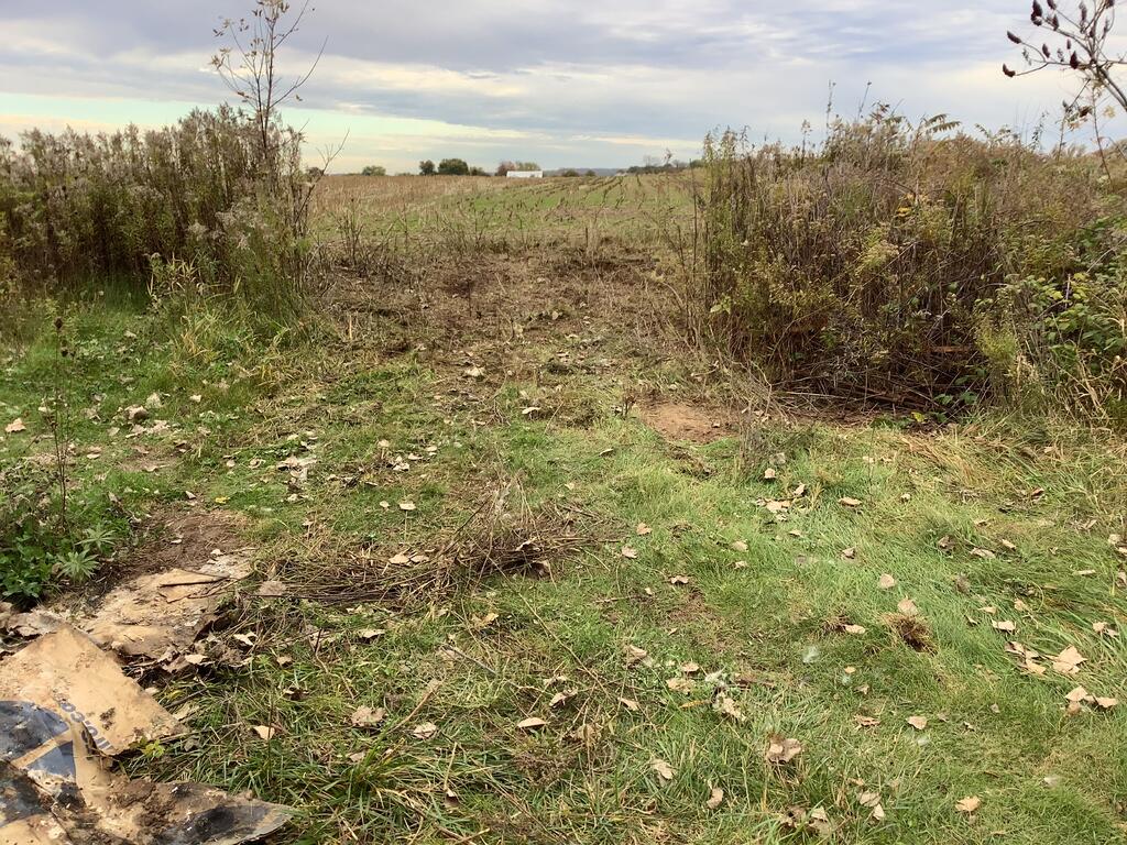

Pullstart 68,266 #7 Posted October 28, 2021 (edited) To test it’s capabilities, I opened up a farm access / drive in front of the storage barn’s overhead door. That’ll help with getting the camper inside for winter. Verdict? AWESOME except I surely need weight and chains! Edited October 28, 2021 by Pullstart 2 2 Share this post Link to post Share on other sites

8ntruck 8,168 #13 Posted October 29, 2021 Is it possible there is some twist in the A frame? The 48" plow I just picked up has a similar tilt issue. Have not looked into it yet..... Share this post Link to post Share on other sites

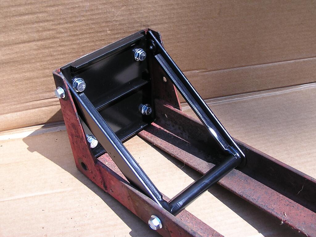

ri702bill 10,094 #14 Posted October 29, 2021 (edited) Kevin: I know that the 953 uses a different frame than the short frame (502 style) or the long frame (C series), BUT..... You need to check the condition of 2 items before working that little beast hard. Inspect the frame plate where the four 3/8" cap screws bolt to the unidrive - if any of the holes in the frame are cracked out, you need to gouge the crack(s) with an angle grinder and weld them back up. Inspect the cast iron lower steering mount to see if it is still in one piece - one ear may be broken off, Hope your frame does not look like this one - the tractor it came from wiggled like an inch worm on uneven ground! Bill Edited October 29, 2021 by ri702bill 1 Share this post Link to post Share on other sites

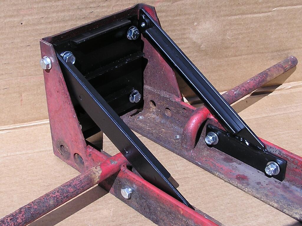

ri702bill 10,094 #15 Posted October 29, 2021 (edited) Also, a little some thing I whipped up over the summer - frame reinforcing plates and diagonal frame braces for the short and long frames - uses existing holes in the frames - need to install both before it snows.... Edited October 29, 2021 by ri702bill 1 1 1 Share this post Link to post Share on other sites
Pullstart 68,266 #16 Posted October 29, 2021 @ri702bill I thought about that, but the tractor is straight and true and the rear wheels point in the right direction. I’ll likely check it, but you’re correct… these frames are much tougher than the “smaller” tractors and I have fixed my fare share of them too. 1 Share this post Link to post Share on other sites
Pullstart 68,266 #17 Posted October 29, 2021 6 hours ago, 8ntruck said: Is it possible there is some twist in the A frame? The 48" plow I just picked up has a similar tilt issue. Have not looked into it yet..... I didn’t inspect it too thoroughly, but I noticed a slight dip in the plow left to right. I would imagine damage worth .140” of shim work would be more noticeable. Share this post Link to post Share on other sites

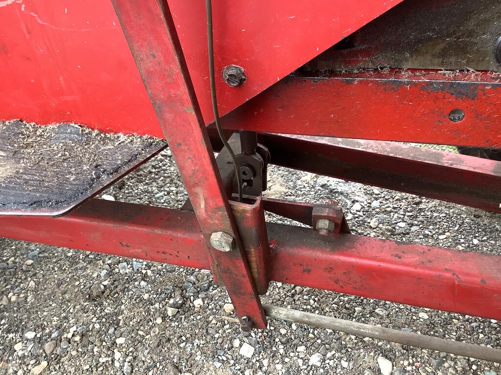

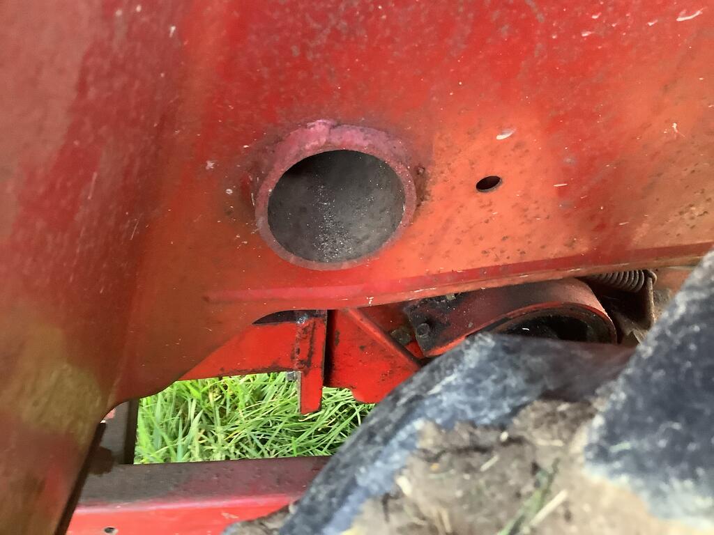

Pullstart 68,266 #19 Posted November 4, 2021 On 10/29/2021 at 1:20 PM, 953 nut said: That plate on the 953/1054 is 3/8" thick steel, doubt that it will be a problem. It might even be 1/2” @ri702bill here are pictures of the frame at the transmission mount. It’s good-n-tite. 2 Share this post Link to post Share on other sites
