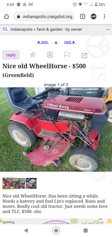

Ukfan1977 7 #12 Posted October 25, 2021 Let's use this one for example. That's going to do everything I need? Pull the plow. And run the tiller? 1 Share this post Link to post Share on other sites
Maxwell-8 4,371 #13 Posted October 25, 2021 3 minutes ago, Ukfan1977 said: Let's use this one for example. That's going to do everything I need? Pull the plow. And run the tiller? For sure, do keep in mind it's a Hydro, most people like a tiller with a manual transmission as the tiller pushes the tractor forward and parts for that Onan 2 cilinder are getting harder to find 1 Share this post Link to post Share on other sites
Ukfan1977 7 #14 Posted October 25, 2021 Glad I ask. So no hydro and be careful of the Onan engine Share this post Link to post Share on other sites

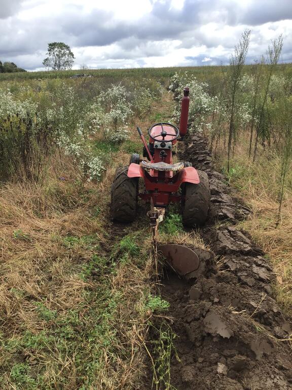

Pullstart 69,220 #18 Posted October 26, 2021 Even that 12 hp engine in the 312 will pull plenty of plow… Here’s my “Putt Putt” pulling either a 10” or 12” plow on more than one occasion. It’s an 8 hp rig with a C series transmission. 1 Share this post Link to post Share on other sites

Handy Don 16,052 #21 Posted October 26, 2021 3 hours ago, Pullstart said: Even that 12 hp engine in the 312 will pull plenty of plow… Here’s my “Putt Putt” pulling either a 10” or 12” plow on more than one occasion. It’s an 8 hp rig with a C series transmission. Just be aware that what @pullstart is struggling to find as he stares at the ground is any sign of a rock! I've heard there are parts of Ohio that are low on rocks, but pulling a deep plow through rocky soil could be a very slow go on a 12. 1 Share this post Link to post Share on other sites
