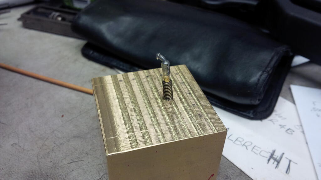

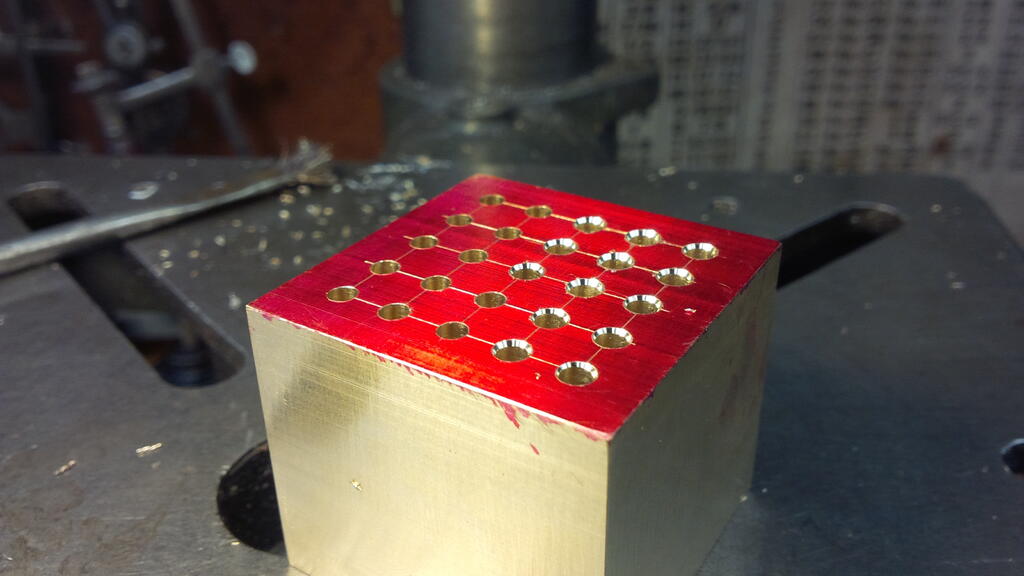

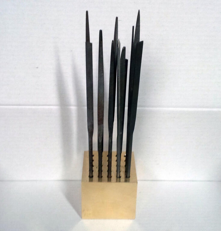

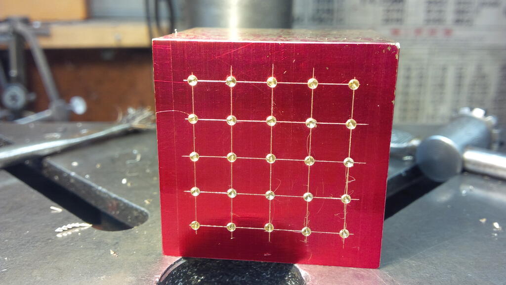

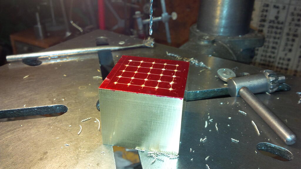

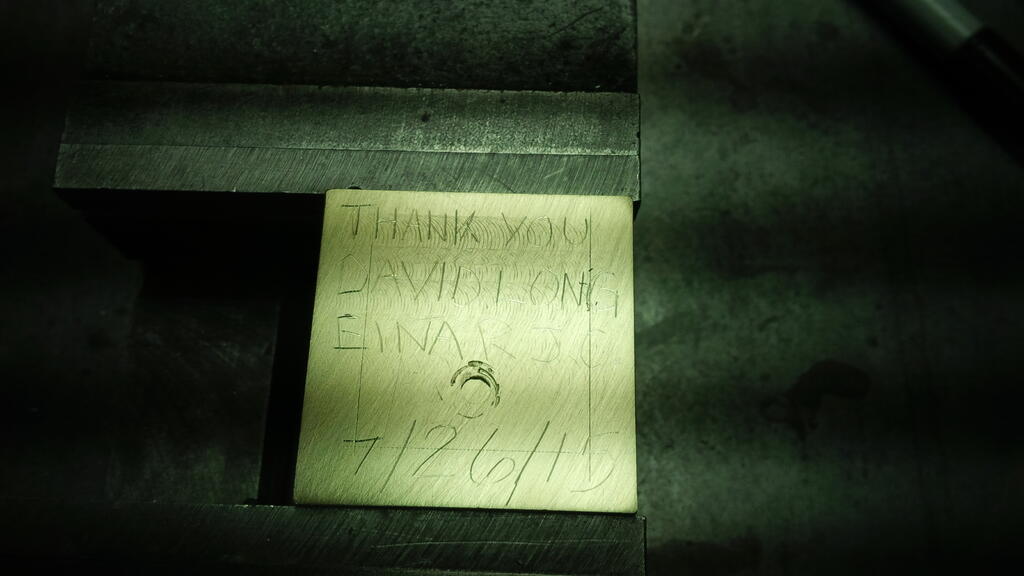

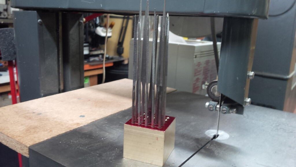

echris 1,426 #1 Posted October 25, 2021 While going through some old shop photos tonight, I came across this. Back in 2015, Grandpa Uncle (I ain't giving you nothing I don't have 10 of™ ") Dave next door saw my meager needle file collection. He came over to my place with a handful of all sorts I didn't have and says, "Do you have a block to store them in?" I did not, so we want back to his place. He hunted around his various "make-from" piles and came up with a beautiful, although caddy-whompus chunk of brass. We then spent a few hours squaring up the brass block on his mill, Dave showing me all sort of tricks for making a rhombus into a perfect cube. (Pretty sure I've forgotten most of his tricks) Some math, Dykem, a ruler, and a scribe later and all the holes are marked with a punch, then touched off with a drill bit. Bonus points for finding the hole I slipped with the punch. There was a hole in the back side of the block, so I threaded it and inserted/epoxied this unholy brass screw that I have no idea where it came from and sawed it off. Then drilled and counter sunk the holes. Mmm shiny brass counter sinks... Test fit up Always sign tools when a good friend helps you out. Having your needle files in a block you can't knock over, right within reach on your benchtop makes you use your needle files all the time! 6 2 1 Share this post Link to post Share on other sites

Ed Kennell 45,305 #3 Posted October 25, 2021 18 minutes ago, echris said: Bonus points for finding the hole I slipped with the punch. Bottom center. 2 1 Share this post Link to post Share on other sites

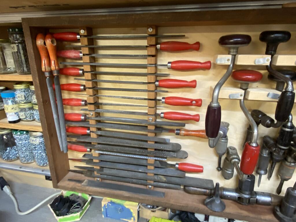

echris 1,426 #4 Posted October 25, 2021 5 minutes ago, Ed Kennell said: Bottom center. Sssh, don't tell anyone, you'll ruin it! This was one of those Uncle Dave experiments where he teaches you some stuff about machining, but what he's really teaching you is the correct way to store this specific tool so it's always handy and easy to store, and how to make that storage. This guy has a ~2000 sq ft basement, all shop, and has mastered the skill of cramming every possible tool, hardware, metal stock, plastic stock, resistors, capacitors, blocks of carbon (I don't know why either, but he has them. ha), lathes, drill presses, milling machines (including an '80's CNC Bridgeport), quite literally almost anything you could want to do a project either mechanical or electrical, and for the most part, you can easily find what you're looking for. There's been more than one occasion over the ~20 years I've lived here where he was out of town and I had a need, so I raided his shop and wouldn't you know it, there was the block of carbon I needed right in the box labeled "Carbon". It's kinda frightening. And exciting too. I have the best "Hardwork" store ever, and it's right next door to me. And in comes with an expert on all topics. I'm a lucky man. Any of you locals, we should arrange a tour of Grandpa Uncle Dave's shop. Nary a WH in site, but it should be a museum of everything we need to do stuff. No lie. 4 1 Share this post Link to post Share on other sites

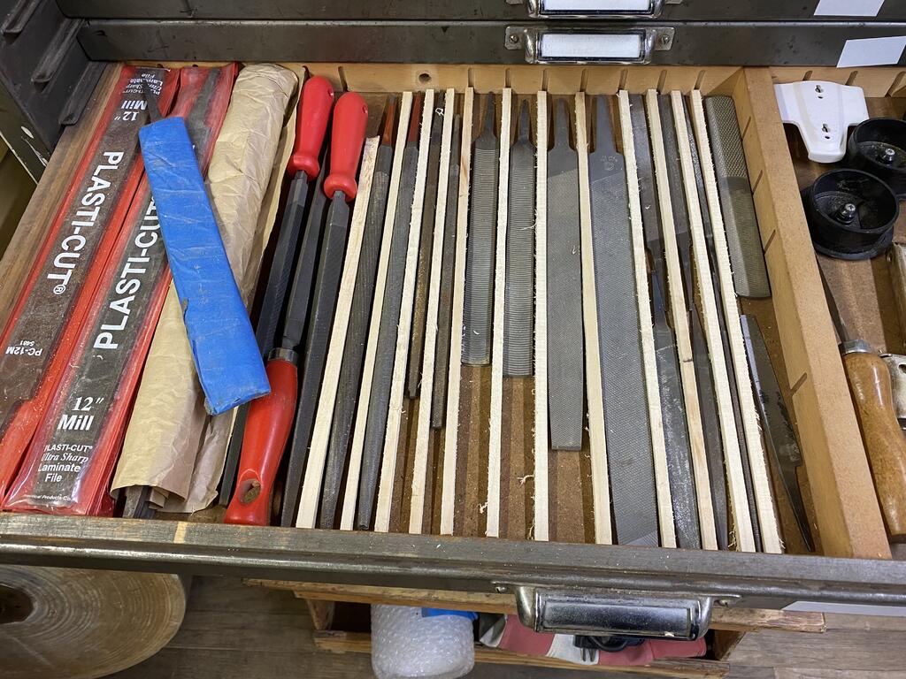

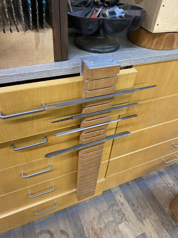

formariz 12,358 #8 Posted October 26, 2021 (edited) 4 hours ago, echris said: You DO NOT just throw your files in a $&%&# drawer! " They can be really troublesome to store particularly when one uses a lot of them and they are large. I even use a sort of “caddy” to keep them when in use so I just don’t place them on bench . It’s designed so I can hang it on any 3/4” edge such as a drawer front. Edited October 26, 2021 by formariz 1 Share this post Link to post Share on other sites
