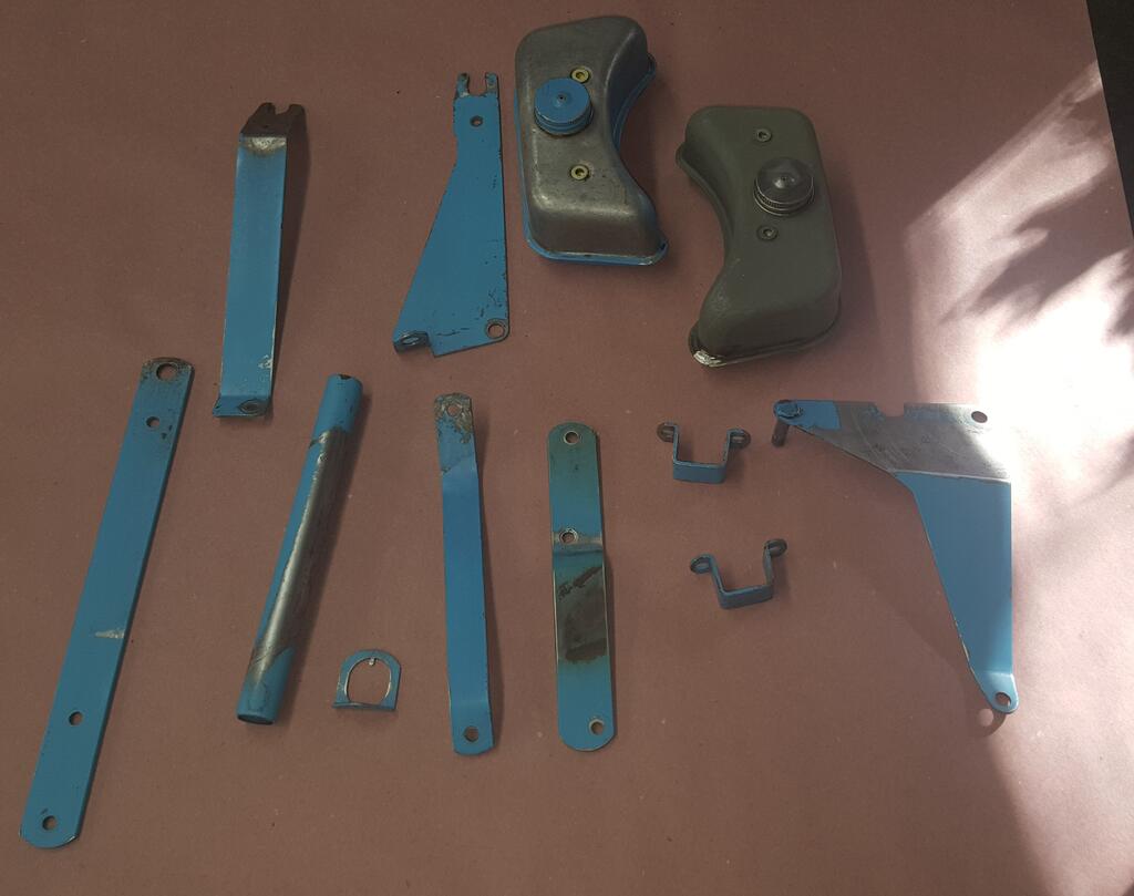

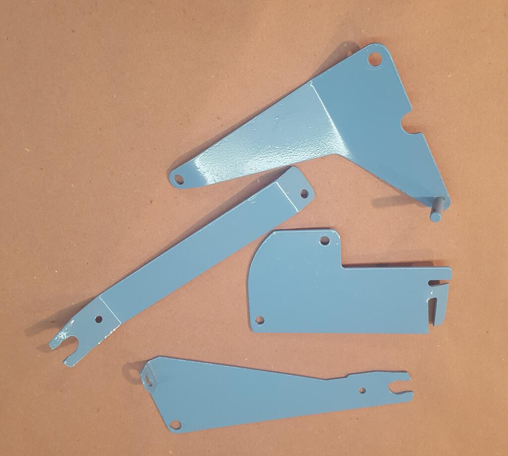

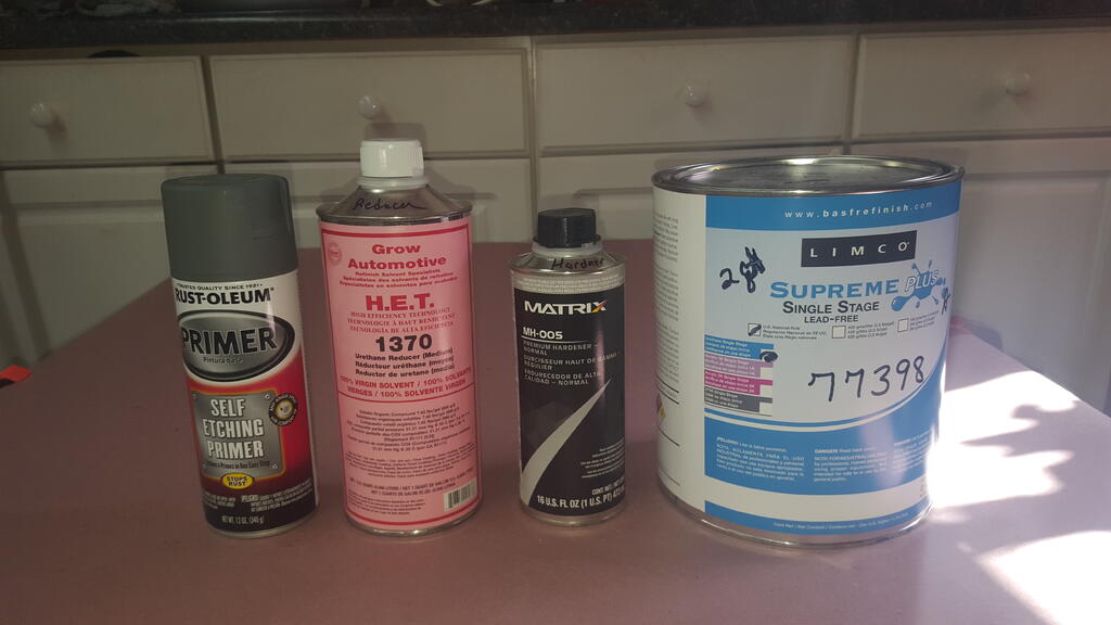

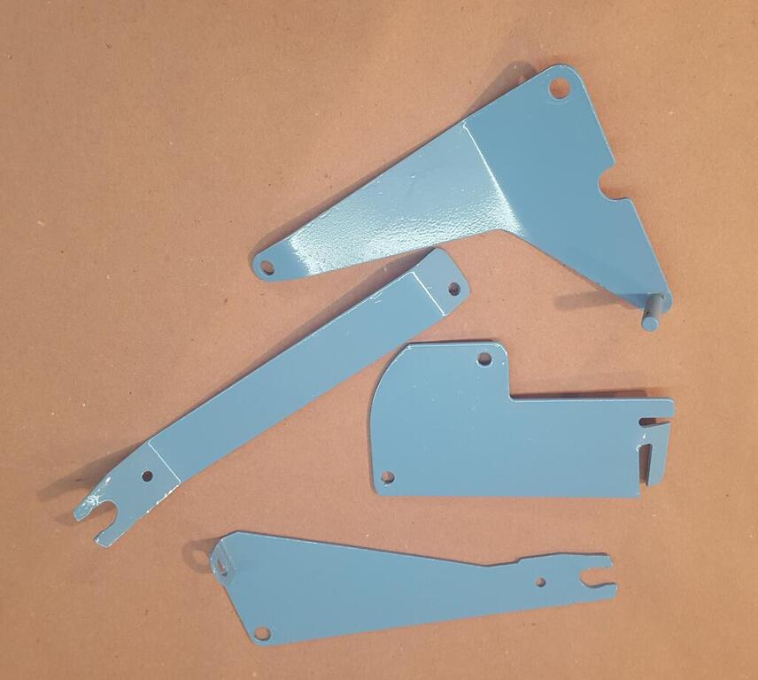

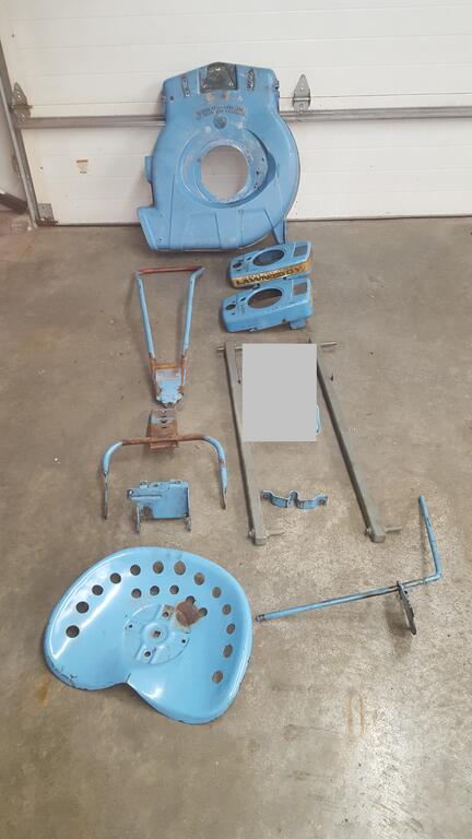

Gregor 4,847 #1 Posted October 23, 2021 (edited) This is not about painting a Wheel Horse per se, it’s just about painting. I read something on this forum a while back about painting with a Preval spray system. I thought I ought to try it out, so I did. I took my Lawn Boy Loafer apart, and took all the larger pieces to a local auto body man. I then took it all to the media blaster to get blasted. I kept some small parts to paint myself, using single stage automotive paint, and the Preval sprayer. My painter told me what type of paint to get, and where to get it. It was an auto body supply center. The woman there was very knowledgeable. She told me what I needed, and how to mix it. It was a single stage paint, mixed 4-2-1. 4 parts paint, 2 parts reducer, 1 part hardener. I mixed, 8 oz. of paint, 4 oz. of reducer, and 2 oz. of hardener. This gave me 14 oz. of product to spray, which was about 3 times as much as I needed for the parts I had. These are the products I bought, and the primer I used. The videos I watched suggested using a light colored primer for red or blue paint, but I have always liked this primer, so I used it for this also. Total paint and supplies cost, not including primer and sprayers, $202. Time will tell if it was worth it. The Preval sprayer was also available at the auto body supply center, cheaper actually than the, “Jungle Book.” About $8,00 My painter told me to get 2 quarts of paint. I thought that was a lot, but I did it. After mixing 1 quart per instruction, you actually end up with 56 oz. of product to spray. (if I have my numbers right). 2 quarts = 112 oz. That’s 8 typical rattle cans. I think that is more than enough for this mower. I didn’t turn my entire garage into a paint booth this time, but I did cover the floor. I’m glad I did, these sprayers put out a lot of paint with the push of the button. More than I am use to with rattle cans. The conditions in my garage were 72 degrees, 35% humidity. The door was opened occasionally for air! The paint was dry to the touch in 1 ½ hours. From what I have read, single stage paint should be left to dry for 18 hours. I suppose this would depend on the paint, and the amount of hardener used. When spraying with rattle cans it’s often mentioned how important it is to maintain a “wet” look. This seems to be easier to do with this paint, to me anyway. Tomorrow or the next day, I will post pics of the finished pieces. Edited October 23, 2021 by Gregor 1 Share this post Link to post Share on other sites

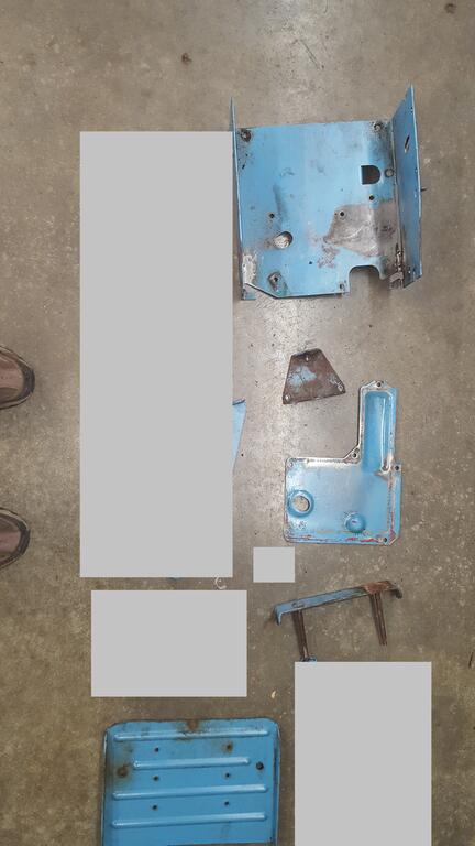

Gregor 4,847 #7 Posted October 24, 2021 (edited) In one of the videos I watched, it explained that clear coat was not necessary, because this paint has hardener in it. It went on to explain that this paint could be clear coated, which would aid in the protection against UV, and scratches. I lightly sanded one piece, and clear coated it. I really couldn't tell any difference after. One of the reasons I opted for this system was the ability to have a color mixed to my liking. After searching a long time for a rattle can paint that would match my Lawn Boy, I never found anything I liked. This was custom blended, and matched perfectly. Since painting these pieces, I think I will go ahead and paint everything myself. It doesn't seem to be too hard to do, and besides, my paint guy quoted $400 to $500 to paint the following parts, with my paint. I thought that was high. Edited October 24, 2021 by Gregor 1 Share this post Link to post Share on other sites
