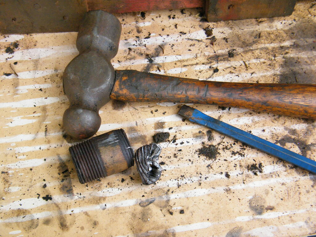

stevasaurus 23,617 #13 Posted October 22, 2021 TJ, you could put a chisel on it the way it is and have it out in 1 1/2 minutes. Really easy and the best way to do it. 3 Share this post Link to post Share on other sites
Snoopy11 5,731 #14 Posted October 22, 2021 Just now, stevasaurus said: TJ, you could put a chisel on it the way it is and have it out in 1 1/2 minutes. Really easy and the best way to do it. Oh yes, not arguing with you, Steve, I did see your comment above... I just gave input, in case the chisel idea did not work... (I would not cut anything... that close to the engine... for fear of metal shavings... but that is just me... Don 1 Share this post Link to post Share on other sites
stevasaurus 23,617 #16 Posted October 22, 2021 The thing about those nipples, they are usually so thin that a pipe wrench can collapse the metal and rip it and still leave the threads in the engine. When you use the hammer and chisel method, you collapse the threads in the engine enough that they break loose and turn right out. 3 2 Share this post Link to post Share on other sites
