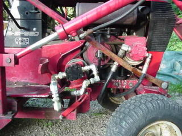

wallfish 18,821 #3 Posted October 21, 2021 (edited) Off the top of my head it seems the best option for a PTO setup on that tractor is probably this type. Scroll down through the pics. The long bar handle provides the tension to compress the pulleys to the engine. Simple design and no funky linkage required. Fairly easy to adapt as well https://www.wheelhorseforum.com/topic/1207-1966-1076/ This type of deck ( same type originally used on your tractor) uses a foot pedal to engage it so it can be run off the PTO pulley and engaged separately than the hydraulic pump. https://www.wheelhorseforum.com/topic/60740-1967-rm-367-rear-discharge-deck/ The pump can be powered off the second pulley on the PTO. Engaged all the time but if you have hydraulics for lifting implements and such then you probably want it running all the time anyway. I run 2 separate pumps. One for the FEL and the second for a back hoe. They could run off a single pump but I wanted to keep both implements completely separate and independent of each other. Another option for hydraulics is a self contained unit like a HY3 kit which was an add on option for the old tractors. Pump, reservoir, valve etc all in a small single unit. https://www.wheelhorseforum.com/topic/90125-hy3-pump/?tab=comments#comment-915600 Searching through the pics in the picture gallery can potentially set off the "light bulb" for ideas Edited October 21, 2021 by wallfish 1 2 Share this post Link to post Share on other sites
