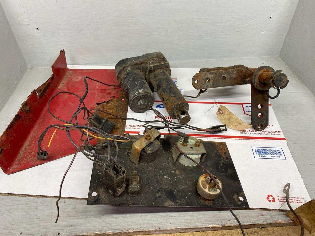

WheelhorseBob 1,550 #5 Posted October 17, 2021 I’d find an electric lift by yes they are pricy. Mine seems quick to me? I know someone with a couple nos one but they wouldn’t be cheap. Pic of extended tin and bracket. No idea about the rock shaft as I acquired this wit the electric lift installed. Share this post Link to post Share on other sites
Handy Don 15,997 #6 Posted October 17, 2021 51 minutes ago, WheelhorseBob said: I’d find an electric lift by yes they are pricy. Mine seems quick to me? I know someone with a couple nos one but they wouldn’t be cheap. Pic of extended tin and bracket. No idea about the rock shaft as I acquired this wit the electric lift installed. A member had one in the classifieds a while back. Share this post Link to post Share on other sites

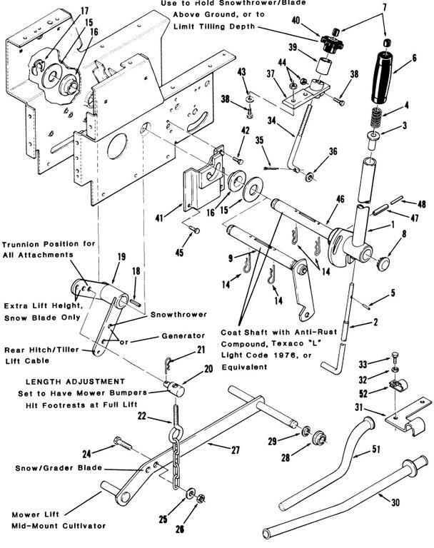

953 nut 64,275 #8 Posted October 31, 2021 On 10/16/2021 at 12:10 PM, Stubby said: I am trying to get him to just buy another tractor with a hydraulic lift. Too much work involved in changing out the rock shaft! Looks simple in the drawing, just put part# 9 in place of #46 but the factory didn't use anti-Rust and the two parts and they will be brown welded together. Share this post Link to post Share on other sites

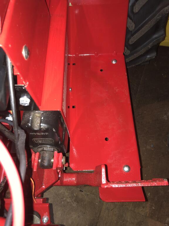

echris 1,426 #10 Posted November 1, 2021 15 minutes ago, 953 nut said: Too much work involved in changing out the rock shaft! Looks simple in the drawing, just put part# 9 in place of #46 but the factory didn't use anti-Rust and the two parts and they will be brown welded together. I did the conversion on my Dad's and it was a bigger job than I expected. Even though it was only a few years old at the time. 14 minutes ago, Handy Don said: As far as I know, only one model of electric lift. Others are grunt (manual) and ahhhh (hydraulic). If you look at the pics above from @WheelhorseBob and then the classified link you posted above @Handy Don, the electric motor is definitely different. My Dad's kit was the one with the large rectangular electric motor like WheelHorseBob. The one in the classifieds is different. Curious! Anyone know the difference? Share this post Link to post Share on other sites
Handy Don 15,997 #11 Posted November 1, 2021 1 hour ago, echris said: I did the conversion on my Dad's and it was a bigger job than I expected. Even though it was only a few years old at the time. If you look at the pics above from @WheelhorseBob and then the classified link you posted above @Handy Don, the electric motor is definitely different. My Dad's kit was the one with the large rectangular electric motor like WheelHorseBob. The one in the classifieds is different. Curious! Anyone know the difference? The angles of the photos in the classifieds and from @wheelhorsebob differ in a way that makes it hard to see that those actuators are the same. In the classified, you are looking at the side with the gearbox at the right side and the stationary pin to the right. In the above shot, you are looking down at the top of the gearbox with the stationary pin below coming toward the viewer. 1 Share this post Link to post Share on other sites
echris 1,426 #12 Posted November 1, 2021 You're right, it is the same. Good catch. Share this post Link to post Share on other sites
