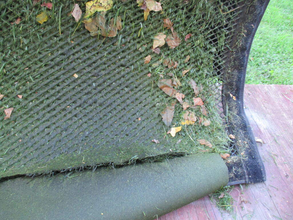

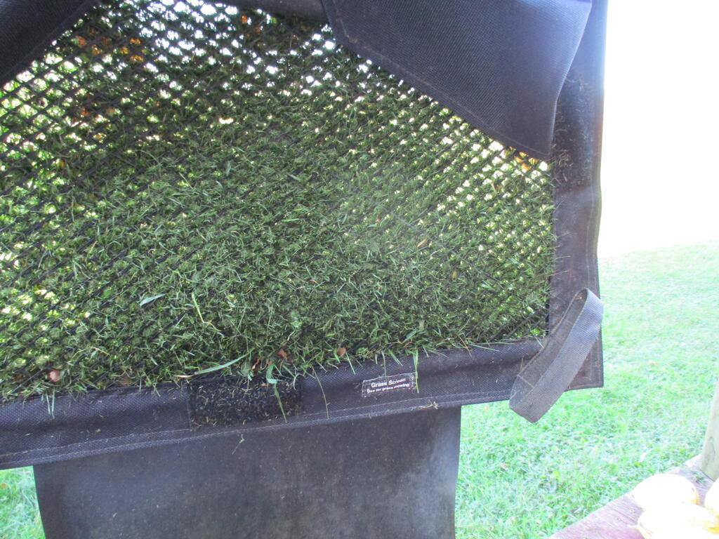

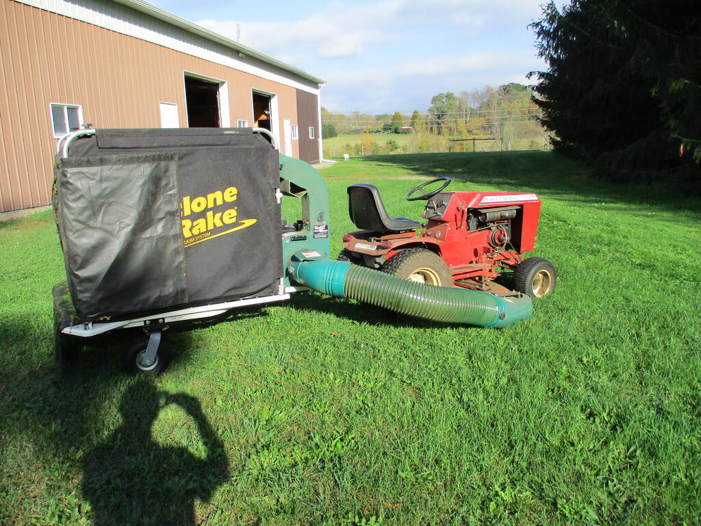

pfrederi 18,670 #1 Posted October 14, 2021 Has been a most unusual year for grass. My lawn is greener and lusher now than most years best in spring. Infrequent mowing due to frequent rain has exacerbated the problem. Since it was time to get the Cyclovac out to be ready for leaves I put the grass screen on and did some mowing. It works well but there are couple of issues. First damp green grass is HEAVY. Even with the unit only about half full she was pushing the C175-8 around especially on hill and turns. May have to rig some addition l front weights on the WH. Tilting it up to dump was a real effort. The biggest issue was how fast the grass screen clogged up. The first time (no picture) the screen was completely packed tight after mowing only about half the front yard. The pic here is after only a third. They provided a small brush to clean the screen which has worked out OK on leaves but totally ineffectual on packed grass. Finally removed the screen and took the air compressor to it. That worked but you have to do it frequently. I have to stop and clear it when the unit is only about 25% full (does make dumping easier).. Anyone have any other ideas on how to make it more efficient/easier??? Share this post Link to post Share on other sites

Skipper 1,789 #4 Posted October 14, 2021 This is interesting To help it get rid of air, I would suggest more venting in the roof section, up towards the tractor. That would slow the airspeed of the air on it's way out. Hopefully leaving more of the debris in the bin, instead of in the screen. How is the clogging in the tube and in the impellers etc? I have a plan for a giga "bagger" for the 3pt on the drawing board, so I will suck up any info with great appetite. Here the grass is most often thick and moist. Not necessarily soaking wet, but full of juice. That is the biggest problem I foresee with my project, so this is just so spot on for me. Great post! 1 Share this post Link to post Share on other sites
