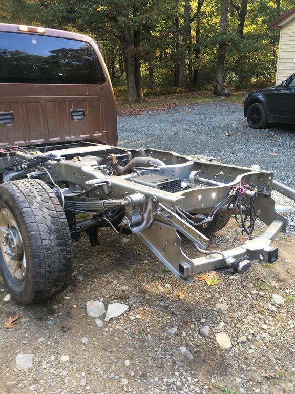

Jrain 276 #27 Posted October 20, 2021 (edited) On 10/14/2021 at 11:36 PM, oliver2-44 said: @Jrain Id appreciate if you would keep this thread updated with your test and final mixture. That Paints made about 4 hours from me. I haven’t heard of it before but have been looking for a good paint with hardener that’s a step up from Rustoleum. While I spray most of my stuff with a gun. Do you know if they offer it in rattle canna. Sometimes it’s nice to have a rattle can for small parts. I do not think they offer there paint in a rattle can , there is a Military resto company that sells GCI military paint codes (colors) and they offer it in a rattle can but they do the process themselves , that is the only source of GCI coatings in a rattle can that I know of , I will update you when I get to use the IH red they offer , I just finish a frame for a friends ford F350 in a GCI Grey color that I mixed to have less luster to match a new aluminum flat bed that I set on the frame today , and I will be shooting a mason dump body for another friends Chevy K30 in a few days also . here is a few pictures of the frame , the backhoe in the back round I shot in GCI safety yellow 11 years ago. I top coat all my frames in GCI Edited October 20, 2021 by Jrain 1 Share this post Link to post Share on other sites

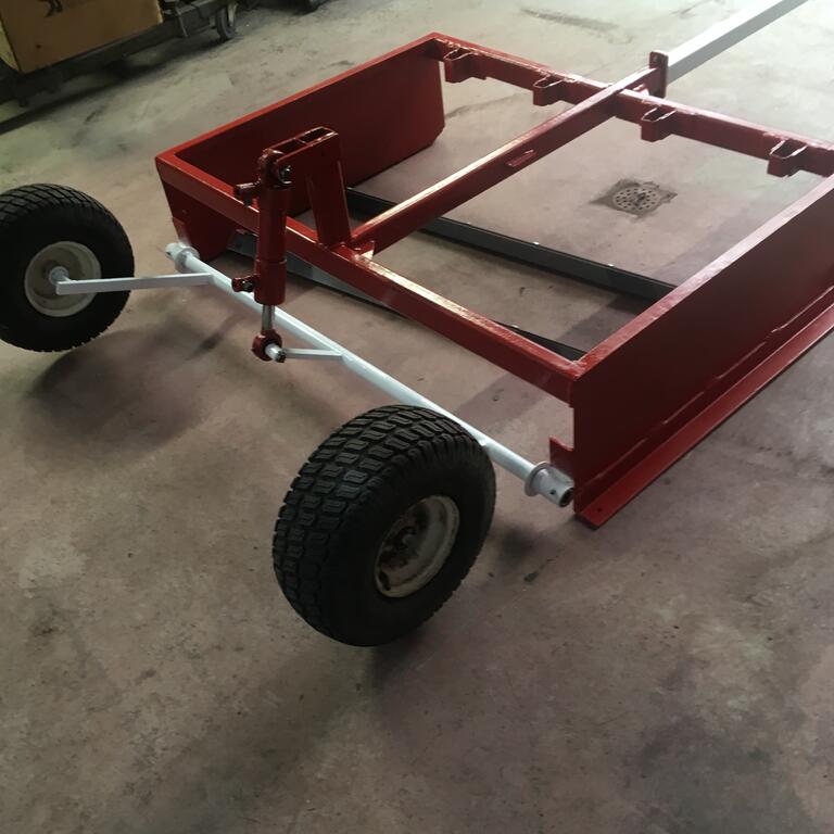

Jrain 276 #28 Posted October 20, 2021 (edited) 1 hour ago, AMC RULES said: Doubting you'll be disappointed. But I was disappointed I just finished building a pull behind implement for My wheel horse last week and rattle canned it with that paint and that is what bought me here to this section to inquire about color . Edited October 20, 2021 by Jrain Share this post Link to post Share on other sites
