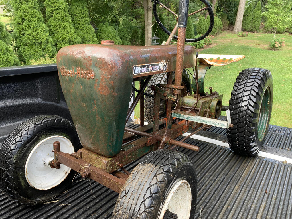

engineguy63 238 #1 Posted October 13, 2021 Hey Guys, A fellow collector was looking at my very tired out RJ, and mentioned he believed these tires were the originals that came with my tractor, there pretty cracked, but, holding 20 psi for a few hours now ....so well see. would you folks agree these are originals........if so, will put tubes under them if I have to in order to save them. Share this post Link to post Share on other sites
engineguy63 238 #2 Posted October 13, 2021 Thinking flat CREME, or flat BLACK, for rims and seat...........the rest will stay as is . ( at least thats the current thought !) 1 1 Share this post Link to post Share on other sites
stevasaurus 23,249 #3 Posted October 13, 2021 I think not original...sorry. They look nice on the RJ though. I think this is original... These may not be original, but I believe this is what they would look like. Share this post Link to post Share on other sites

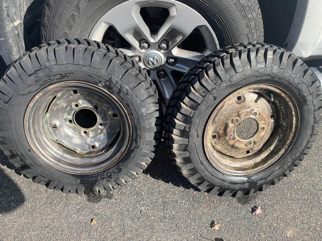

Gregor 4,847 #4 Posted October 13, 2021 Took this pic at the Atkinson IL. show in Sept. Would these be original on an RJ? 1 Share this post Link to post Share on other sites
slim67 2,808 #5 Posted October 13, 2021 22 minutes ago, Gregor said: Took this pic at the Atkinson IL. show in Sept. Would these be original on an RJ? Those look like a pattern I’ve seen on walk behind tractors. I had a nice pair but they were 5-12s. Share this post Link to post Share on other sites
squonk 43,536 #6 Posted October 13, 2021 Original would be 6-12 AG'S or Diamond Pattern turfs. 1 1 Share this post Link to post Share on other sites
pfrederi 18,586 #7 Posted October 13, 2021 Those look like ground drive tires for hay rakes unpowered Sickle bars etc. If you still have them i would like to get them for my New Idea hay rake... Share this post Link to post Share on other sites
953 nut 59,459 #8 Posted October 13, 2021 1 hour ago, squonk said: Original would be 6-12 AG'S or Diamond Pattern turfs. Your front tires do look like they are correct for '58. Those tired old turfs are probably from '64 or later. After the Diamond turfs stopped being used they went to the "Suburban" tire, Share this post Link to post Share on other sites
