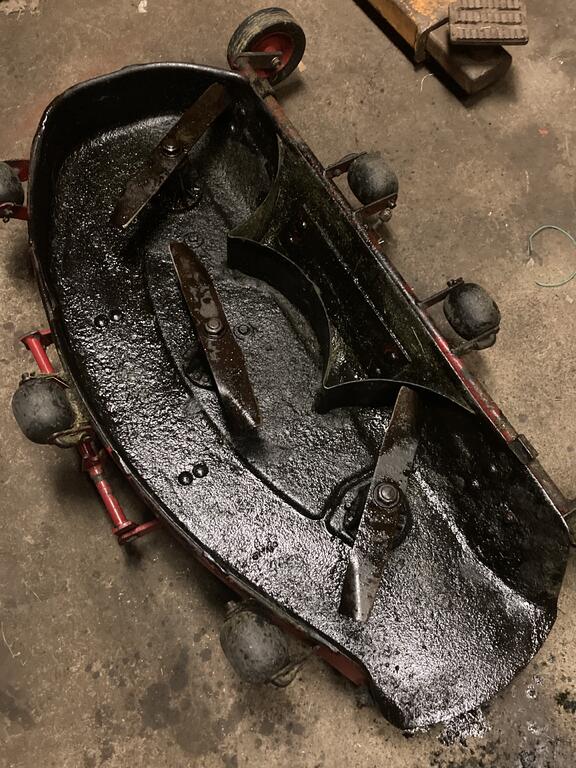

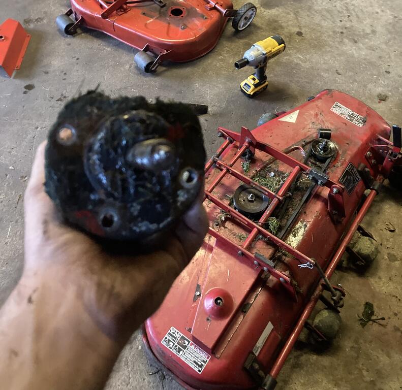

Ifixoldjunk 739 #1 Posted October 12, 2021 So, as some of you may know, I finally got around to replacing my rusted, welded mess of a mower deck on my 310. If you look closely at the spindle nearest the shoot, you’ll see it has a chunk missing. And that chunk just so happens to be where one of the four bolts should be. Would it be possible to rob a spindle off my old 42 rear discharge? They seem to have the same dimensions. Share this post Link to post Share on other sites
Ifixoldjunk 739 #2 Posted October 12, 2021 (edited) Also how would y’all go about getting the stuck spindle pulleys off? I’d like to save as many parts as possible as my budget wouldn’t allow for many replacement parts. Also, would any of you recommend even using this deck in its current state? I don’t really think the spindle will come flying off unless I hit anything. Besides many new mowers only have 3 bolts to begin with. Edited October 12, 2021 by Ifixoldjunk Share this post Link to post Share on other sites
Stepney 2,254 #3 Posted October 12, 2021 Long as it lines up you'll be fine. WH was very universal. For what it's worth, I've been running a similar bad spindle on a 48SD for many years. I placed the broken hole opposite of the direction the belt pulls. It's never bothered it. 4 Share this post Link to post Share on other sites
Handy Don 5,606 #4 Posted October 12, 2021 If it were my deck, I'd be happy to have a spindle "in the bin" that fits and works. I'd have it in there ASAP and then enjoy a nice cup of coffee as a reward. 1 Share this post Link to post Share on other sites
76c12091520h 2,467 #5 Posted October 12, 2021 Spindle housings will share the same bolt pattern and can be swapped from one deck to another; the pulleys may or may not not interchange depending on what vintage your decks are. 2 Share this post Link to post Share on other sites
daveoman1966 2,959 #6 Posted October 12, 2021 Remove the pulley. With pulley off, remove the four (3) mounting bolts and turn the 'chunk' so that it is on the side toward the chute. Bolt it back on in that position and reinstall the pulley. This is the best way to maintain stability of the spindle under belt tension. It should last for years and years...and years. You could, of course, swap out the spindle from another 42 (or 48") deck, but the pulleys may or may not interchange....depending on vintage. 3 Share this post Link to post Share on other sites
Ifixoldjunk 739 #9 Posted October 12, 2021 @71_Bronco @Handy Don Thank y’all for your help. I ended up following your advice and pulled the spindle off the parts deck. After getting them swapped, I sat back and enjoyed some coffee too.😅 1 Share this post Link to post Share on other sites
Ifixoldjunk 739 #10 Posted October 13, 2021 So I swapped over the spindles tonight, as it turns out the bearings were shot too, so swapping them was a necessity. It has a pretty nasty chunk missing off it. 1 Share this post Link to post Share on other sites
