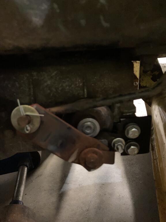

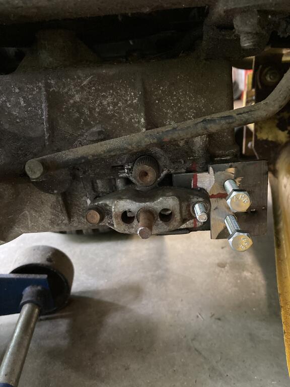

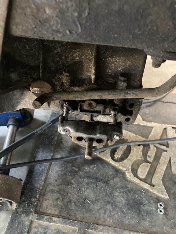

TonyToro 1,137 #1 Posted October 11, 2021 Ok…I know John Deere 🤮 but it came available and it fits through my sister-in-law’s gate so my son can mow the yard. The tractor turned into needing WAY more than the owner said. After getting into it I bought ANOTHER 111 as a parts machine. That one is a hydro. So between the two we have a nice presentable tractor but…. It doesn’t stop. The previous owner snapped the bolts off the “caliper” I tried to weld to the bolts but they just kept breaking little more off until now they are flush with the case. I was able to drill and tap one side but the other now has a broken 1/8” drill bit in the bolt. I see 2 threaded holes on the right side I may make a “T” bracket to hold the right of the caliper and thread a bolt into the factor left bolt hole. Does anyone have suggestions or tricks to fix this? Share this post Link to post Share on other sites

oliver2-44 11,198 #4 Posted October 11, 2021 I think your "T" bracket idea is a good work around. I had a 1984 116, before I had ever heard of a Wheelhorse. My sons grew up on it. I'm vaguely remember that caliper setup. I sort of recall mine having studs with nuts for those two little bolts. Now Sqonk they were lawn mowers not garden tractors. Mine mowed 1-1/2 acres for 25 years and 3 sons mowed a few neighbors yard as well. But I will say when I retired it, it was totally wore out. Sold it at a garage Sale to someone that had to have a green Deere. 1 Share this post Link to post Share on other sites

TonyToro 1,137 #8 Posted October 11, 2021 4 hours ago, WHX?? said: Welcome to my world Tony.... more often than not had to buy two horses to get one! Since I am not familiar with these tractors pics would help. Isn't that always the way. Owner said it ran 2 years ago. Lol the rust in the carburetor touched the float! Lol here is the brake caliper. I thought after ever attempt I could weld on studs but I think the bolts that held the caliper on were stainless?? The studs just snapped off when I tightened. Share this post Link to post Share on other sites

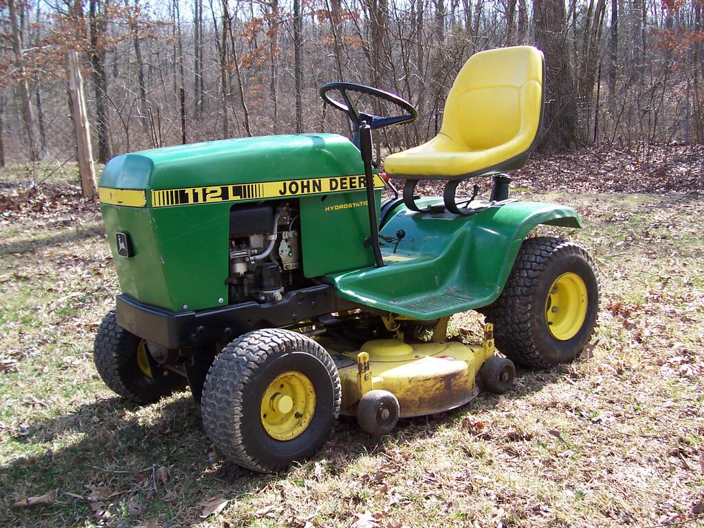

T-Mo-(Moderator) 4,742 #12 Posted October 12, 2021 The 111 was part of the lawn tractor series that was made from 1979 to 1985. The series included the 108, 111, 111H, 112L, 116 and the 116H. The series was one of the best in the market in that era. I had two 111s, a 108 and a 112L, all could out mow most garden tractors. They were nimble, quick, and easy to work on. Frames were heavy duty. The 108 and 111 came out on 1979 with mechanical PTO and had the fuel tank under the hood. 1980, JD replaced the mechanical PTO with an electric one. 1982, Deere introduced the 111H and the 116 and 116H tractors (the H was for hydrostatic). Also in 1982, Deere move the fuel tank to the rear, underneath the fender deck. In 1985, JD replaced the 111H with the 112L, which was basically a 111H, but with a 12.5 hp Kawasaki engine. The gear drive models used a Peerless, 5 speed transmission, while the hydrostatic models used an Eaton transmission. The engines, other than the 112L, were Briggs engines. The 116 and 116H used a horizontally opposed twin cylinder Briggs, the rest were single cylinder engines. The model numbers represented the hp, i.e. 108 had a 8 hp, the 111 had a 11 hp, etc. Below is my 112L that I had. I miss that tractor. 1 Share this post Link to post Share on other sites

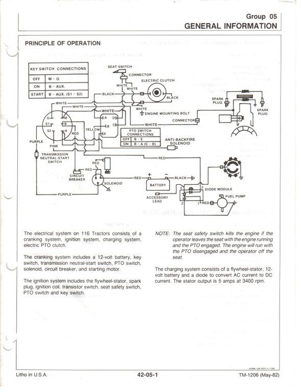

TonyToro 1,137 #13 Posted October 14, 2021 I ended up making the “T” bracket. I have to paint it tomorrow and get the correct size bolts but it appears to be the right fix for this. The more I mess with this tractor the more I’m liking it. Tomorrow I have to figure out why the blades shut down the engine when they are engaged. I’m thinking a safety issue? Share this post Link to post Share on other sites
TonyToro 1,137 #14 Posted October 14, 2021 On 10/12/2021 at 5:19 AM, T-Mo said: Below is my 112L that I had. I miss that tractor. I have one if you want a project! 😂 Share this post Link to post Share on other sites

TonyToro 1,137 #16 Posted October 16, 2021 Success! We have brakes. now today search and find out why the PTO shuts off the engine. Share this post Link to post Share on other sites
T-Mo-(Moderator) 4,742 #17 Posted October 17, 2021 Electric PTO? As I mentioned above, the first year of the 108 and 111, they had mechanical PTO. Then in 1980 until the last one produced in 1985, electric pto. Here is the wiring for a 116, which had the electric pto...a 111 should be similar. 1 Share this post Link to post Share on other sites
TonyToro 1,137 #18 Posted October 17, 2021 46 minutes ago, T-Mo said: Electric PTO? As I mentioned above, the first year of the 108 and 111, they had mechanical PTO. Then in 1980 until the last one produced in 1985, electric pto. Here is the wiring for a 116, which had the electric pto...a 111 should be similar. Thank you! I got it! it run mows and stops now. The previous owner cut the seat switch wire under the dash. I guess when I jumped the switch it made a circuit. I pulled the jumper out and everything works as it should. Share this post Link to post Share on other sites
