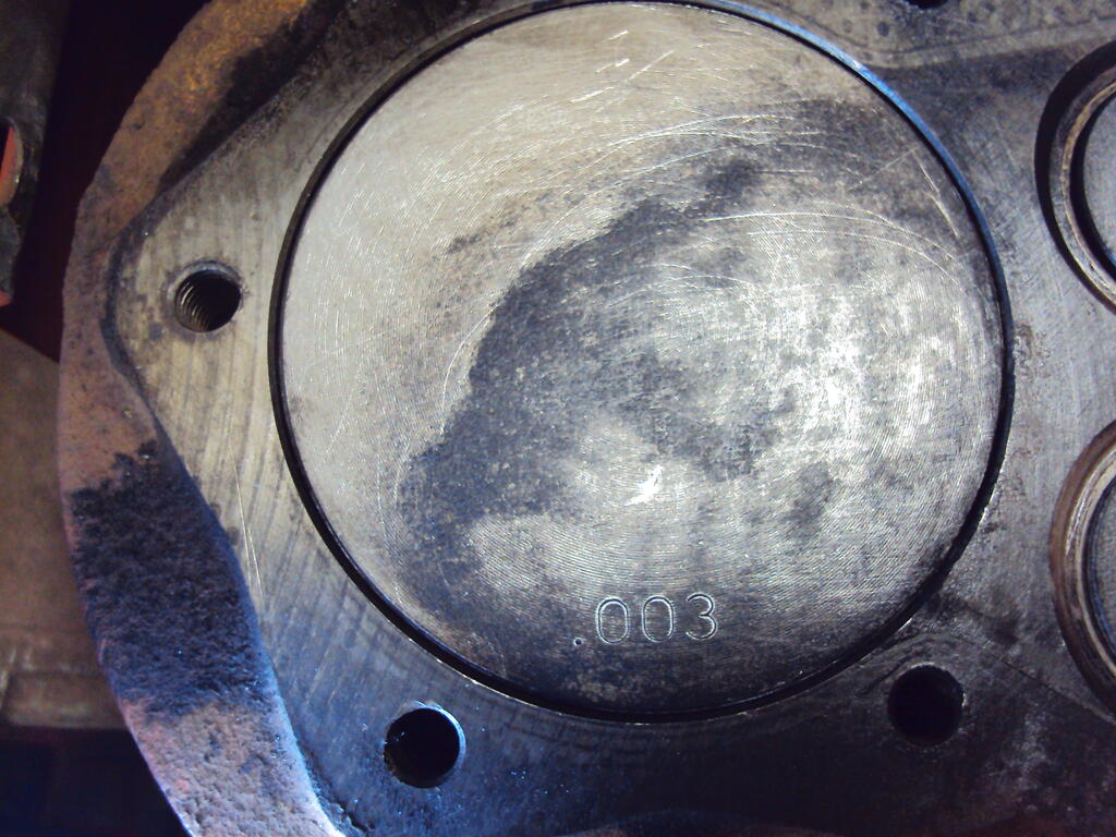

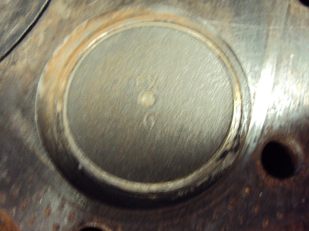

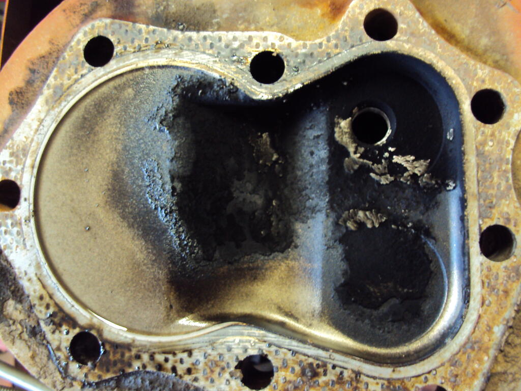

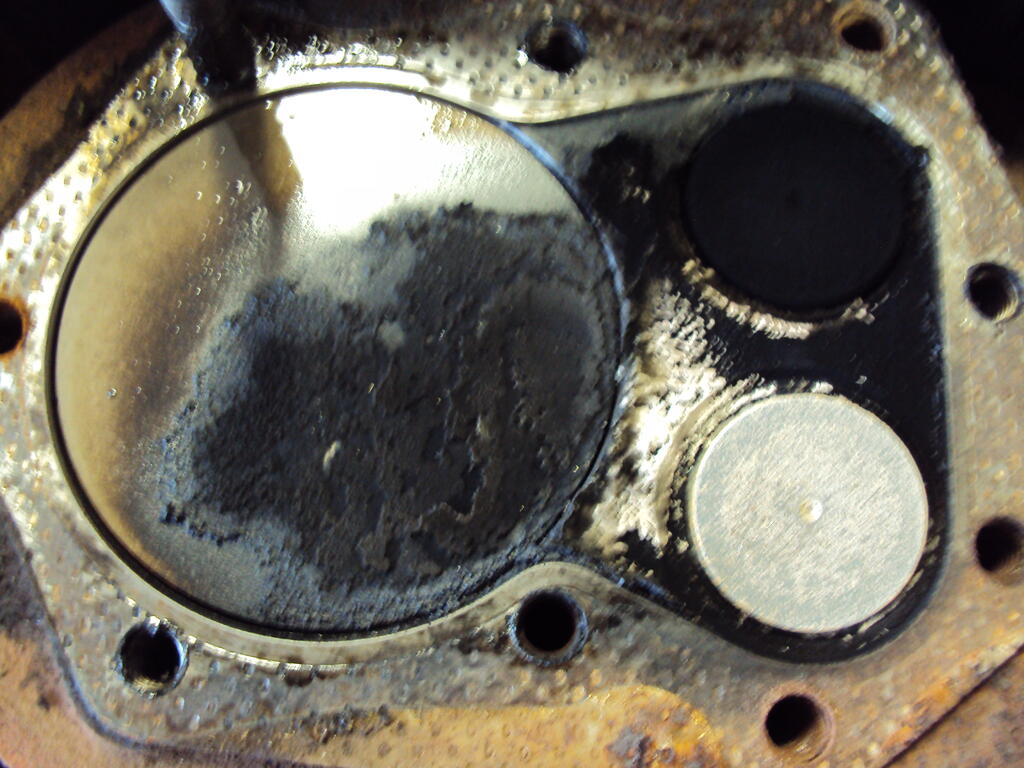

1979 C-101 1 #21 Posted October 10, 2021 9 hours ago, 953 nut said: Snoopy11, That video is exactly whit my engine is doing. Oliver-244, I did not think to look at the valve stems. 953 nut, one of the replies to "leak down tester" suggested to charge the cylinder with air while both valves are closed and listen for air in the carb and muffler. I did that and could not hear or feel any air. I pulled the head and there is plenty of carbon but the valves look like they are seating. Also, there was oil on top of the piston, it has been using oil lately. Tomorrow I will try Snoopy's poor man's vale job. I'll see if I can post some pictures as well. Thanks again to everyone! 1 Share this post Link to post Share on other sites

1979 C-101 1 #23 Posted October 11, 2021 (edited) Here are some pictures. I guess my pictures are to big so I could only upload four pictures. The last picture is of the exhaust, the intake has IN S and appears to be the same size as the exhaust. I did Snoopy11's test and after two hours the exhaust leaked very little but the intake leaked down completely within a minute. Snoopy11, what do you mean in your last message "valve stems"? I can tell you that through the outlet of the block the exhaust valve stem is not shiny or rusty, kind of grey in color. The intake valve stem is shiny in some places and has rust in other places. I got this engine at a junkyard to use while my original K241 engine was being rebuilt. This engine had been out in the weather for who knows how long with no muffler or carb. The exhaust valve was going up and down but the intake was stuck in the open position. The rust was on it at that time, I freed it up and it ran fine. That was six or more years ago and it ran so good I put the K241 on just to make sure it was good and decided to save it and put the K321back on with no problems until now. It does not look like the engine has ever been apart as the oil pan gasket has the original paint on it but the piston is stamped .003. Looks like I need a total rebuild, thoughts ? Edited October 11, 2021 by 1979 C-101 Share this post Link to post Share on other sites
Snoopy11 5,731 #24 Posted October 11, 2021 6 minutes ago, 1979 C-101 said: "valve stems" You want to make sure the stems are not burnt/carbon buildup, causing difficulty of valve movement... also want to check the seat face... Now, if you are short on cash at the moment, and aren't seeing any damage to the valvetrain (i.e. holes in valves, pitting...etc...)... you 'could' take the head, soak it in chem-dip... along with your valves, using scotch pads to further clean everything off. You might get away with one on this engine if you aren't seeing damage. Regardless... definitely need to soak that head... get it all cleaned up... Don Share this post Link to post Share on other sites
